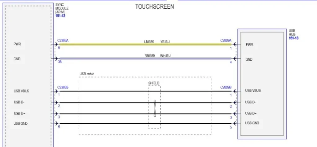

C2909A - APIM to USB HUB - The APIM provides the Power & Ground for the HUB, so by your issues - this tells me that the RH Port has a more direct feed back to the APIM and the LH Port is a (Rider) of the RH Port.
Have you ever used a - Powered Hub for your computer, plugged into a wall outlet and then connected multiple USB Devices to it - That's what the Power & Ground Provides, a way to power 2 each port's and provide (Illuminated Ports)
There is not enough power (In the hub) to power 2ea connections and the (Illumination for the Ports)
You have a (Single) USB Cable - feeding the HUB from the APIM, that USB cable provides a separate charge and data transfer - the same as any modern USB cable, just like when you physically connect the phone to a computer or the truck.
As far as the (HUB) Ford has various HUB's available that offer varied (Ports) with the newest technology of USB-C they have (on the market) duel port USB (one with the same USB port you have and then a (USB-C).
The challange is locating the (exact part number) that will phyicially fit into the panel without modifications and also (wire match) the C2909A Connector.
Try the search function - as I recall another member swapping the HUB with one that included the new standard (USB-C)
or just replace it with the OEM Hub you have installed.
The only way to verify it's the Hub is to perform a wiring check for voltage.
Its most likely the HUB
