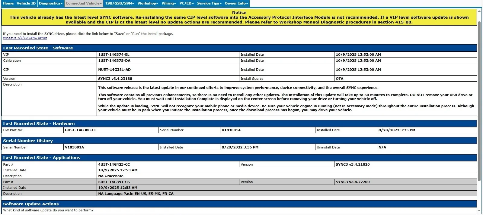

I managed to get mine working - Combo of (Renaming) the USB something other than (Iphone-Ipod) as my (In Use) Iphone is connected via Bluetooth. Don't know if it really mattered. But I changed it.
and my BLUNDER of not (Quick Press) of the Voice Button.
I guess I need to use it now that I know how :clap: - IDK I like (Old School) operations sometimes (simple)
As fat as your specific issue.
I discovered that even though I have my (Auto-Updates) De-Selected
Ford - Still (Pushed) Through a (Sync-Update) in October
I assume its related to the (Recall) to update the Sync to 23188.
Note: I was already on (23188) and have been for some time, so I am thinking that this (Recall) is some background (Software) behind the scenes of the 23188 version.
My POINT is - How long ago did this issue begin? - (USB Issue)
It may possibly be an (Issue with that pushed (OTA) Update and its only software related.
Via FDRS - Status Run
If your issues started in October - It may be this forced update that caused it.
Note: They bypassed my (Auto-Update) being selected off and it was up to date (vs23188)
So, I do not know if this was a (Check) and it updated their system to show its current or they actually installed an update and overwrote the 23188.
Fords site (showed) it at 23188 - The one we use for the (Update Downloads) Version but this document shows that it was at Factory Version as it left the assembly line and needed updated.

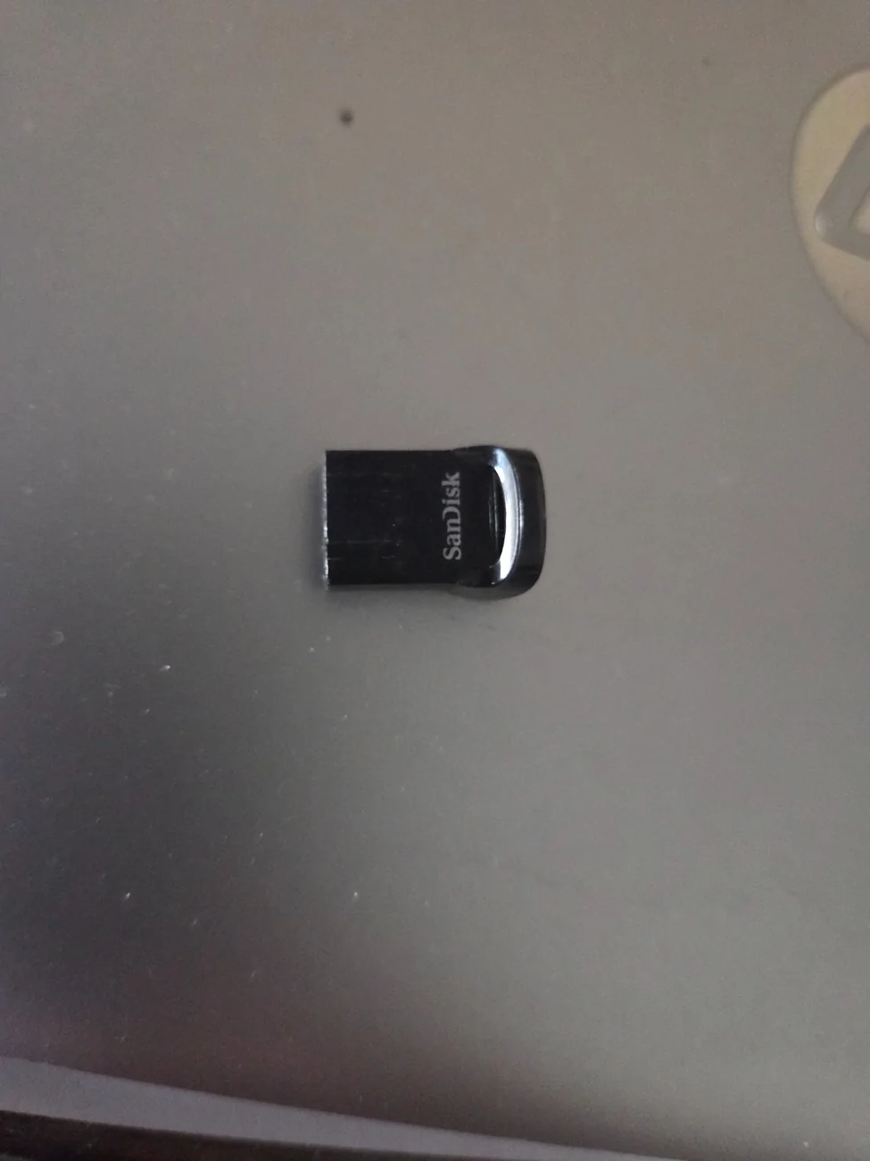

I had a different device in for 2 days. No problem. So then I put my original back in. it acted up after 15 min. So I put another in this morning. So far so good. I am starting to think it might be the thumb drive going bad. We'll see. Wanted to add it takes an overnight reset to get it to pick up again. So we'll see if the drive was the problem hoping it is as that would be the easiest fix.
