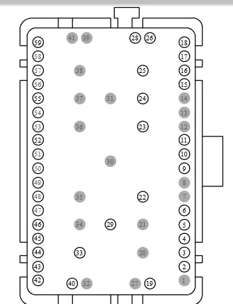

Ok, I dug and found that Fuse #29 is feeding both of those USB Ports on the rear of the console.
The wire diagrams are misleading and lead you to believe that there are (2) separate ports
However, this is ONLY TRUE IF you have (1) Power Point that is the same as the front ones. That is not the case.
You have a single power source (Fuse #29) feeding both of the rear USB charge ports.
The harness run 14A005 splits into 3 ways of routing - down the floor (sides) and down the center floor console.
So, I cannot be sure of how that specific power wire is being fed, not clear enough of a diagram.
So, with the engine running, check for power across Fuse #29 with a meter or test light.
The fuse is (After) the relay, if no power here, then the relay is not closing.
You can try a (BCM-Self Test) Reset or Disconnect the Battery for 5-Minutes.
Plus - also ensure the fuse is good - check with a meter - don't assume it's good juts by a visual this can and will (MISLEAD) as visually its looks good (BUT) it's actually bad.
If you have power across the fuse, then there is (1) connector that would have been disconnected for the HVAC work. (Up-Front) and then all the connectors at the Rear of the console.
And that is C1147
This is a 59-Cavity connector - located by the Brake Pedal - it is the biggest connector (In-View)
Either Pull & Reseat it or Pull and Check for Power at Pin #40.
If you have power here, then the issue is between here and the rear console, if a pull and reseat does not fix the issue.
The harness runs - no other connectors (for this power) down the left side of the floor and then over to the rear console. (I Think) it's hard to tell for sure but it may run down the middle of the console.
So, you would need to also check for power on the connector going to the USB Ports
It's only 2 wires - C3522
Grey/Red = Power
Black/Blue = Ground
Check for power across both pins and then check for power from the (+) to body ground.
If you only get power when (+) to body ground, then the ground wire is broken as it routes to a shared multi-ground point so if that was left disconnected, you would have lost more systems.
Since you only stated, the connections were good - Did you Pull & Reset the Connector? at the rear console.
C1147 Female Side - Pin #40 = USB Power from Fuse #29 (Most Forward) Connector runs to the Fuse Box. Located right beside the Brake Pedal (If I recall) correctly.
And that is C1147
Grey/Red = Power
Black/Blue = Ground
