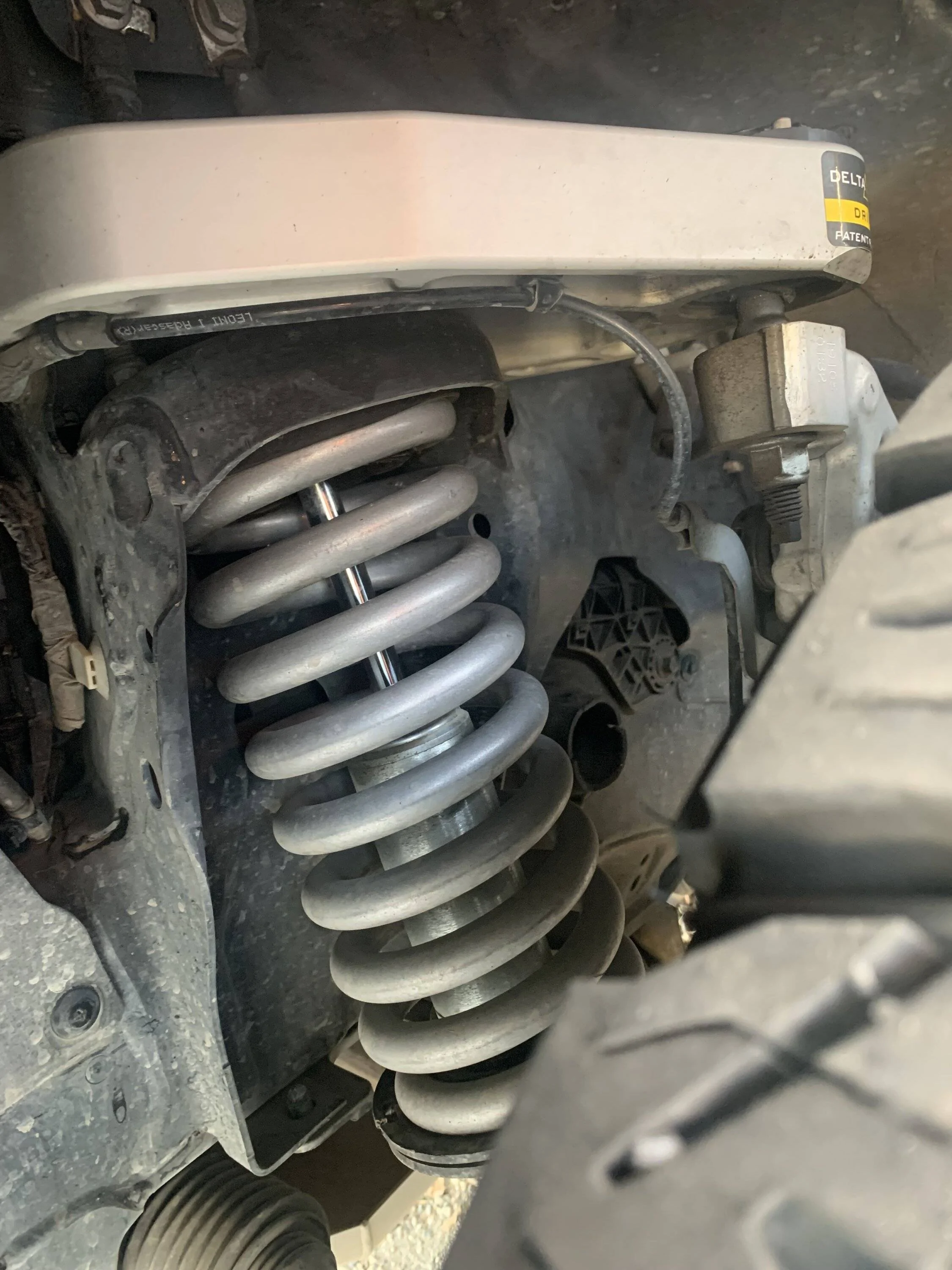

I had the same issue was able to get my stock struts out and springs off, but could not get the new springs on. They were too big. I ran Bilstein 5100 with Eibach springs
The Eibach springs were too big to compress had to take them to a shop to be put on a press. It was $40 for the pair (so-CAL prices there’s literally 10 shops within 5 miles that can do it) over all the jobs not too hard just make sure you take out the axle nut when you pull out the coil over. Not sure if you wanna pull off the coil over yourself, but it will save you a lot of money.
