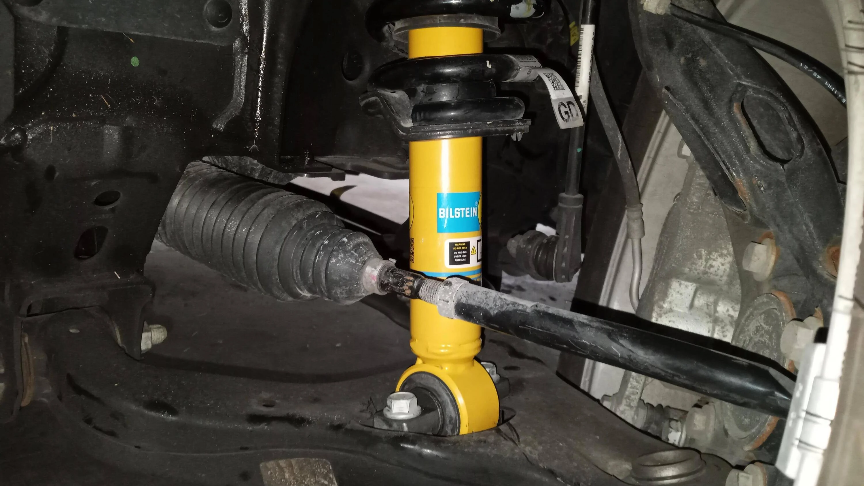

As posted in the what did you do to your soda can on wheels today thread;
Well I'm not going going to bore you with the run around BS so yeah, the only place that would do it for me was the dealership in which I ordered the truck through.
I have not had the chance to really drive the truck yet, but when making turns I did feel less like I was driving on stilts(less body roll).

So yeah, truck handles the junk roads around here better now. Still pretty rough driving around but the 4600's keep the tires planted so no bouncing around or losing control. My back don't take the brunt of the potholes like it usually does.
Worth the total cost of $1,100? Not really, but I don't regret the upgrades.
