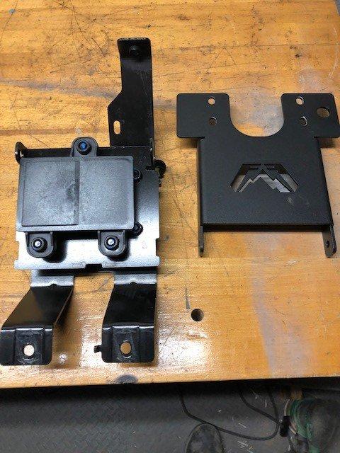

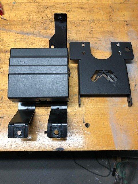

I mentioned that I installed this in my build thread. However, I had my cowl off today and grabbed a pic for anyone who is needing to relocate their ACC. I was after something cheaper than the ADD bracket and when shopping for new bumpers, I noticed this on their description:
NOTES:
** Relocation bracket is required for adaptive cruise control for 2019 Ranger (M5350-1).
As such, I searched ā€œFab Fours M5350-1ā€ and found the bracket available from a few places. Itā€™s $99 and swivels so that you can adjust the angle of the sensor. Iā€™m very happy with the product. I will say this, you DO have to drill four holes into the support beam to use this. It comes with self-tapping screws for installation. Let me know if you have any questions.

$99 for a bracket so specific doesnā€™t seem bad at all, and it almost looks like it should be there.

Have you re-calibrated the sensor and/or have you noticed any difference in functionality with it?
I would expect it'd just be a bit quicker to see cars merging in on the left, slower to notice cars from the right, but as long as it can still see which car ahead is in your lane and not trigger on the lane to the left it'd work ok.
Nope, no calibration on mine. I have noticed a very minute preference to left-side vehicles but it's minor. It did throw a couple of errors right after install saying the sensor was blocked but I didn't touch anything and those errors went away and it functions great now. I assume there is some self-learning involved there but I can't be sure.

Good. Nice to know for those of us with adaptive cruise and considering bumper replacements.
