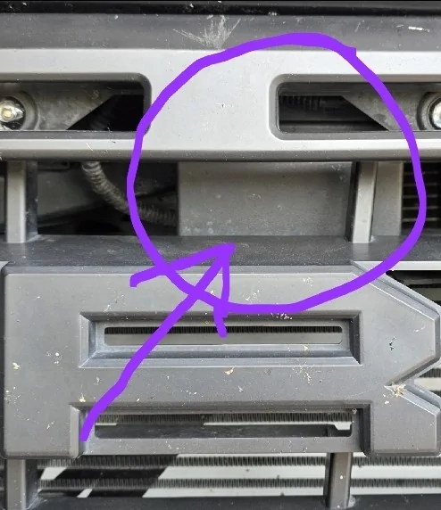

In the end I ditched the Raptor grille for something with a more even patterning. It helped immensely. You can see the ACC module dead center there. It still doesn't love corners, but I *think* it's getting better. I dunno. I'm told there's a menu item in Forscan to manually trigger recalibration. I haven't fired up Forscan yet but will soon. What I can say is, it was unusable with the Raptor grille, and removing the metal screws that held on the letters FORD didn't make a difference. That's all I can say with certainty. Believe me, I didn't want to replace my awesome $265 grille I liked with a $200 jobber I like less. If I could have made it work, I would have. Maybe if you could position it below the "R" in FORD, that would fix it. There is a way to do that but I lack the fabrication tools & space. Buying the below grille was cheaper/faster. c'est la vie.

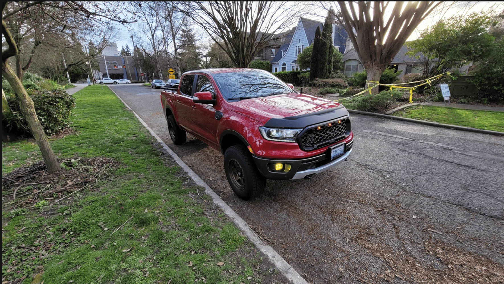

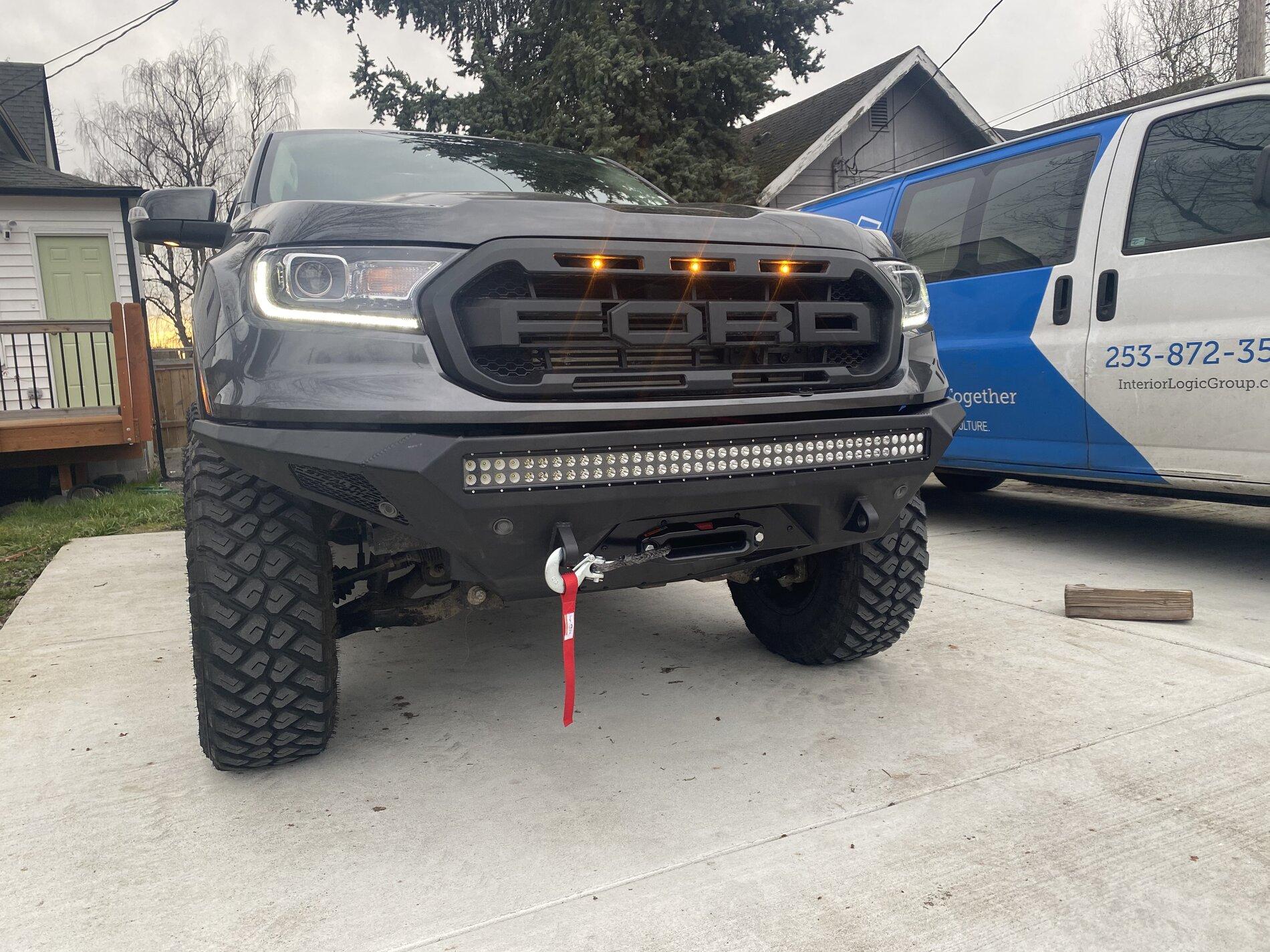

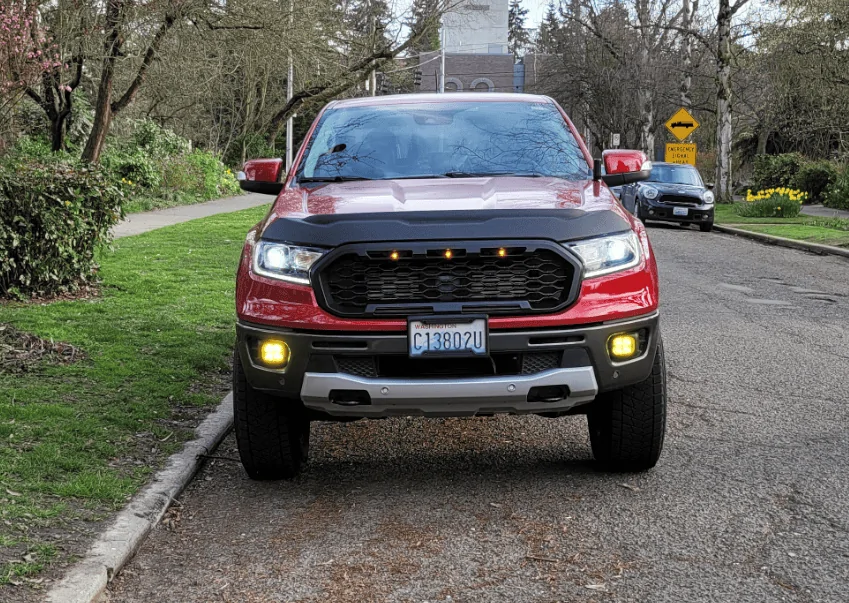

I realize this threat is ancient, but I wanted to share my solution anyway, just in case someone is still trying to make this work. My Ranger has the Raptor-style grille with the four LEDs, and after the hidden winch-mount installation and the subsequent ACC sensor relocation upwards using the FabFour bracket I ran into pretty much the same issues as described by many others, receiving "sensor blocked" faults at random intervals. After reviewing everybody's experiences and workarounds I had a hunch it wasn't the grille or the screws holding the letters that were causing this issue but the LEDs. I moved the FabFour bracket as far towards the center line of the vehicle as the hood latch assembly would allow, trimmed a little plastic from the tray below the bottom of where the sensor would sit, drilled some new holes to mount the bracket and was able to position the sensor between two LEDs. I was able to install the sensor with the protective cover in the front of it (required minor trimming off the cover part, plus two zip ties for extra stability.) This might not be necessary, but if the extra protection from rain, snow / ice build-up and road dirt makes the sensor live longer, then I'll take it. After all, there's a reason every vehicle has a cover protecting this sensor, even when it sits high up, as it does OEM in 4Runners). That sensor cannot be cheap to replace! I must have done an adequate job separating enough wiring from the original harness; I had enough length of wiring to reach this new, slightly farther out location without a problem and without having to resort to building a DIY wiring adapter. Just be sure to separate enough wiring at the beginning of your winch mount or off-road bumper project. After the first hundred miles I am happy to report that I have not gotten any faults yet, and shifting the sensor just a couple of inches towards center has also improved its accuracy compared to the prior relocation location. (Say that fast 5 times!).
