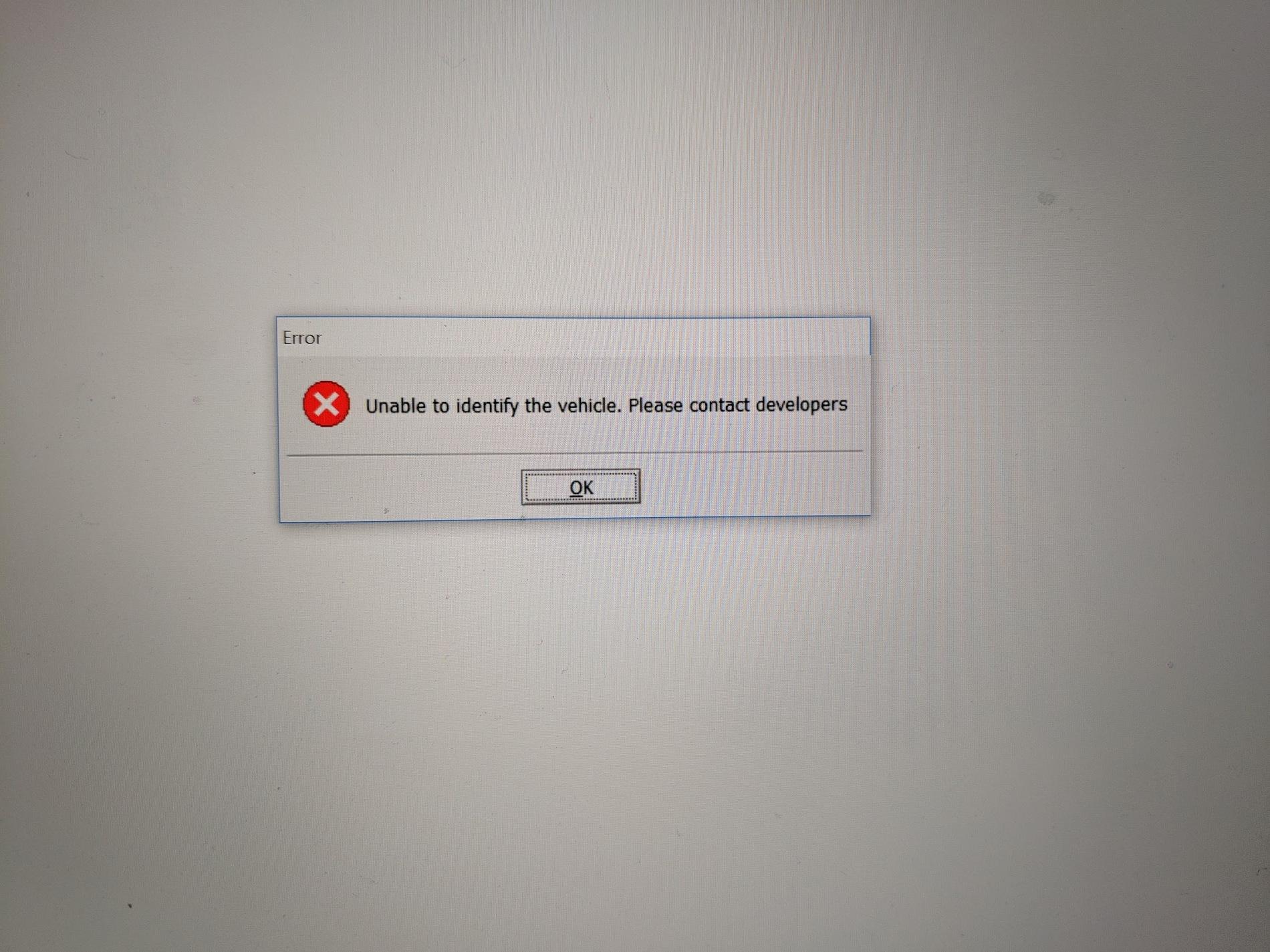

I was thinking the same. Just checked the forscan forums and it looks like some of the guys from here are having trouble even connecting to the truck, something about VIN not recognized...
That could be my post over there,thats the message I got on forscan and I havent had a chance to mess with it since.
Yep it was yours
