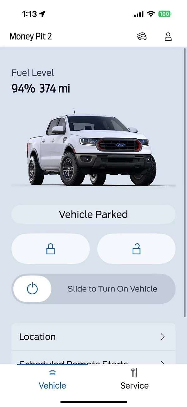

  • If you have an iPhone go to Settings>Apps>FordPass. Under Location, check that it is not set to Never.
  • Background app refresh and cellular data should both be set to On for best results.
Android phones should have similar settings
My iPhone has all the same settings you've noted, and also noted above in some other replies. It finally connected to my Ranger - maybe 30 minutes after I opened the app. But now that I was ready to post this, I looked at the app and there's a notice that services are "Temporarily Unavailable. We are having system problems."
