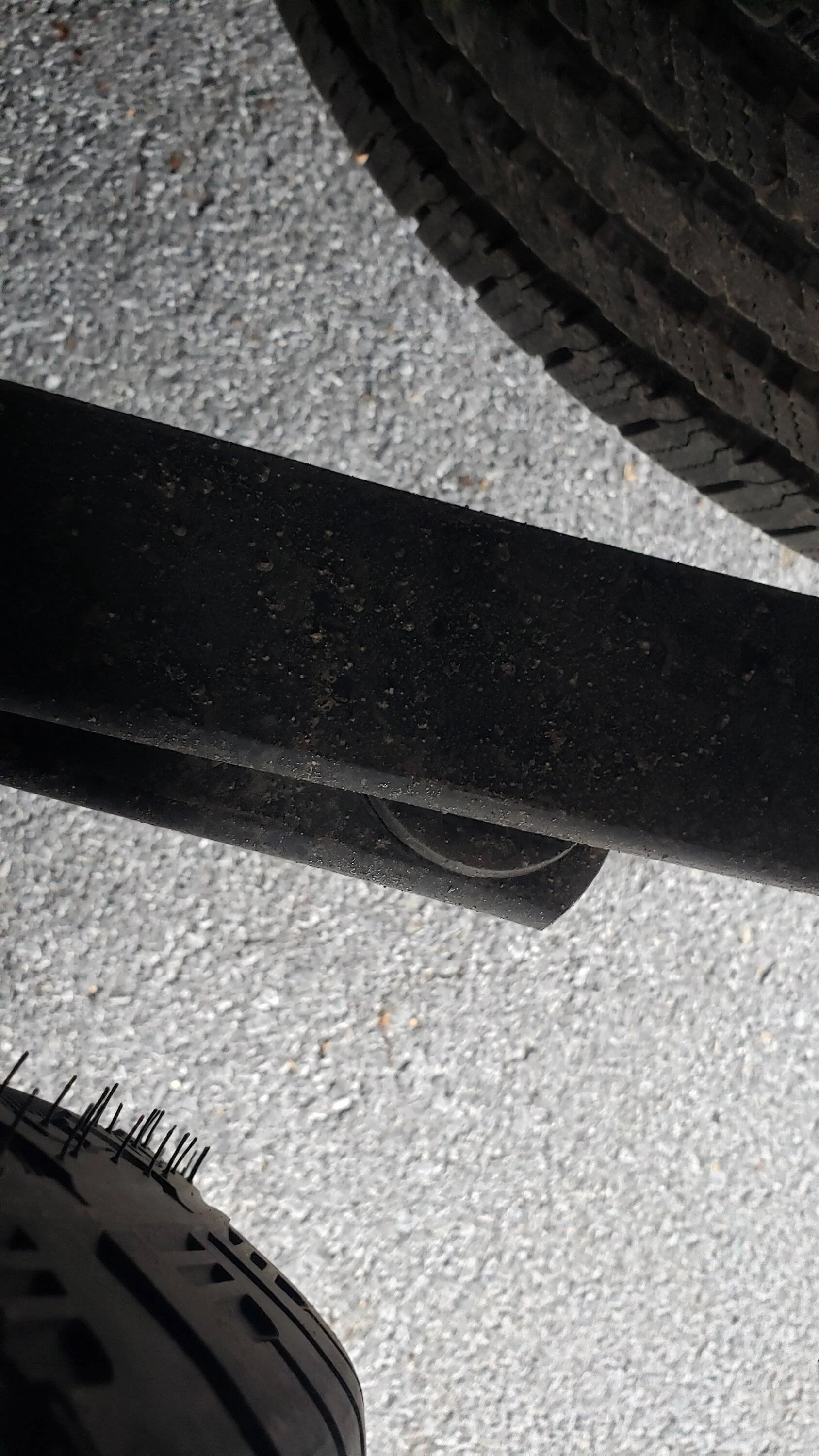

Well, i have always been trouble free here with my Ranger. I haveots of apologies to hand out with all that have had problems. My 2022 unfortunately is not my 2020.
My leaf springs on my driver side are not aligned together.
And today, for about 2 minutes. My truck was dead. No lights, buzzing, sllash screen nothing with splash screen ford app dead just dead. My phone charger worked though. Weird.
2020 38k miles not a single problem.
2022 not so much :(
Will this leaf give me problems. Already planning to take it off and make it straight

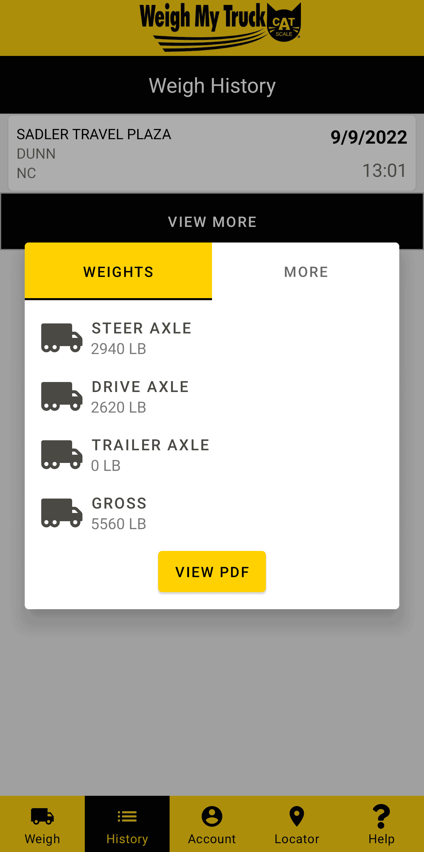

Weight of washer and dryer, tongue weight of trailer, weight of passengers + there in truck goods? And what is your max payload on your door edge sticker?

7500lb is the tow rating, that is not what I'm asking about. Payload is only ~1400lb with gross vehicle at only ~6000lb. If you don't know this, perhaps Ford is right to not warranty it.

Idiot is not what I said. But you still didn't give the total weight of what was in the truck plus the tongue weight of the trailer. Also, what the payload rating for your truck since that varies depending on options.

Will do took 6 months for my local dealer to even look at it. Will send an email probably won't hear back till after the holidays. But like I've said a few times in this post I have weight tickets unloaded and loaded and trailed by itself. For reimbursements purposes. All weights under the ratings. But Ford dealer telling me I just overloaded it another time which is just a scummy way to avoid warranty. Will check back when I get response from Ford directly. I'm sure some extreme conditions of the heat wave etc helped the issue.

Did you share the weight ticket here, I've didn't notice it while scanning through as I was catching up. The loaded with trailer would be ideal. Cat scale should have front and rear axles plus the trailer.
I've used scales on my way to pickup RVs when my wife and son came along as I knew that was going to put my payload really close to the limit and I needed to be sure of where I was. I have a weigh safe hitch so once the trailer was connected I just added that number (just under 600lb) to the scale weight. Had to move 100lb of our gear to the RV to keep the truck under the payload limit, moved 150lb to be safe.
Also, I'm not defending Ford. But when I asked for specific info, facts of the event in question, you failed to provide that and just mentioned the tow rating not the weights you were actually working with. Sounded like you were only considering tow limits, not payload.
