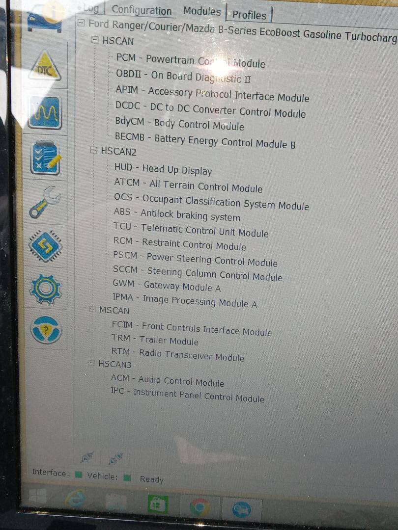

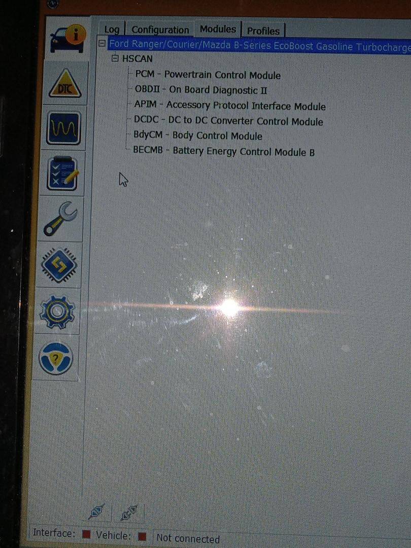

Do you see a FDIM - Front Display Interface Module?
I believe for the non-touch screen it is labeled as FDIM.
Here's what i have showing;
airline tech
Aug 24, 2022
4,497
8,589
Midwest - KS
Aircraft Tech
You need to try , loading a new profile, you are missing over half of the modules that are not loaded
seasprite
Sep 1, 2022
468
1,112
Missouri
2022 Ranger XL STX
I have 22 modules on my 22 xl that forscan can see. I don't even see your ABS module. Like Airline tech said, clear out your profile and try again. Hopefully you'll get some answers.

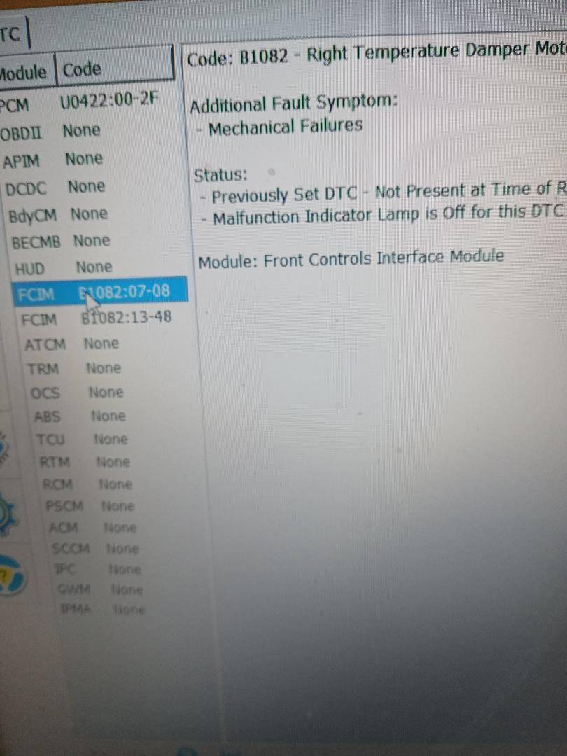

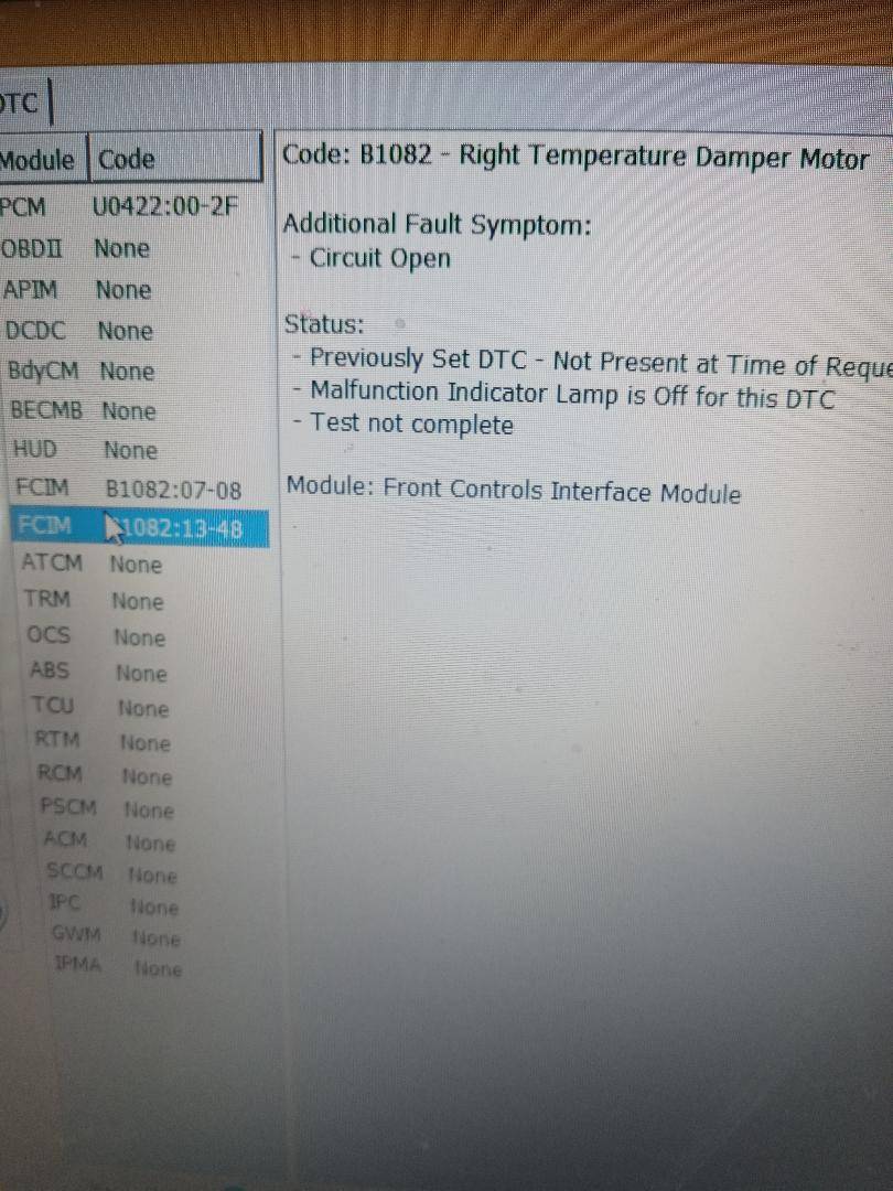

Ok so i reset and got all the modules to show, i have code B 1082 Right Temp Damper Motor &
B1082 Circuit open, so there should be no issue with the dealership not seeing them.
