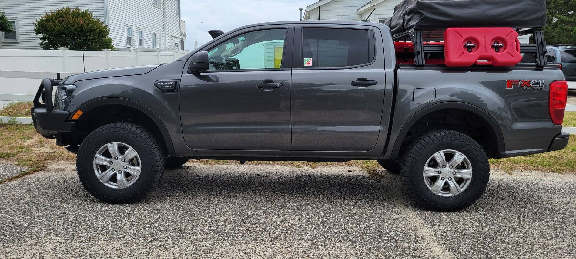

Just to echo the sentiment already voiced on here; the FX4 shocks SUCK! I've got the Eibach kit on my truck and I love it! (And an add-a0leaf kit as well.)
137,221
How did you air yours down, Is there a recommended method to do this?
I have this tire gauge and it also has a bleeder button on it. I've had it for a couple years now and it's worked out well. If you're going off road a lot and want something a little faster and more precise the Staun deflators are great but they're pricey. With these you can set your desired psi and just screw them on and they air down to it. Usually by the time you get to your last tire the first one it all ready to go.
There are a bunch of different variations of both of these which work just as good but IMHO the Staun deflators are one of the best out there. I also have this Viair potable air compressor.
