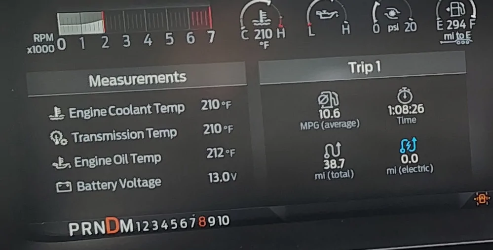

Little bit warmer (The F150 is warmer that is). I had the PPE Pan on the on the Ranger and they don't make one for the hybrid 10R80MHT.
Once I got the level right in the MHT I'm able to drive at whatever speed, but I did have it slightly overfilled and had a runaway event, but not to the point I blew fluid out.
This is a pretty typical towing temperature view. Everything is usually right around those numbers unless I'm really hauling. Even in the 108 deg heat we drove through last year things stayed pretty well in check.
