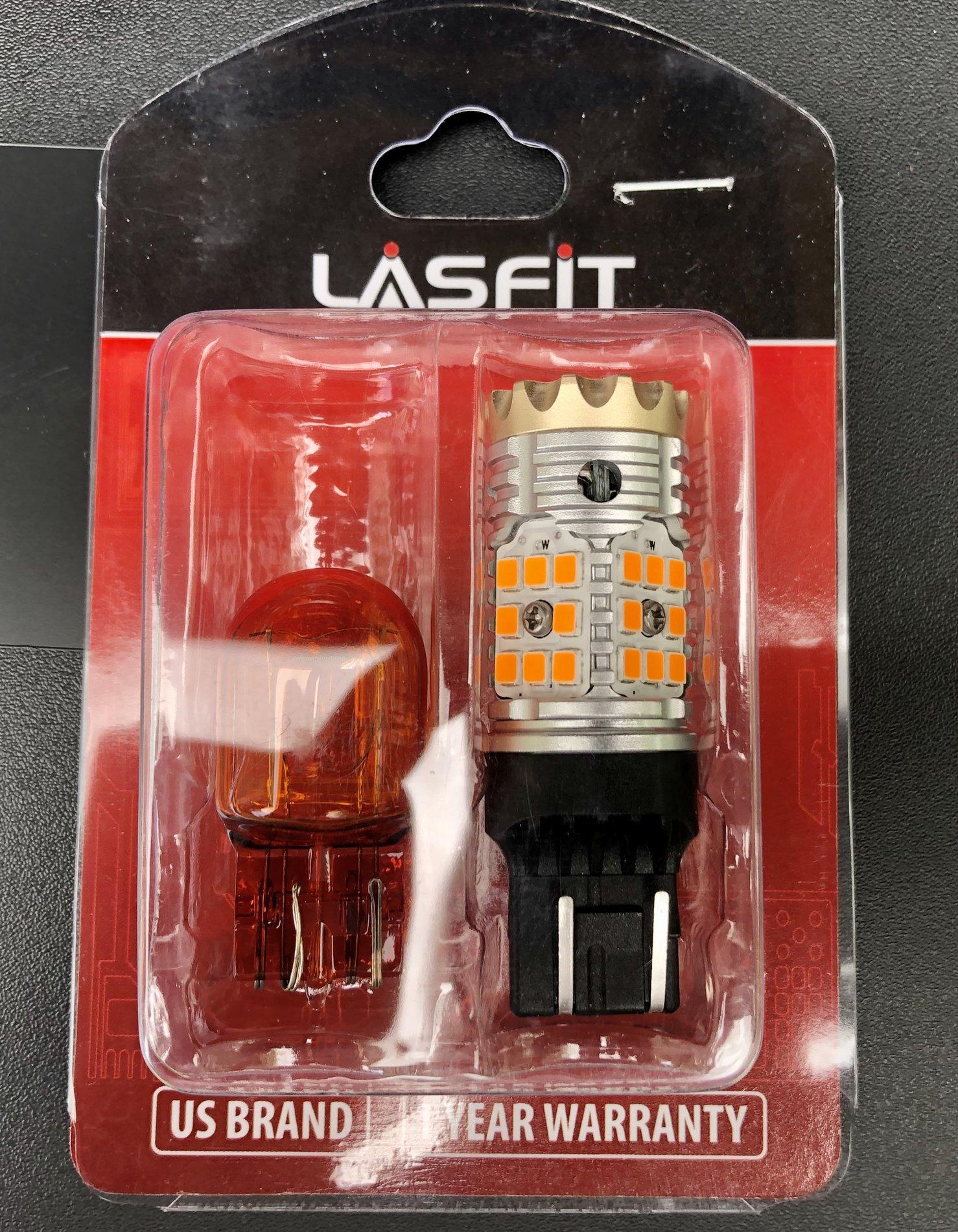

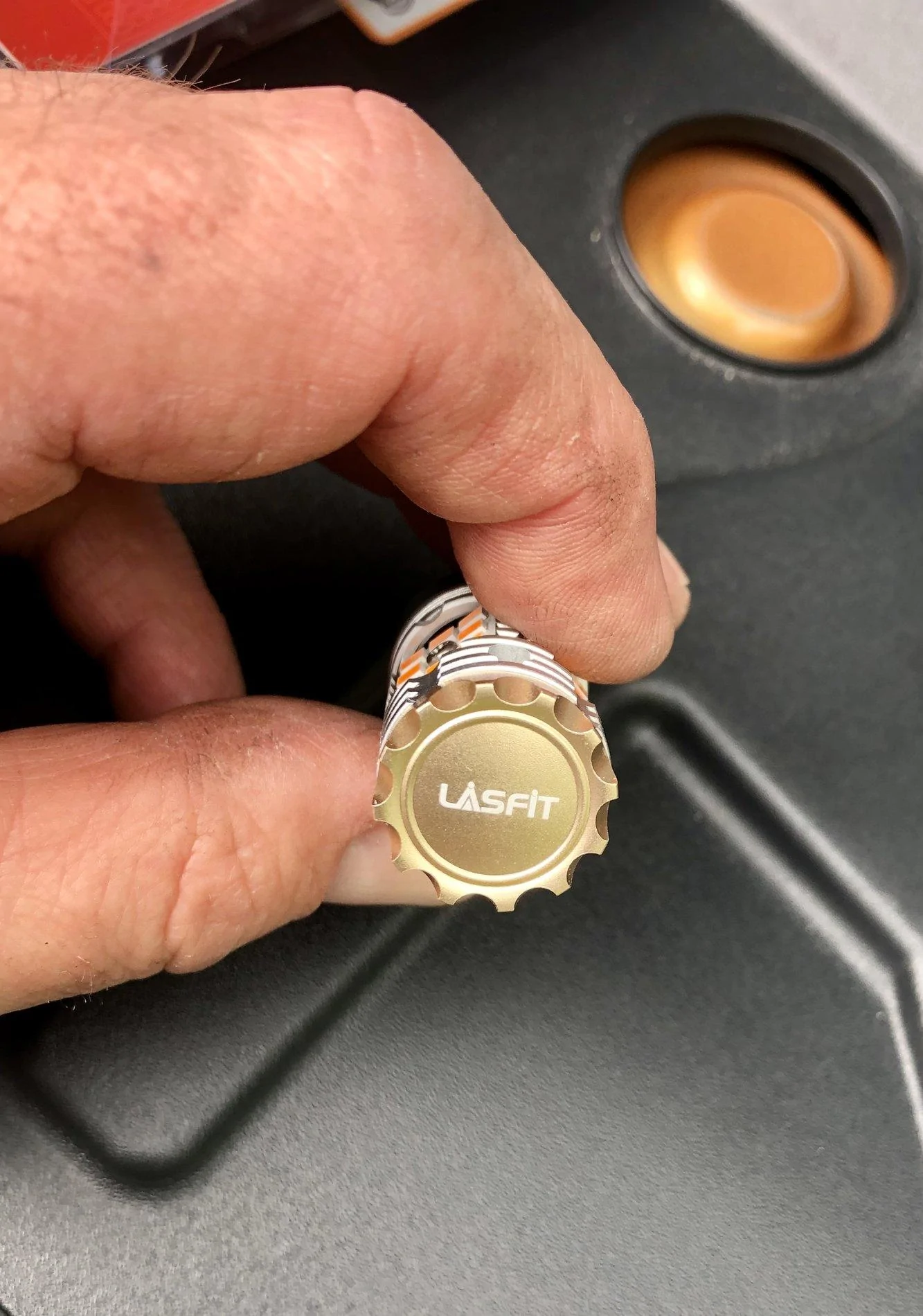

OP, good info.
Only thing I suggest is better bulbs.
Lasfit.
Lasfit customer service is good.
Had a small side market bulb act up. They sent two replacements.
Bright bulbs with no hyper flash.
Built in circuits.
