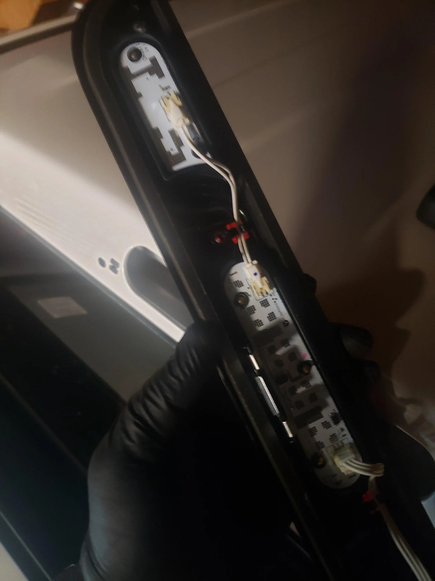

Here is what my cargo/3rd brake light looks like. These must be LED already, no?
That’s interesting, what’s the build date on your truck? I’m wondering if they’ve updated them to LED

D.D.S.
Yeah it is. Maybe that's why??
Lariats have LED 3rd brake lights already. AFAIK, the only incandescent bulbs in the Lariat are side markers (including side mirror indicators) and license plate bulbs.
