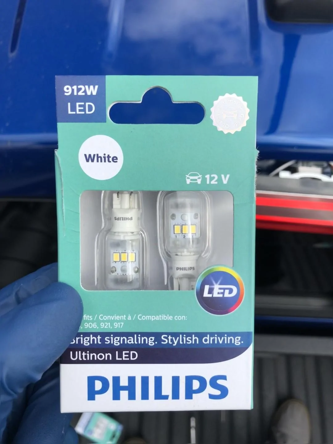

I decided I wanted LED’s and since I couldn’t find any info online I thought I’d share my findings.

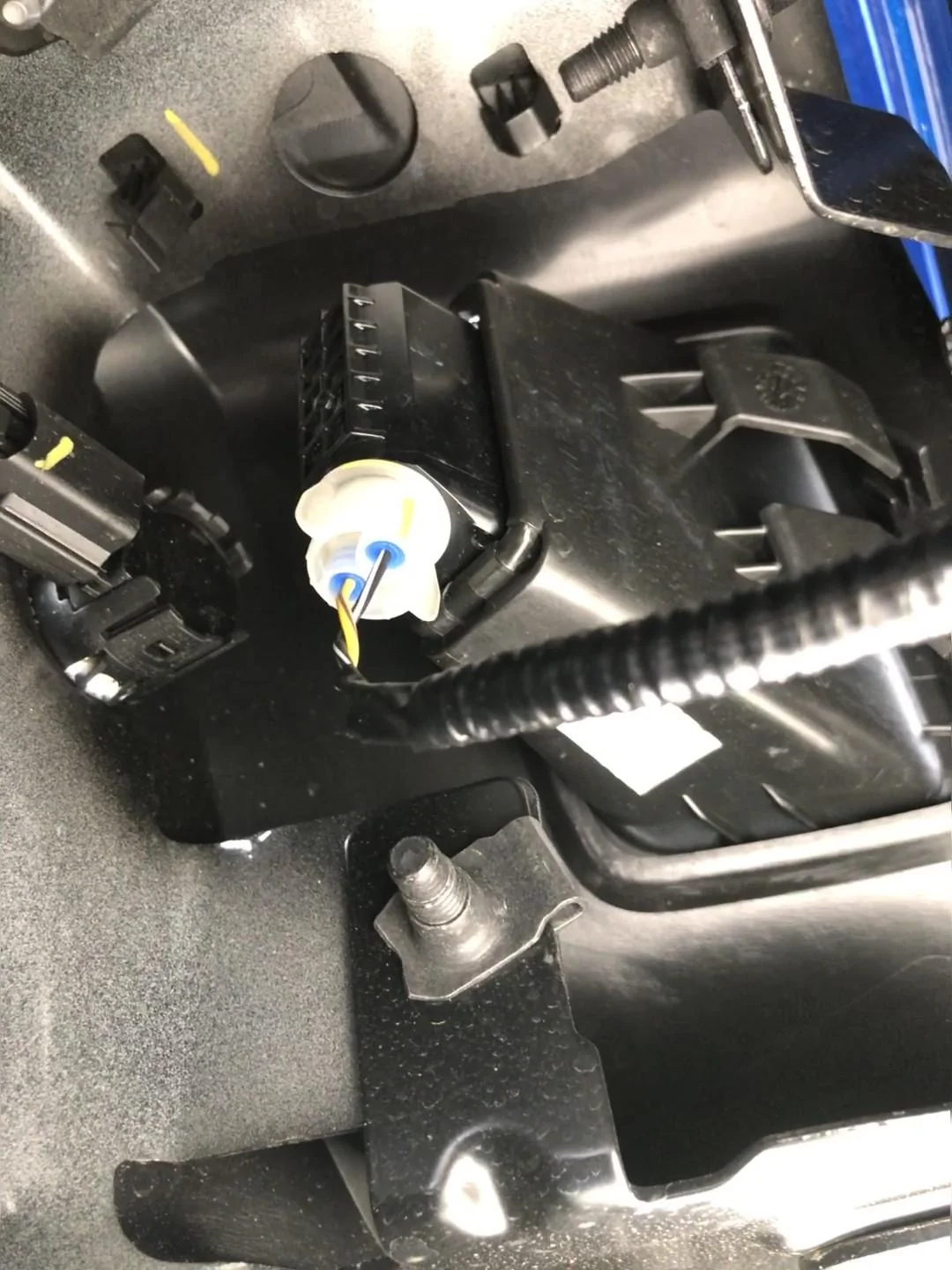

License Plate Lights: 194 (Also Fit: 158/168/12961) Access through underside of bumper, easy access, turn counter clockwise to remove.

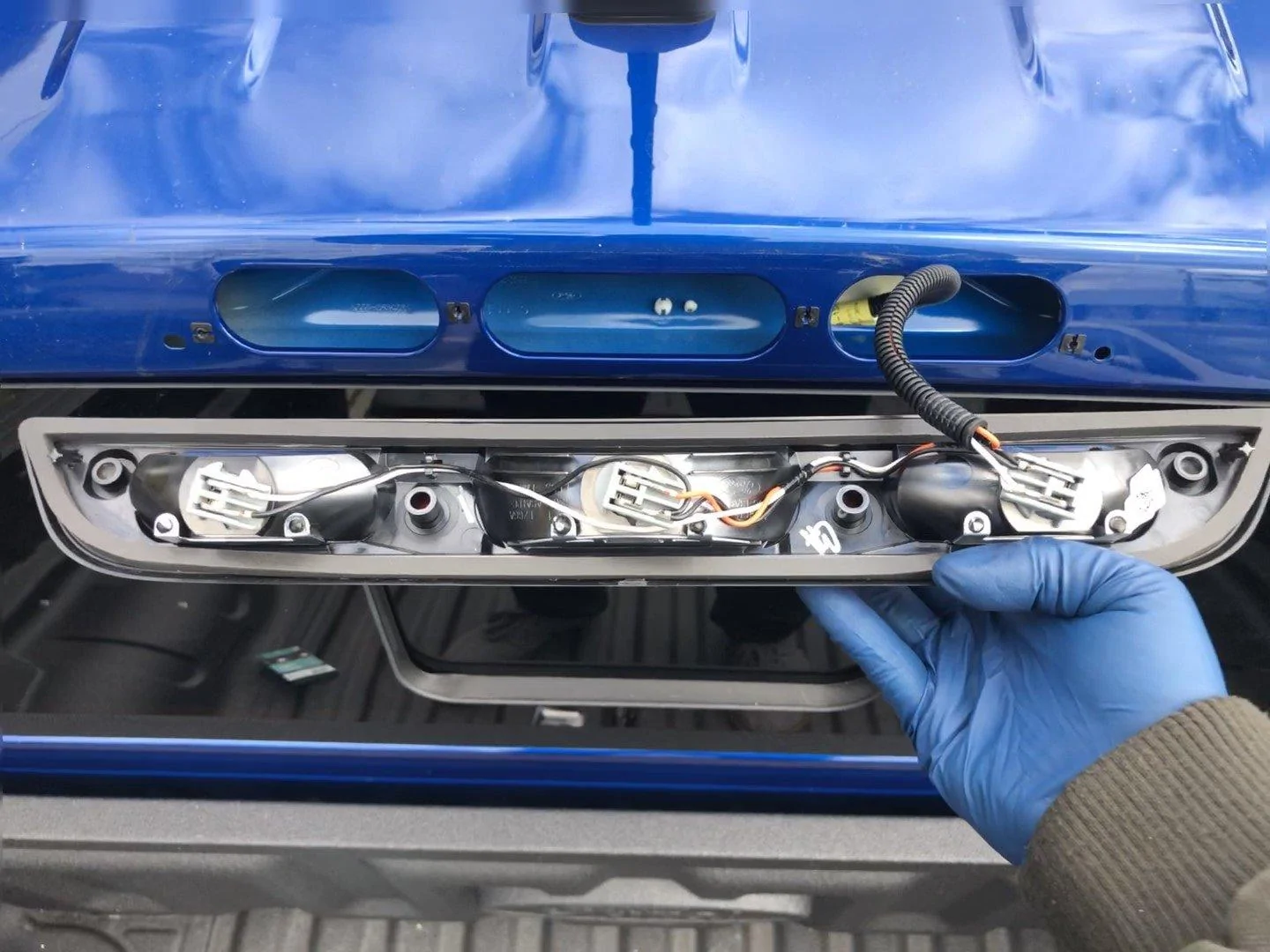

Third Brake / Cargo Bed Lights: 912 (Also Fit: 904/906/921/917) There are 3 and they're all the same. No need for a Red bulb due to the red reflector housing. Held in place with 4 T20 Hex Screws. Turn bulb socket counter clockwise to remove.

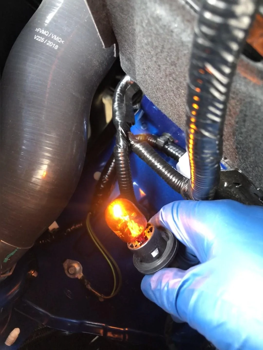

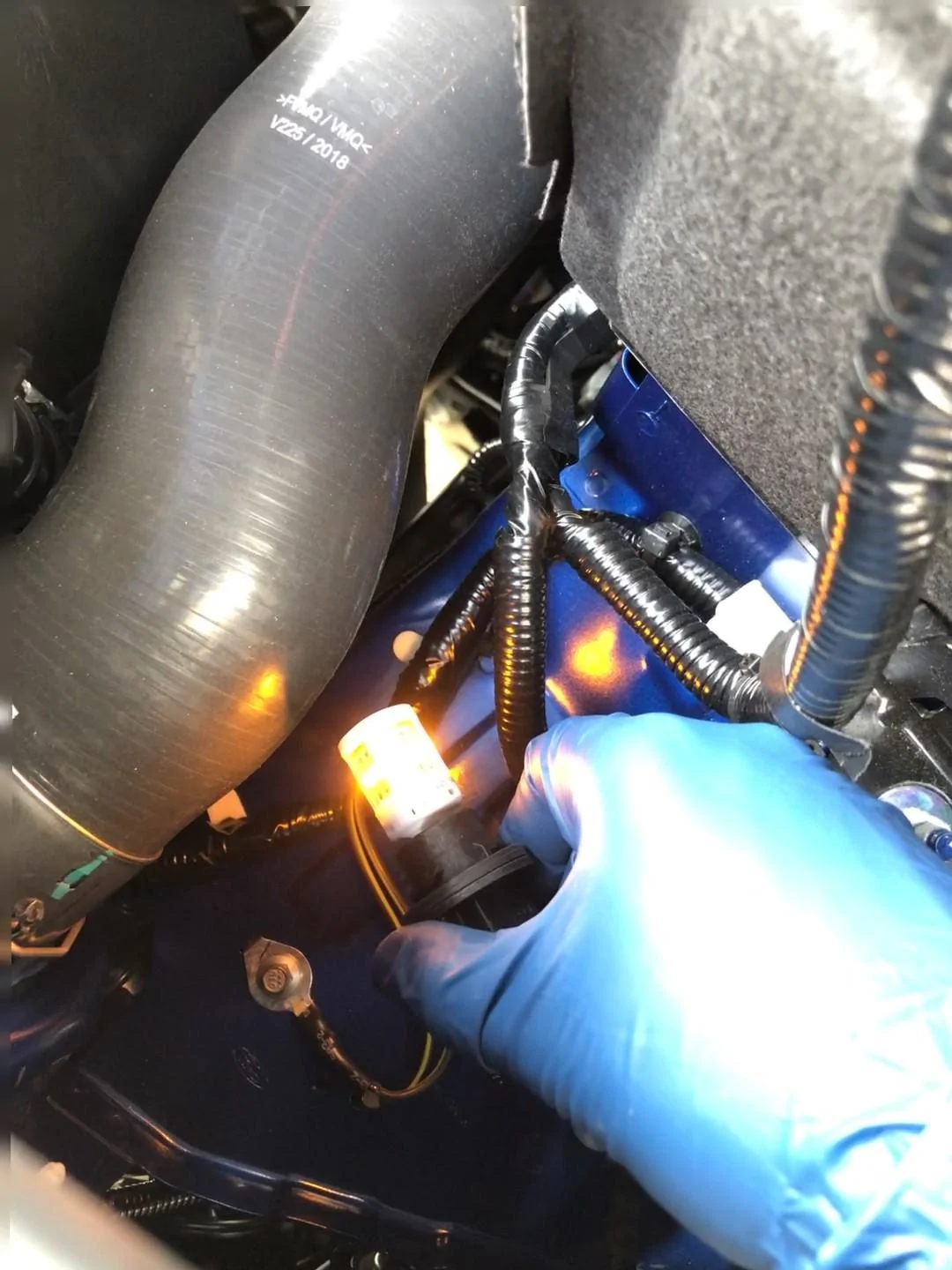

Turn Signal/ Parking Lights: 7444A (Also Fit: 7443A) A is for Amber. You could use other styles/colors but I would not recommend. Passenger is extremely easy to access, driver is a bit of a squeeze. Turn counter clockwise to remove.
Keep in mind that these LED are directional. They need to be installed in the correct orientation. If incorrectly installed they will not illuminate, so if you decide to change them I advise you to test before reinstalling. I am not sure if this characteristic is common with all LED's but it definitely is with these Philips bulbs.
Another note; I'm not sure how I feel about the LED parking/turn bulbs. They don't appear to be as bright once installed and since there is a resistance difference in them vs the stock bulbs; the dash turn indicator blinks twice as fast, although the blinkers themselves appear to blink normally. I may just toss them, we'll see how annoying it gets sitting at stoplights. Maybe I'll install a resistor. I'll keep you guys updated.
Bulbs used for Third Brake/Cargo Bed Light

Back view of Third Brake Light
Stock Turn Signal/Parking Light
LED Turn Signal/Parking Light

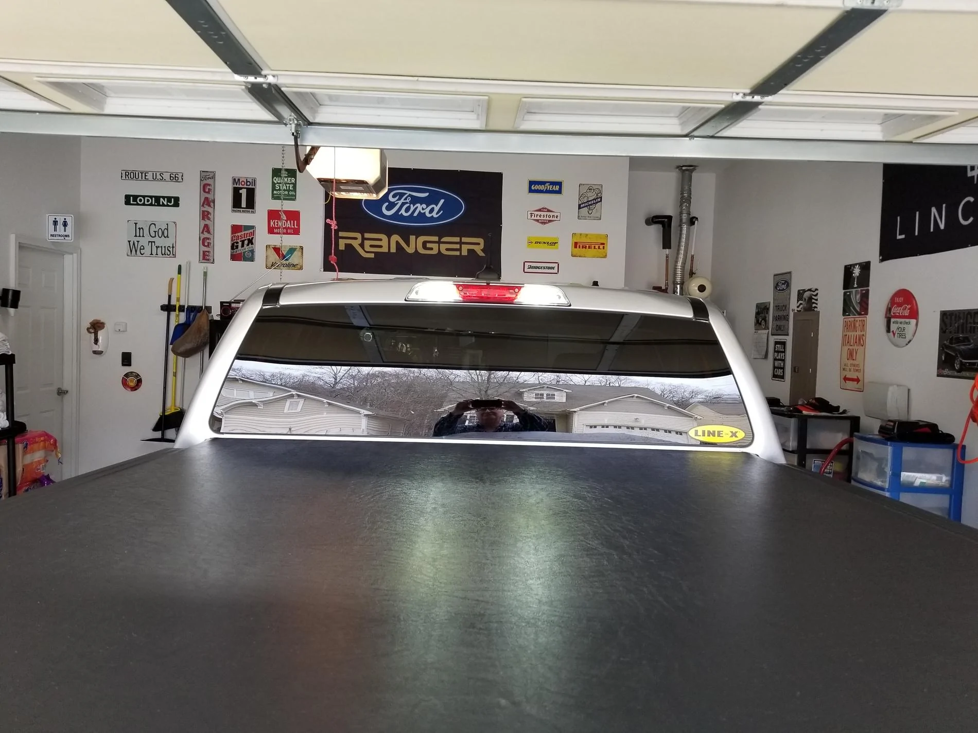

Can the cargo light bulbs be changed to LED in front by just taking the lens off or do you have to pull out the assembly?
LightningBlue
LightningBlue
Ryan
Feb 12, 2019
276
364
Rancho Cucamonga, Ca
2019 Lightning Blue XLT FX4/ 2023 Subaru Forester
You must take off the assembly, but its just 4 screws and comes off very easily.
edit: You're referring to the Rear Third Brake/ Bed Lights right?

Yes, thanks.
The bulbs come out from the back.

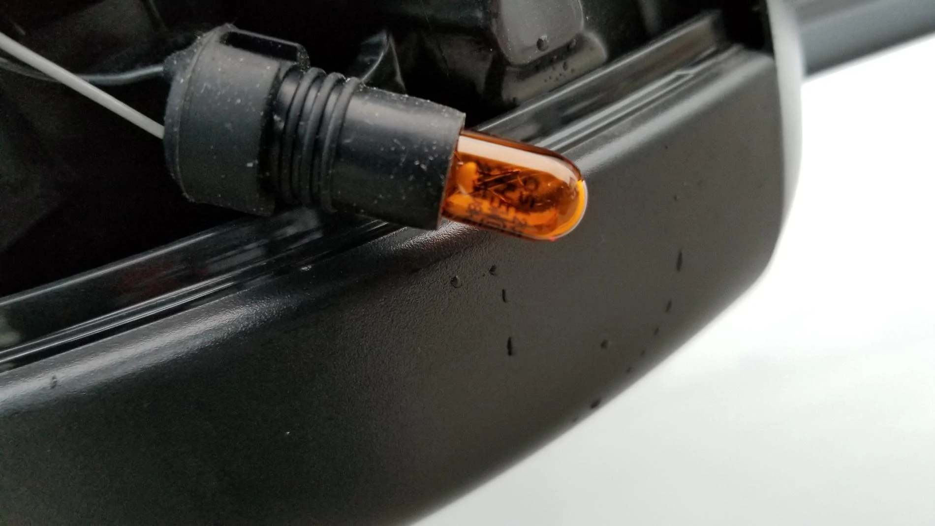

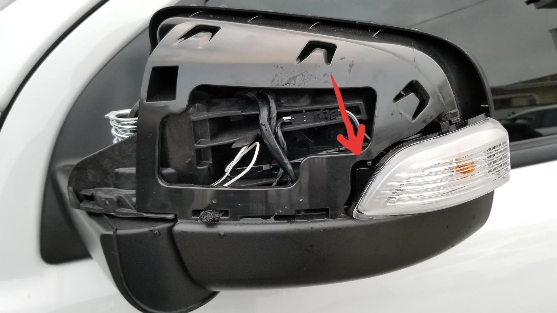

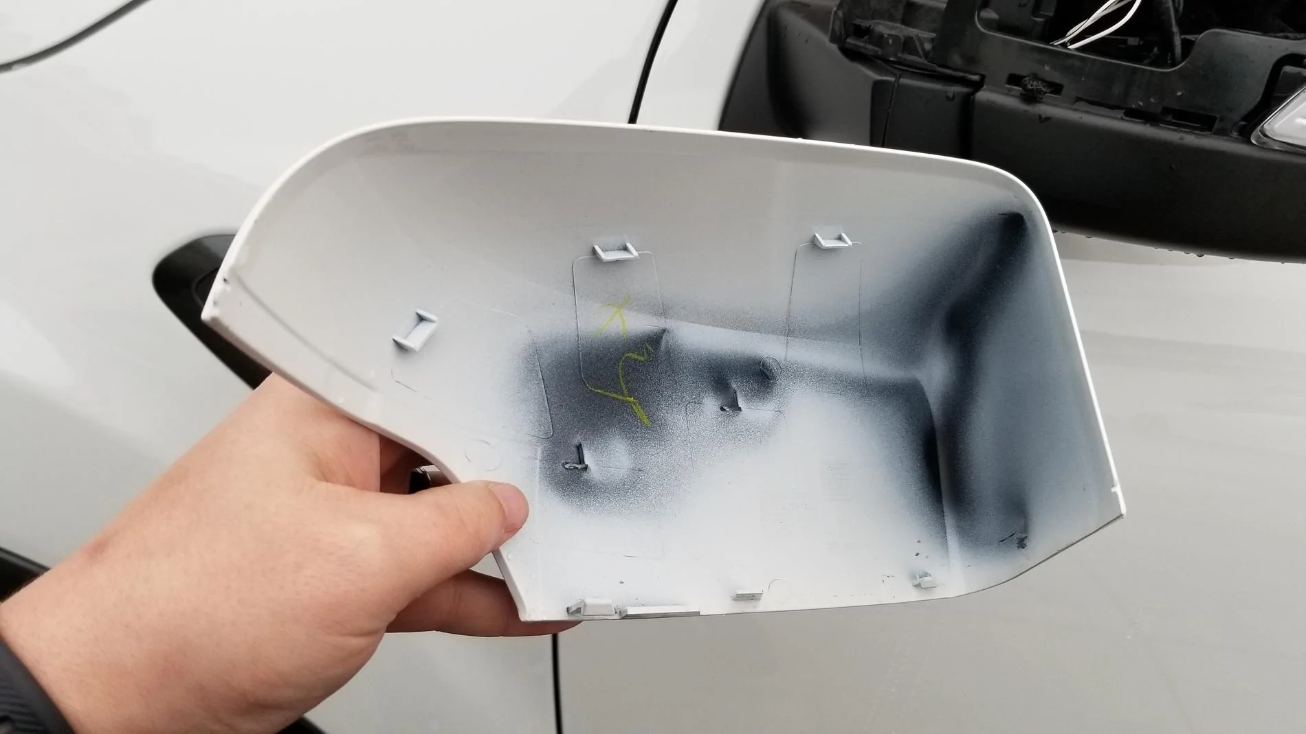

Don't mean to hijack you're thread @LightningBlue , but here's how you swap out the in-mirror turn signals on the Lariat trim. It's a 194 bulb. (WY5W)
Pop off the plastic cover, here's where the tabs are:
Free the clip behind this red arrow:
Housing pops off and you can just pull the bulb out:

Put a pair of VLEDs LEDs in and they're great!
Thanks, Lightning Blue!
How exactly did you take that cover off? I'm standing there staring at mine and I have no clue on what to do.
