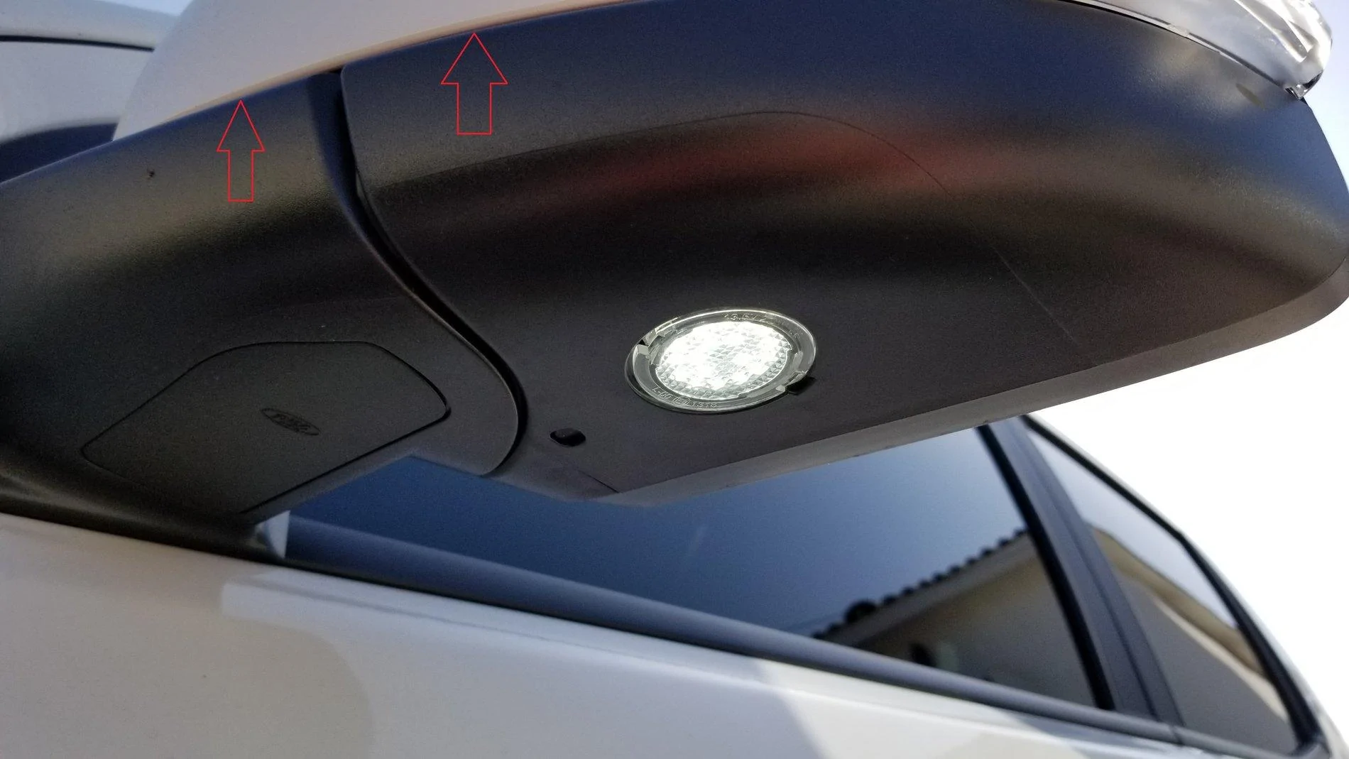

How exactly did you take that cover off? I'm standing there staring at mine and I have no clue on what to do.
To get the cap off, you have to stick a plastic pry tool under the cap and just kind of pop it off. Here's a pic showing where to stick in the pry tool. Let me know if you have any other questions.

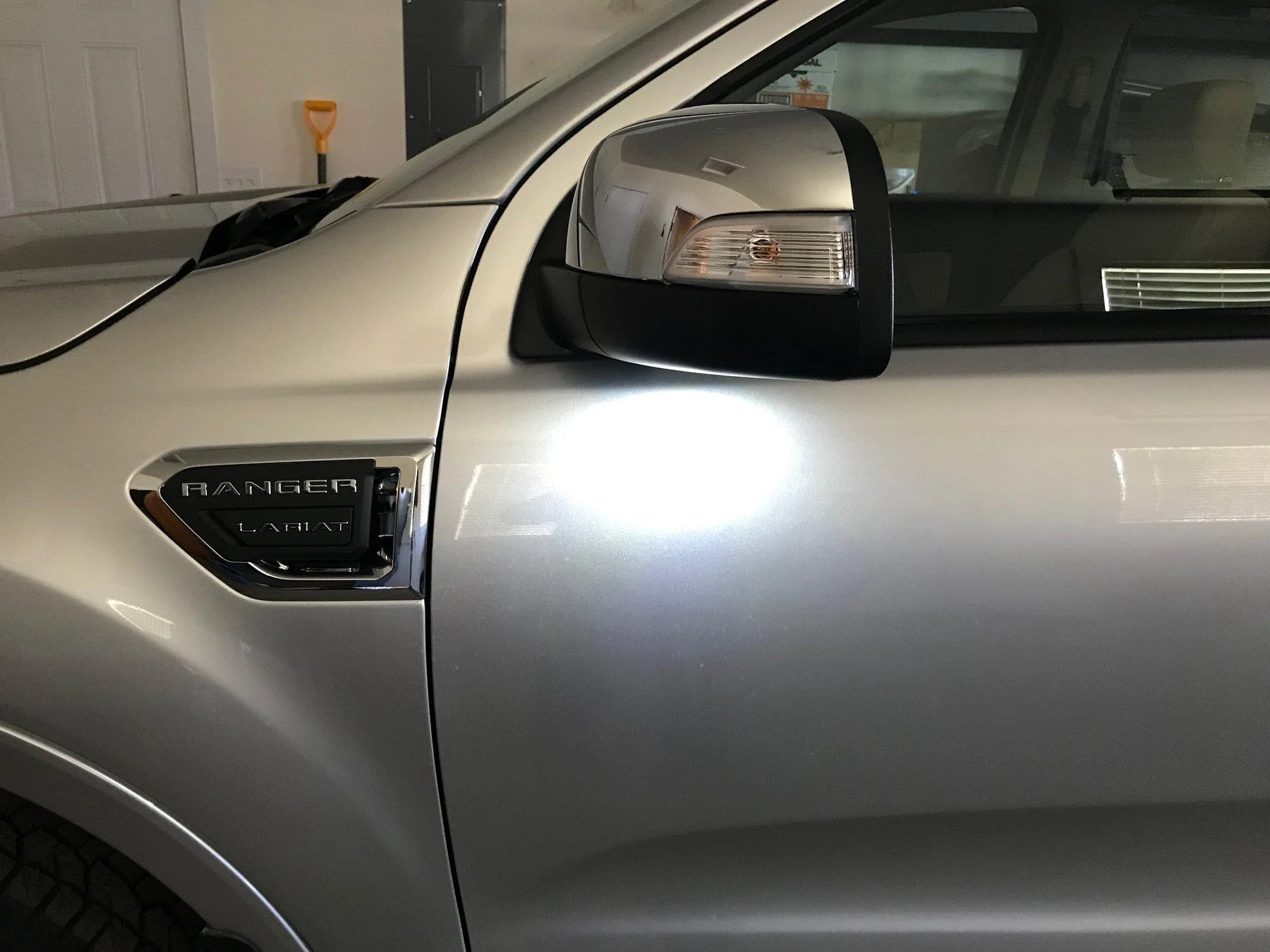

@j0shm1lls I got my puddle lights today just like yours and they are great, can't wait to see what they look like in the dark. Notice a big difference even in the garage during the day.

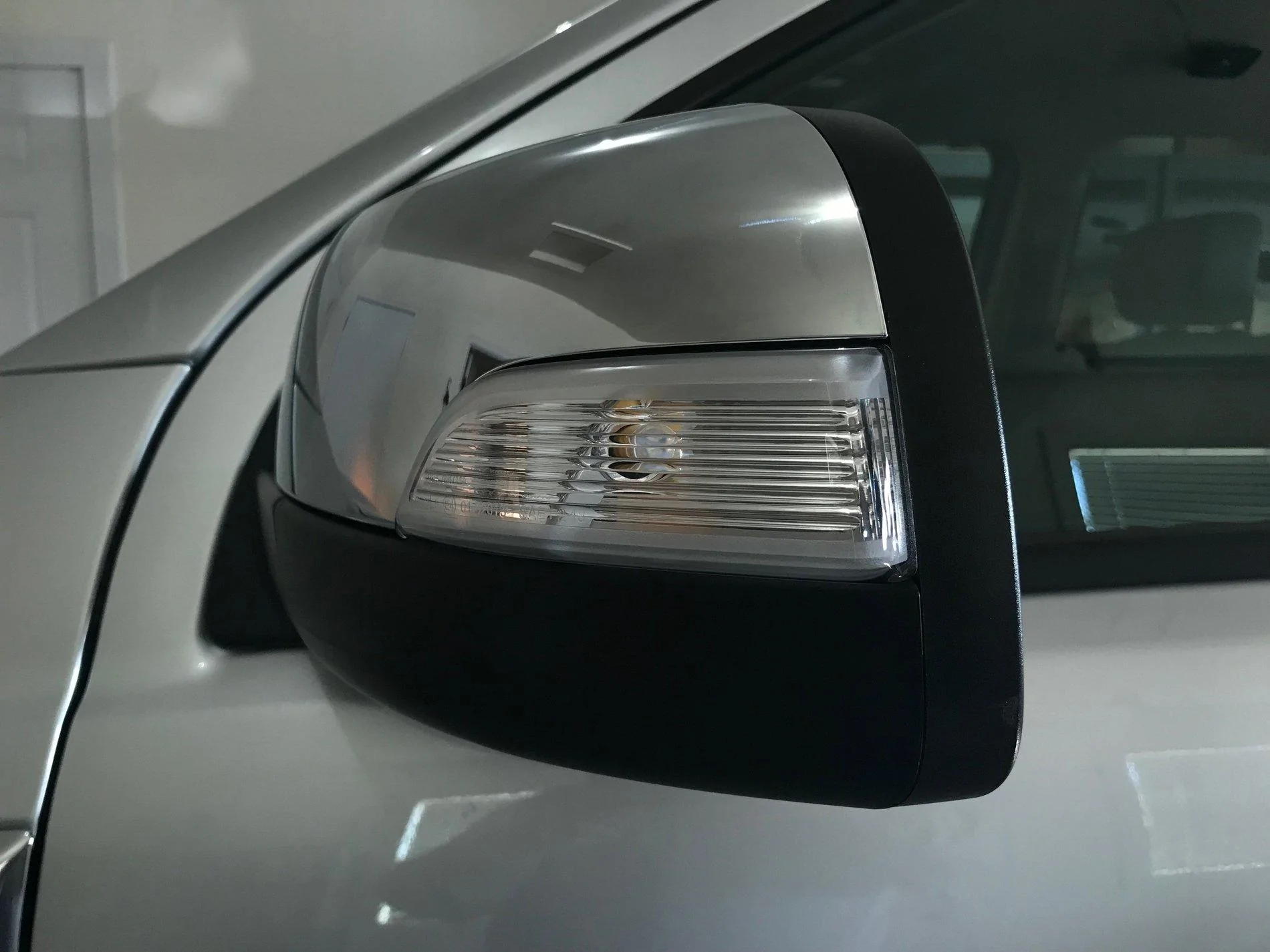

Don't mean to hijack you're thread @LightningBlue , but here's how you swap out the in-mirror turn signals on the Lariat trim. It's a 194 bulb. (WY5W)
Pop off the plastic cover, here's where the tabs are:
Free the clip behind this red arrow:
Housing pops off and you can just pull the bulb out:

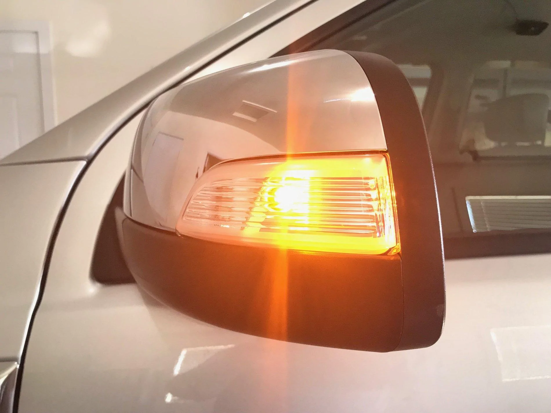

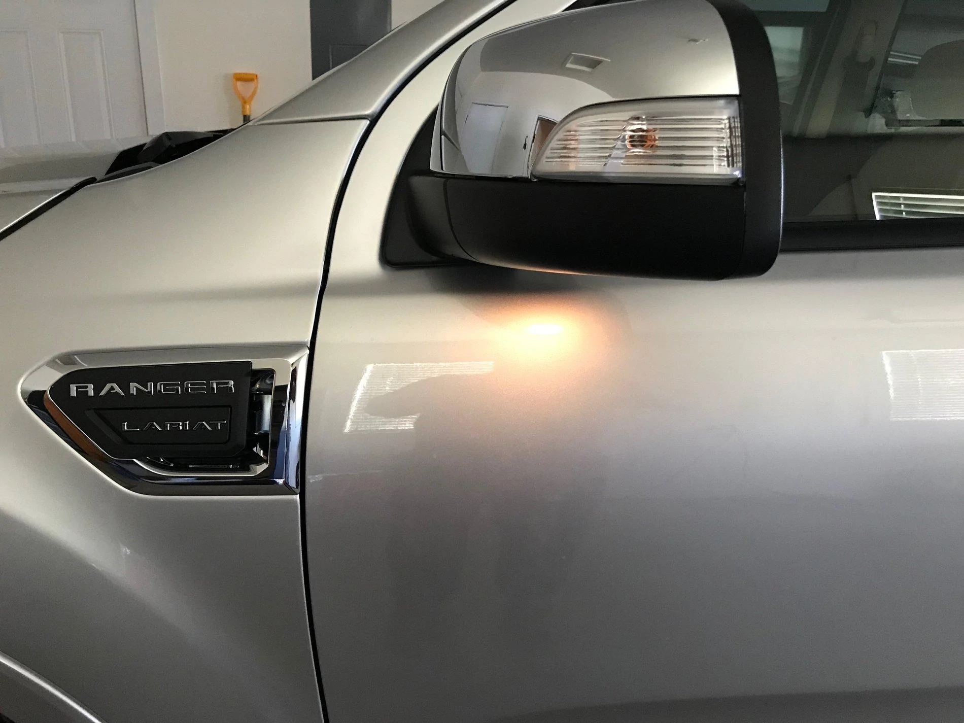

@j0shm1lls I replaced mine today with Diode Dynamics HP5 (AMBER) LED BULBS purchased from @PandaMotorworks and I love them. LEDs all around now on my Lariat. Except for the front turn ones as I don't want hyper blink and I don't know if I'm brave enough to do forscan. Taking the mirror cap off w/ a trim removal tool was not too bad but did have to pry a little harder than I thought to pop it off. I just have a big fear of cracking something or damaging it.
