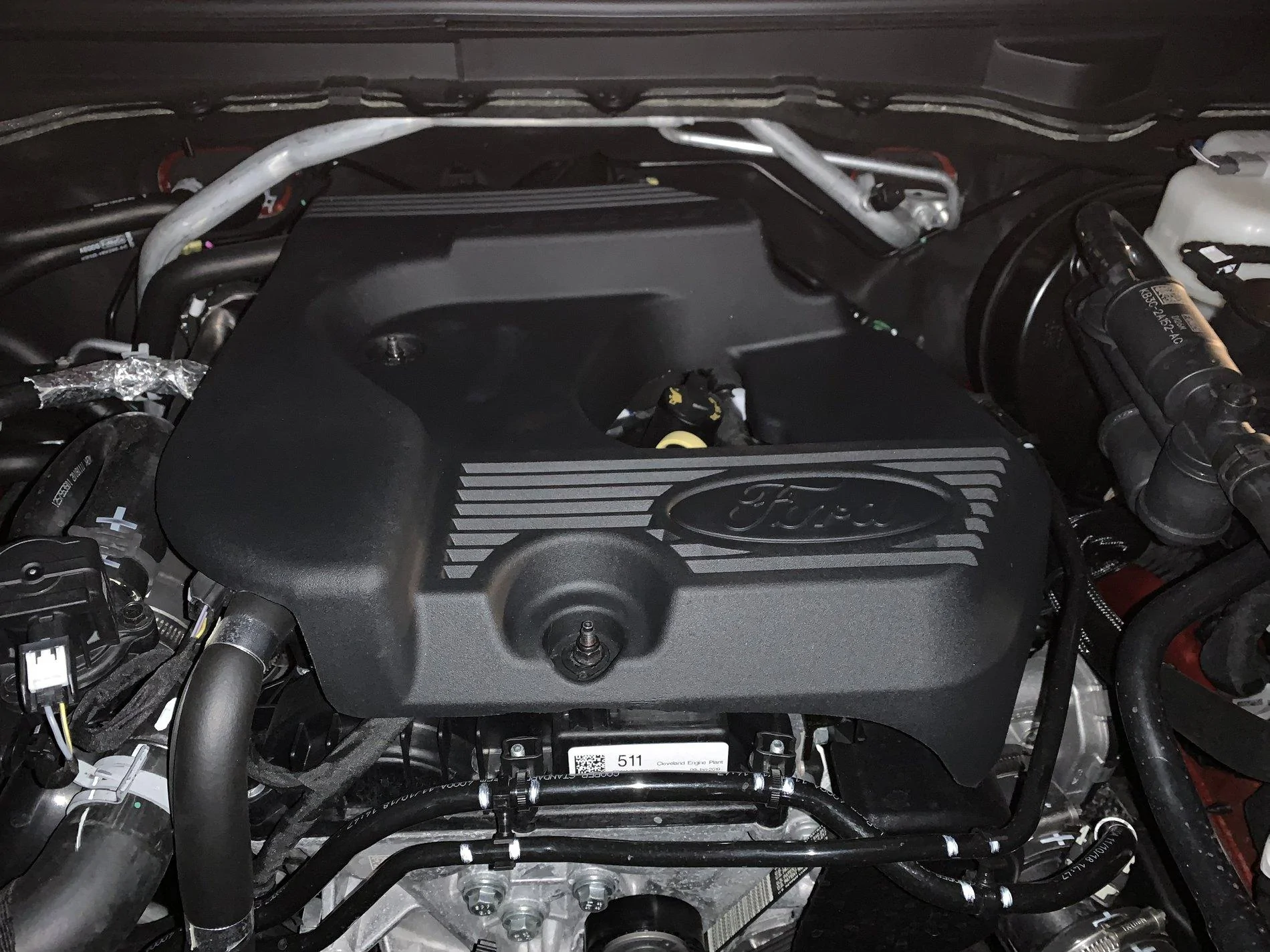

I hear that Lariat engine cover is available through the parts department for about $53. I plan to get on for my XLT
Just picked up the engine cover from my dealer for my XLT. List price is $45, dealer charged me $30. 4 bolts with nuts, list is 6.50 each, dealer charged me 3.50 each. $47 total after tax.
You don't really need all 4 bolts. Two are used to hold down the cover, one is used as a support on the left side and the fourth one I couldn't find a place for it at first. Then I found a thread about 6 inches behind the cover so I put the fourth one there. Doesn't even touch the cover, serves no purpose, but I just left it there anyway.

Did it help with the noise?
Maybe a slight bit quieter inside the cabin. Engine wasn't that loud to begin with, sounds like a four cylinder.
The cover really helps .. I bought mine from the dealer it was easy to install .. it still roars st take off .. that’s not engine it’s the fan .. I think it does this to really try to push more air through the intercooler

Does anyone have the part number for the cover? Would love to order one ourselves
