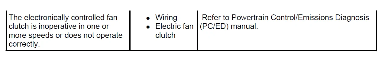

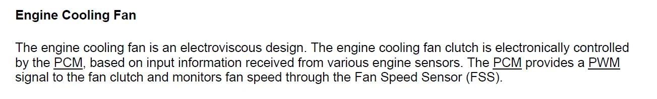

On a heavy diesel, the fan clutch is pneumatic, controlled by the PCM. If there is low/no air supply, the default is always engaged (fan always on). I would hope Ford engineered their fan clutch similarly. Keep moving, watch your temp gauge. Drying off the connectors will probably help, but it sounds to me like the fan clutch is shot.
