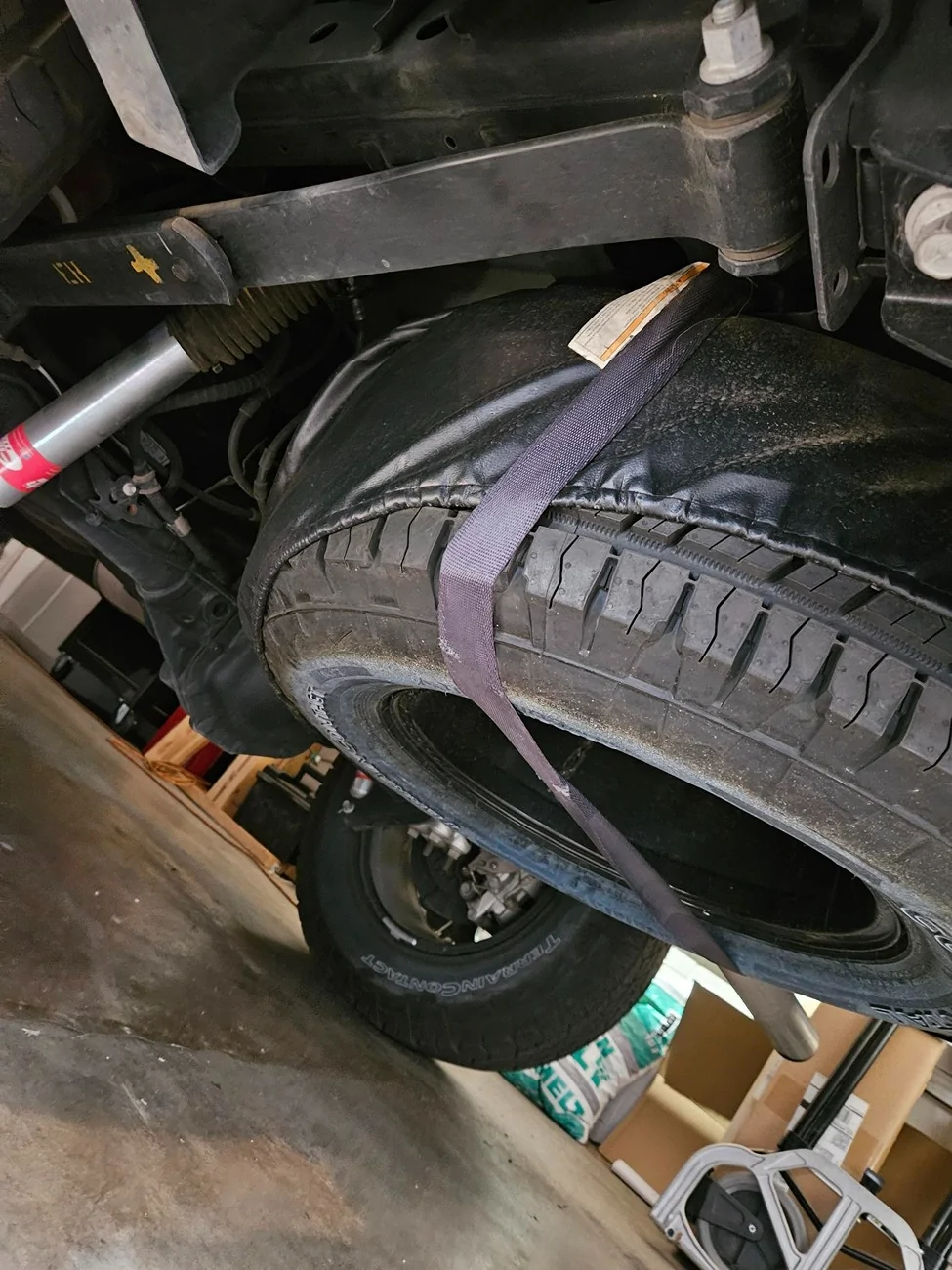

In regards to a loose sway bar link, when I replaced the stock links (having plastic parts) with the Mevotech links, I guess I didn't torque them enough. After a hard core off road trip last month around Silverwood Lake, I was hearing something loose over certain bumps.
After a couple weeks of driving around to listen, bouncing on the tailgate while underneath, FINALLY ID'd the bolts on the links. Tightened with Loctite.
What was tricky was the sound never seemed to be from the front, seemed to be from the bed.
Rocking the bed left and right finally heard a clicking from the swaybar.
Did check the spare, removed a rear shock to check it...
Good luck!
