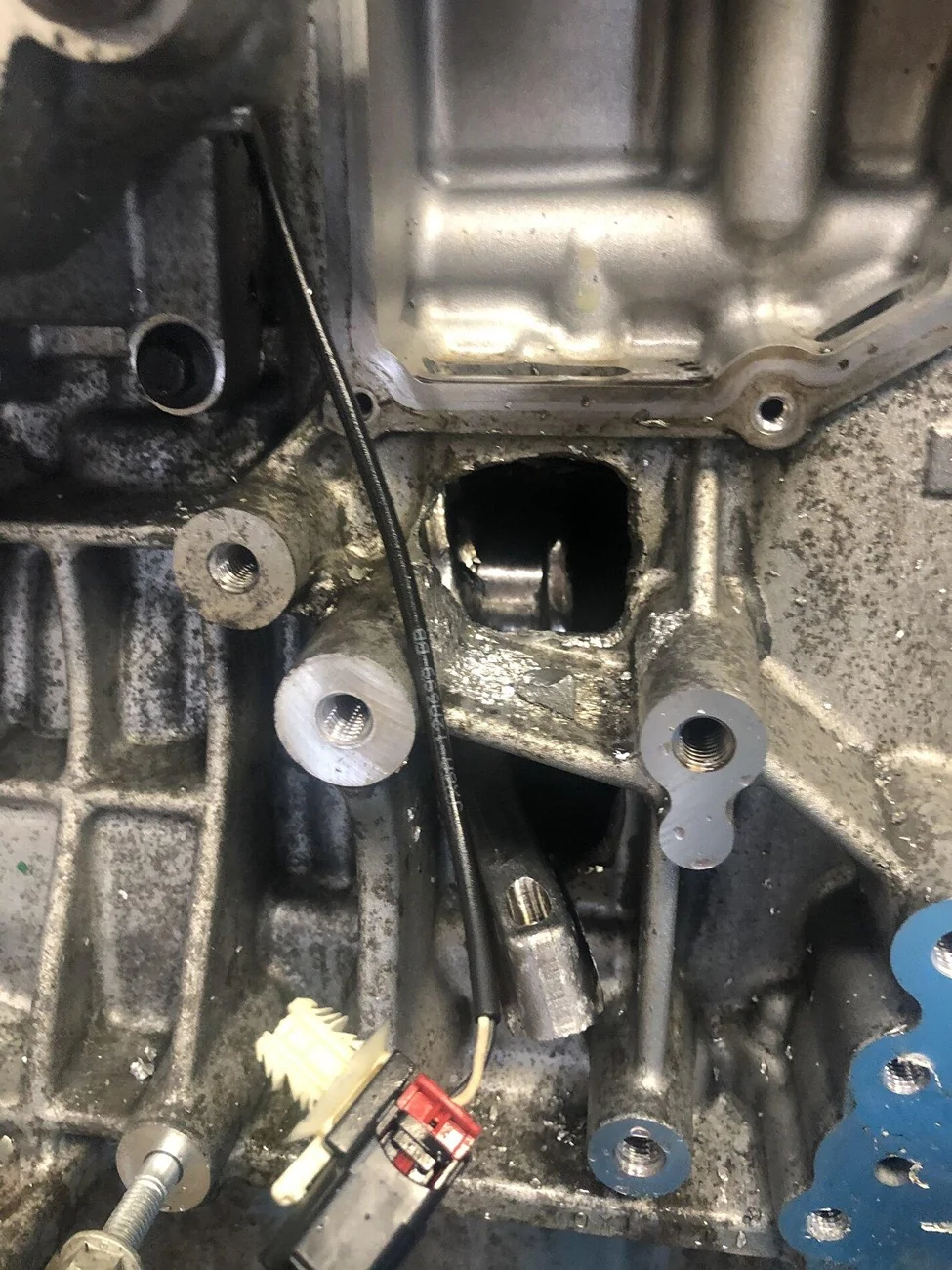

IT is getting replaced with a NEW engine.
That’s great. Post photos if they send you any. The other person did and they were very interesting….
