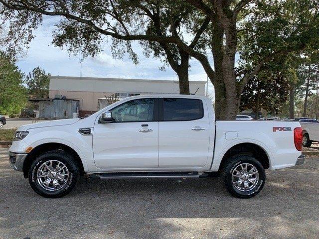

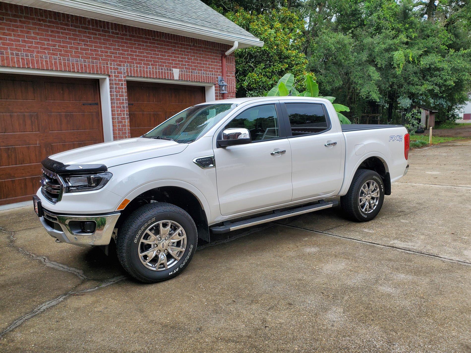

Vast improvement. Not complaining about factory setup. I understand Ford's approach to sales.
Eibach not harsh at all. Mine is a fx2 so very soft/compliant to start with. Front end alignment with no issues. Haven't adjusted the headlights yet. No worries on the questions. As I recall there was 3+ inch rake before. .75 now as measured at center of wheel well arch. Also, note that I installed the fronts and drove a week or so and enjoyed the improvements. To match things up (because I'm strange that way) I ordered and installed the rears. They improved the ride to my tastes even further.

How did it look with only a .75 raise? I tow a large enclosed snowmobile trailer and don’t want it to look like the front is higher with the trailer attached. The Rangers do seem to have more of a rake than my F-150 did so I want to raise the front a little. Improvement in ride would also be good. Looks like to do the front and back runs $570. Is that what you found? Thank you.
Brian
My 20' enclosed is ~7500lbs. I was surprised how little the rear squatted. The truck was either flat with maybe a little rake left in it. That's why bringing the front up .75" was a non-concern for me.
