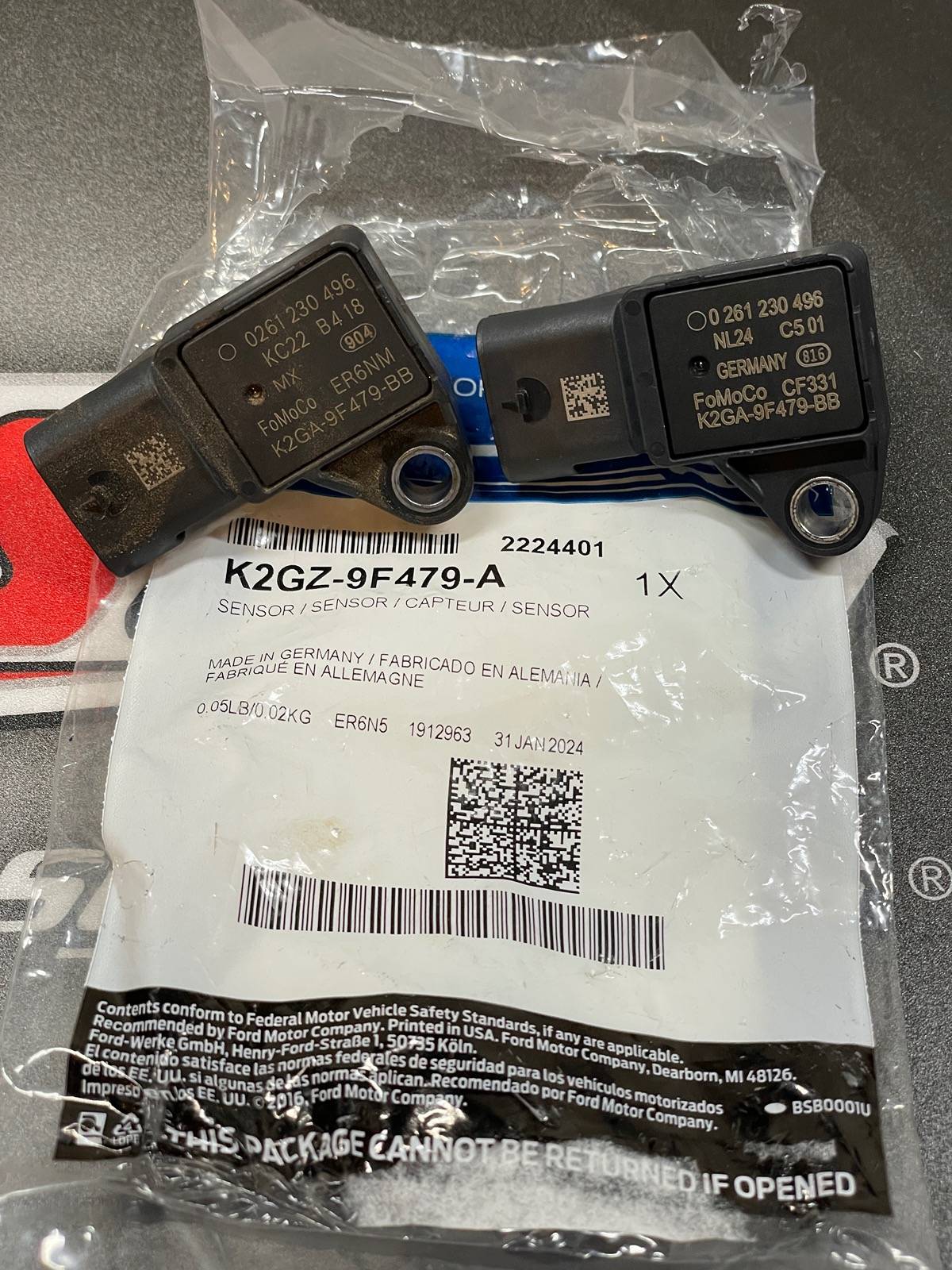

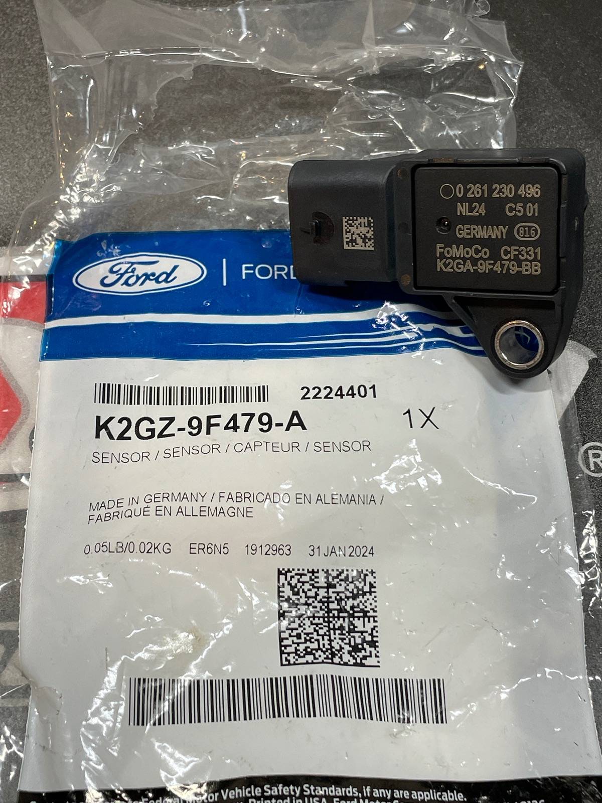

-MAPT Sensor (Ford K2GZ-9F479-A) ($43 on FordParts.com and delivered to my doorstep less than 24 hours after ordering)

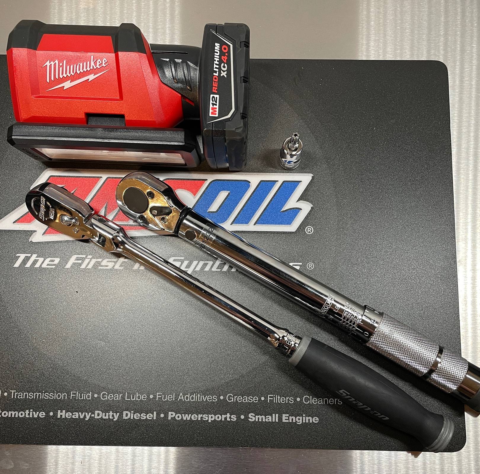

-3/8" or 1/4" Ratchet (Cordless Ratchet can be beneficial)
-T30 Torx Socket or bit
-Torque Wrench set to 53 in.lbs (6 Nm)
-LIGHT (Headlamp, Milwaukee Rover, etc)

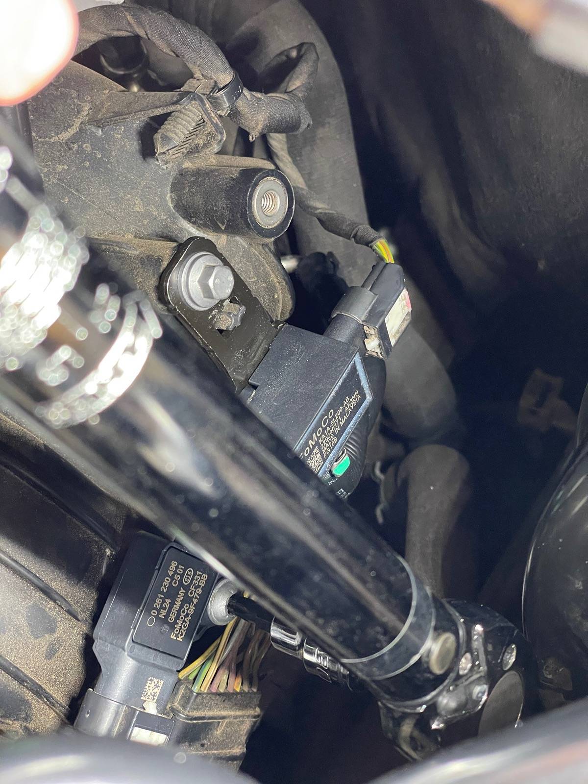

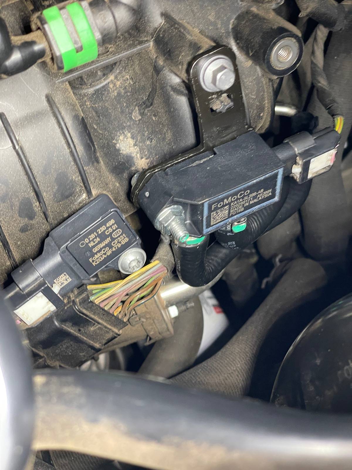

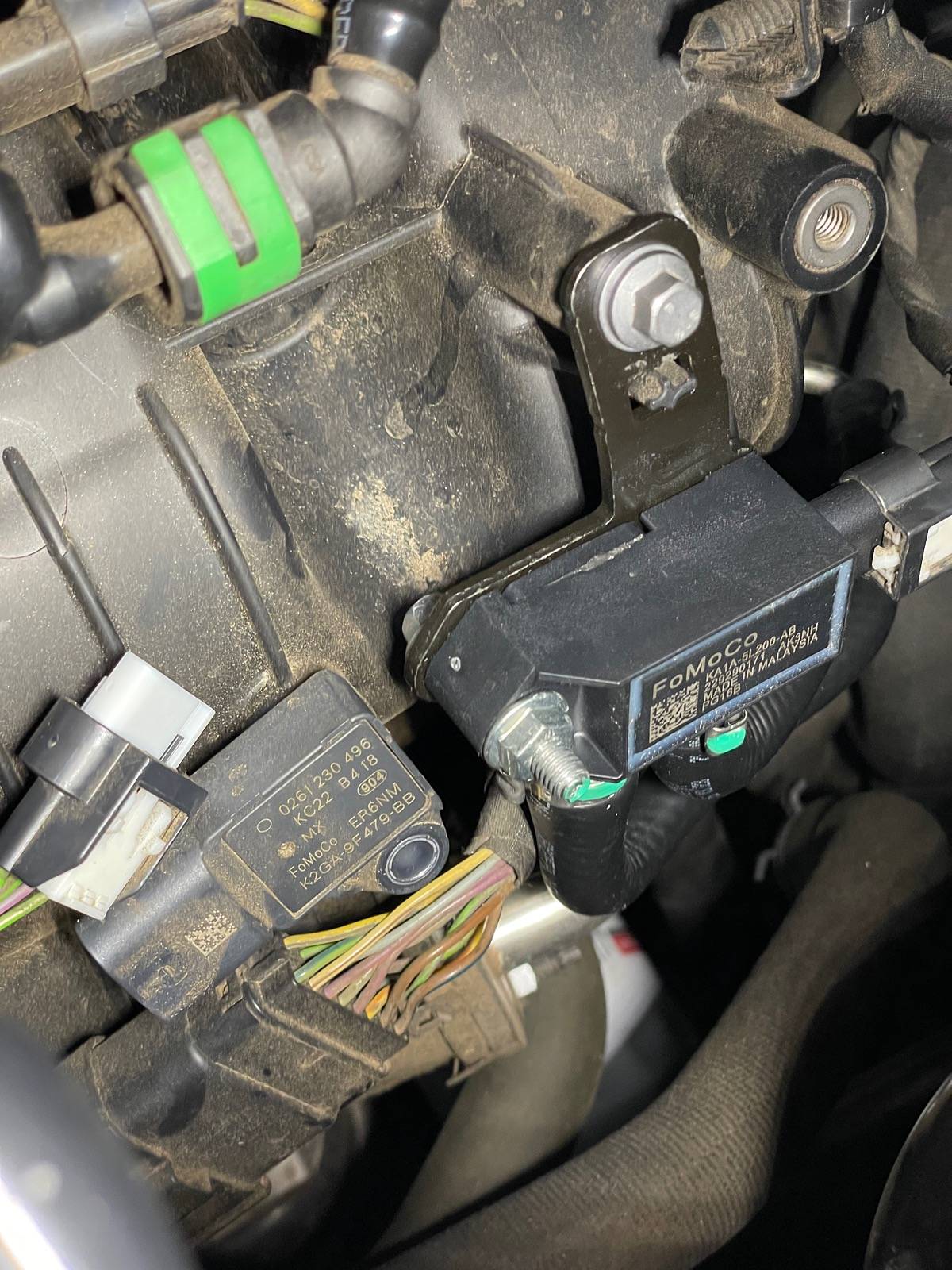

Pop the hood and locate the MAPT sensor. It is located next to the DPFE sensor on the driver's side of the engine protruding from the intake manifold.
STEP TWO :

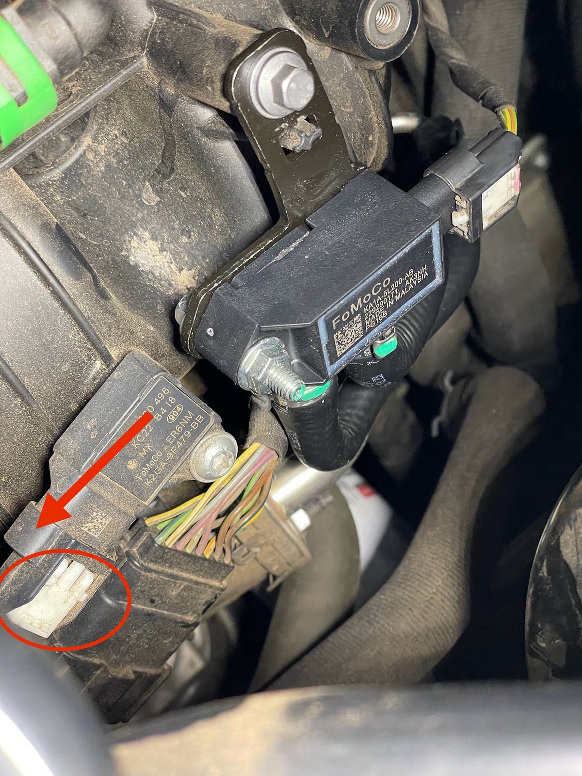

Remove the MAPT electrical connector. It works like every other connector on our truck; use your fingernail to slide the locking tab back (circled) and wiggle the connector off pulling towards you.
STEP THREE :
Use your 3/8" ratchet and T30 Torx Socket to remove the MAPT bolt. It is faster if you initially break the bolt with your ratchet and then remove it with a cordless ratchet. Be sure to either catch the bolt or finish unthreading it with your fingers to ensure it does not drop into the engine bay.

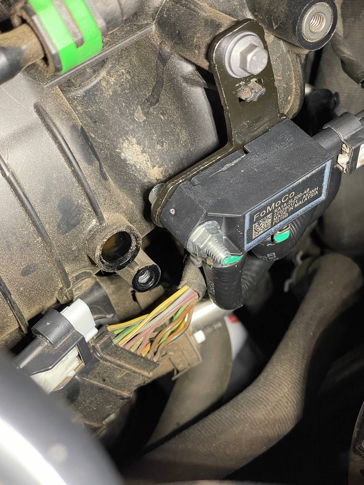

STEP FOUR :

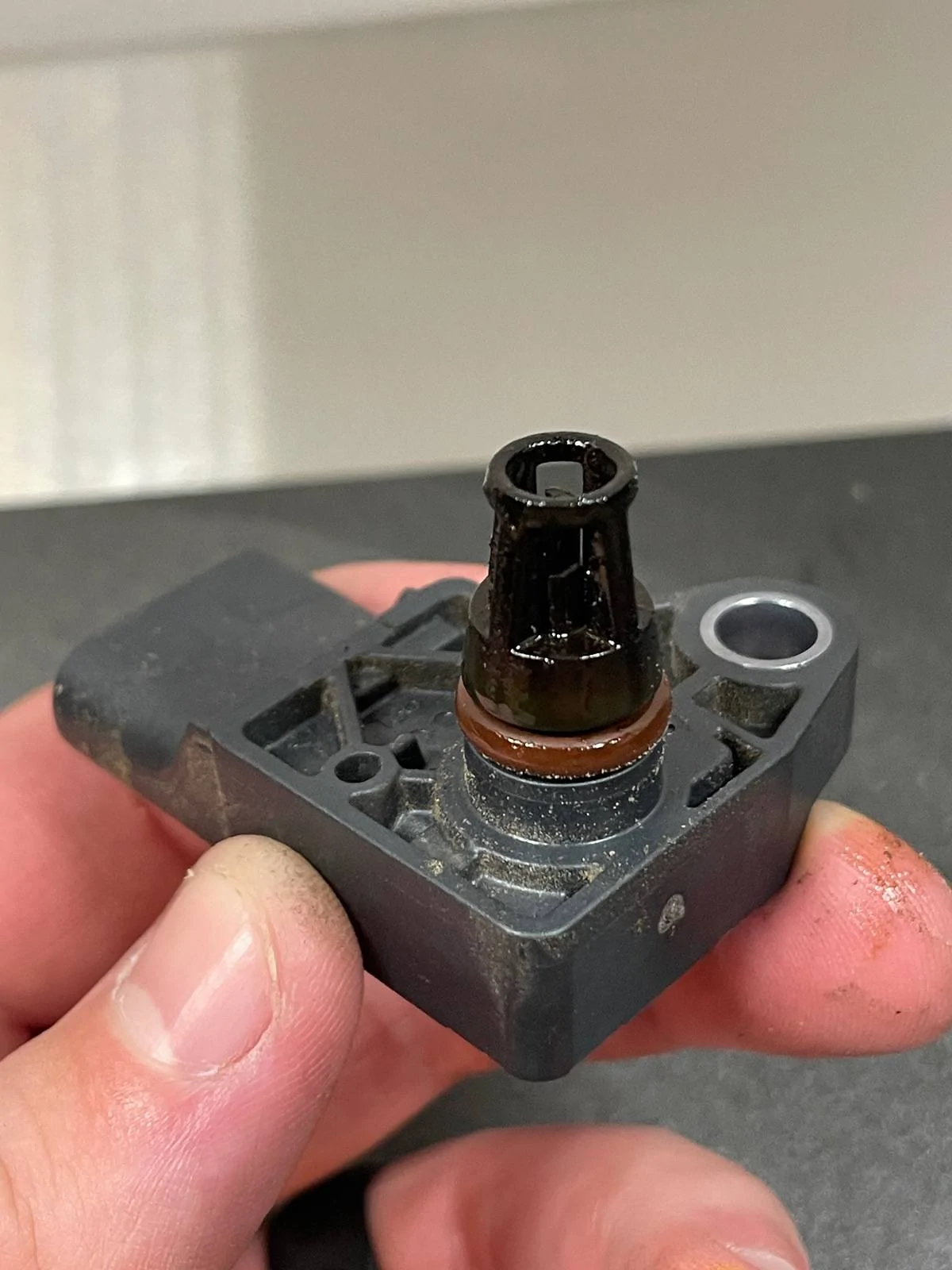

Wiggle the MAPT sensor a little bit and it should pull right out. Ensure the orange o-ring did not become dislodged in your intake. My MAPT sensor had a light coating of oil on it, so I opted to clean the mounting hole out with a shop towel the best I could. Might have to invest in an oil catch can eventually..

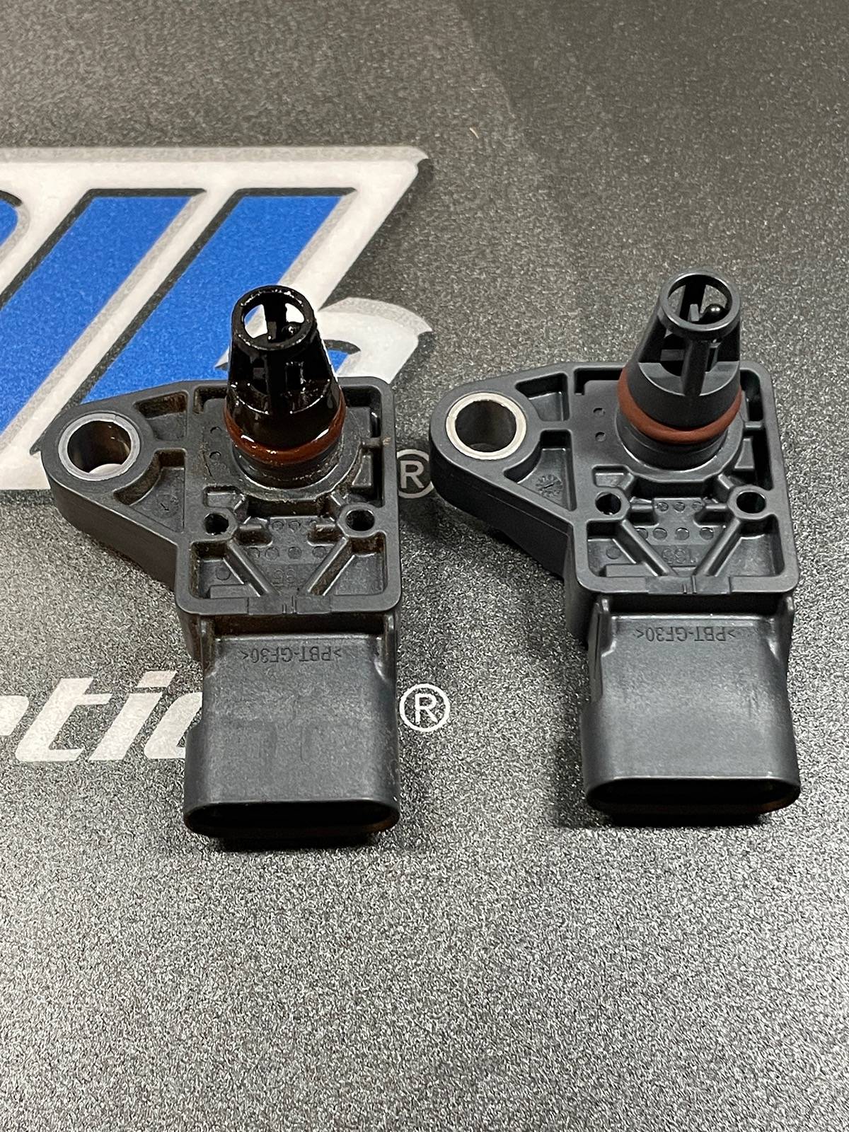

Install your new MAPT sensor. All it takes is a little push and you can rotate the bolt mounting hole where it lines up on the intake. Interesting enough my OEM MAPT sensor was manufactured in Mexico (MX) and the new one was probably manufactured by Bosch in Germany. I trust German quality more any-day.

Plug the connector back on to the new MAPT sensor until you hear a click. Use your fingernail to push the locking tab forward to engage.
