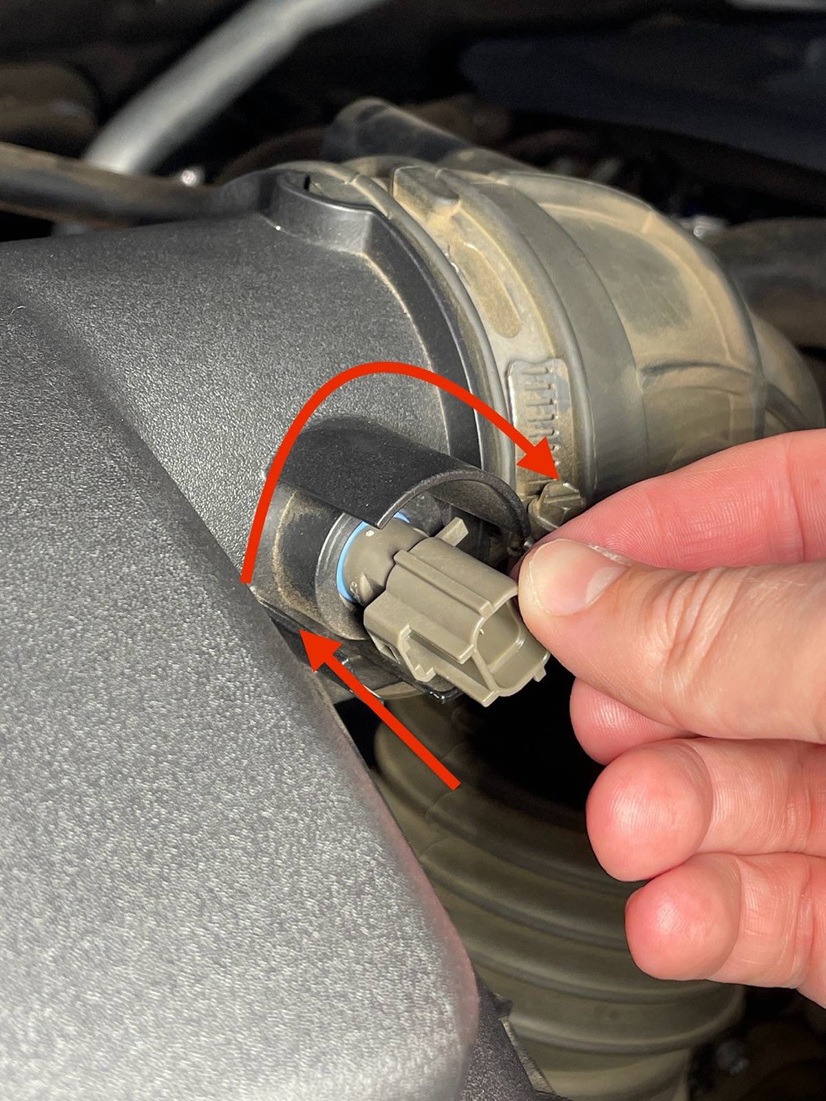

Disconnect the IAT electrical connector. Simply push down on the tab (circled) to release the locking tab and pull it towards you to remove.

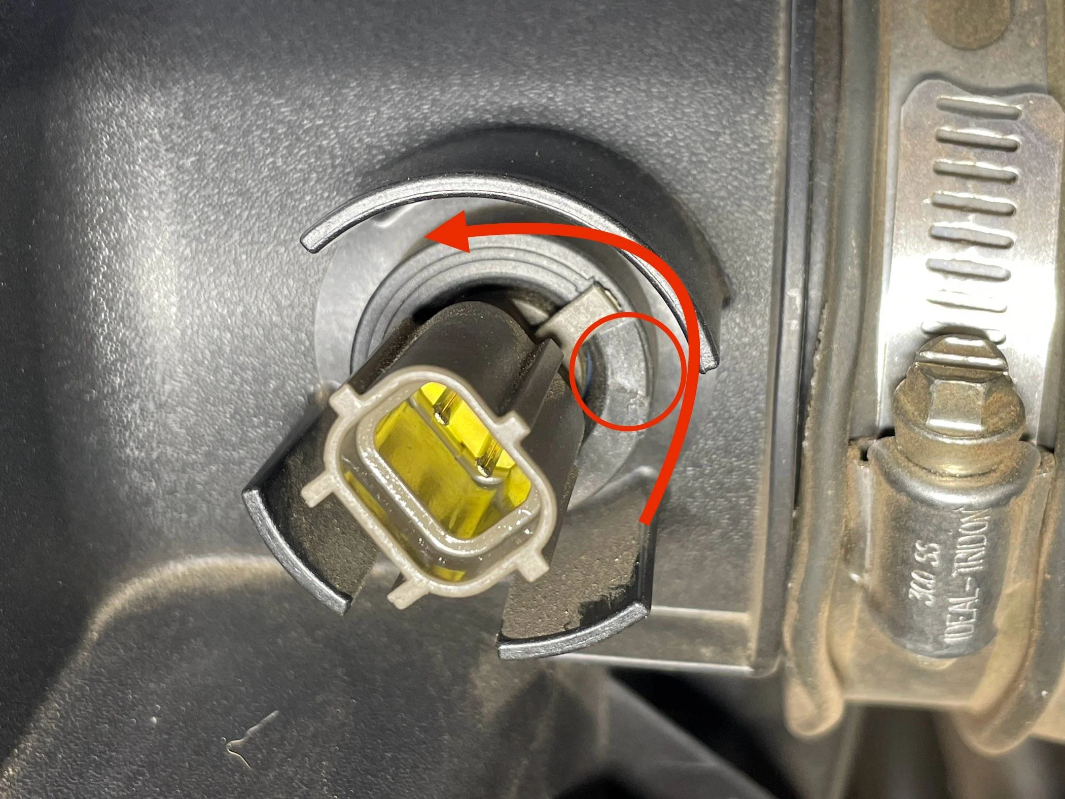

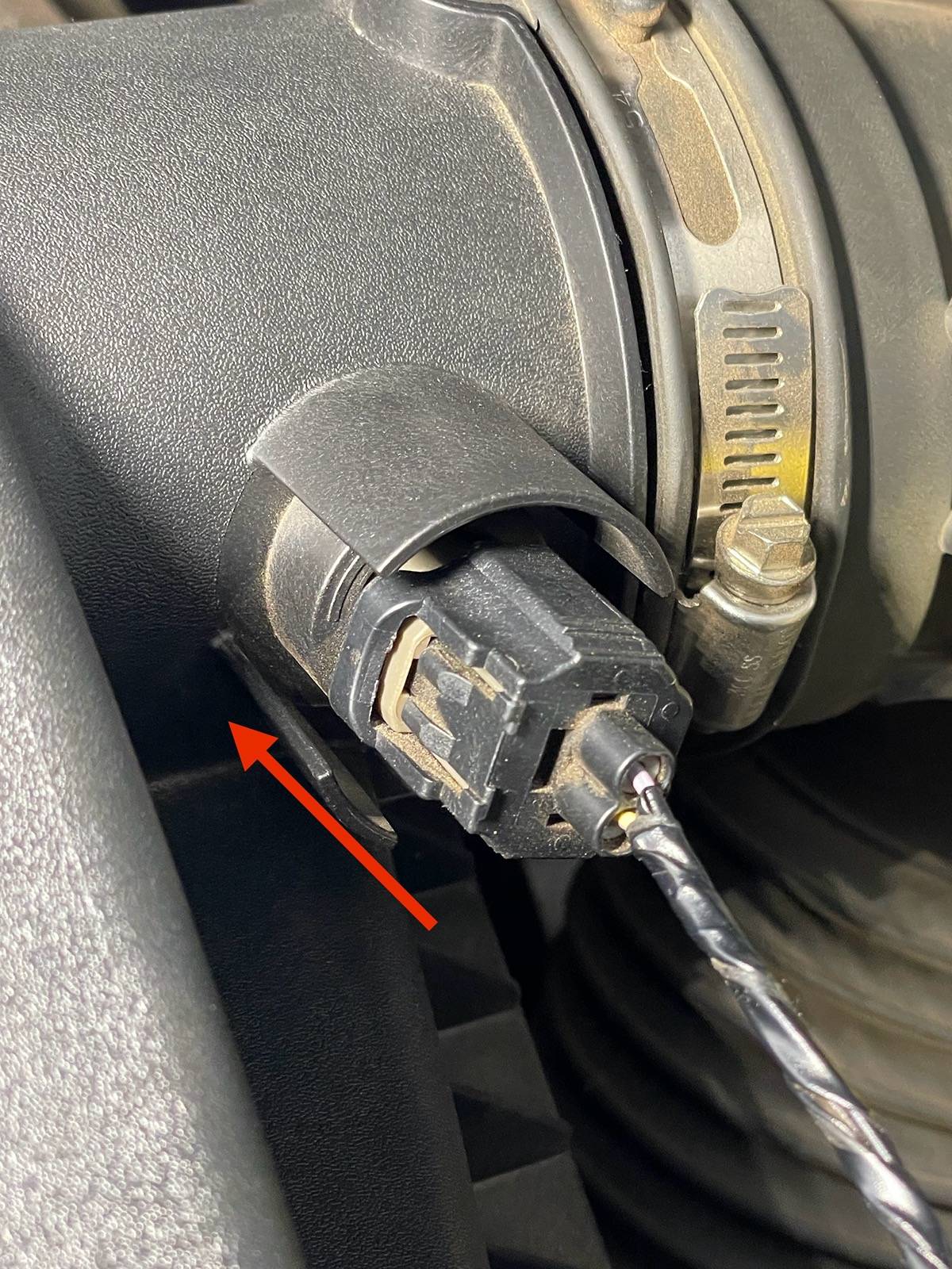

Use a small flathead screwdriver to gently pry the plastic tab on the bottom of the IAT upwards over the "hump" on the housing (circled). Once you have the tab pried upwards, turn the IAT counterclockwise to disengage it from the housing for removal.

Once you have the tab over the hump and rotated about 45 degrees clockwise simply pull the IAT towards you to remove it from the housing.

Reverse what you just did to install the new IAT. Line up the tabs on the IAT with the tabs you will be able to see inside the Air Cleaner assembly and insert the new IAT. When you insert the new IAT fully turn the IAT clockwise about 40-45 degrees until that plastic tab on the bottom locks in under the "hump" on the assembly.
