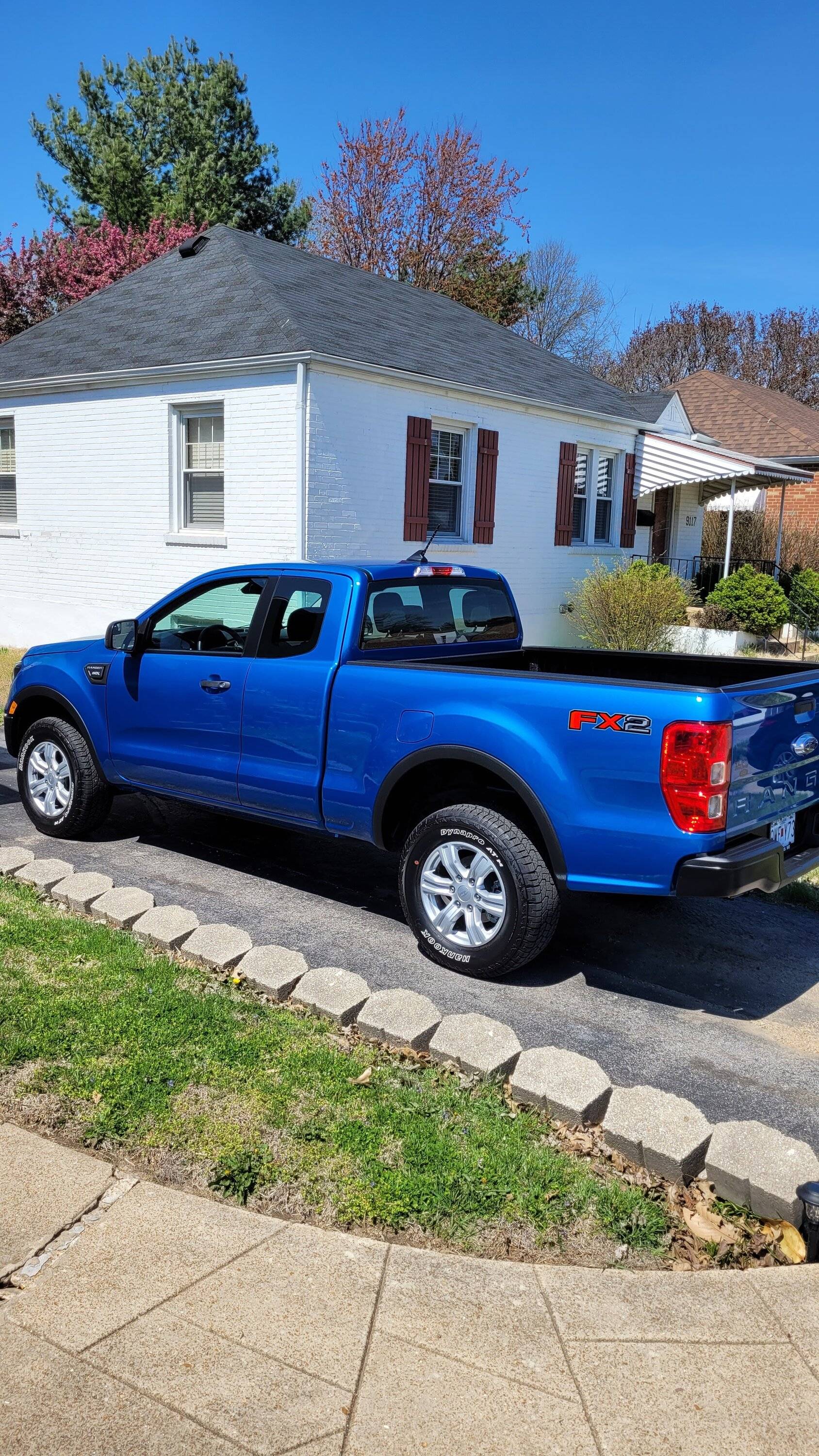

I bought a 2019 SCab after selling my 2020 Crew. This 2019 is very peppy compared to my 2020. It also gets a little bit better gas mileage, maybe due to less weight. I run in D or Tow mode, to see what gear i'm in.
I wonder if it has a Ford or aftermarket tune. I don't think so, the truck looks 100% stock, it's just quicker.
Can Forscan detect/reveal a different tune than stock. Can It show a programming # or some data that shows its stock?. have only used forscan to change software settings. I have not used any of the diagnostic features.
The new ride.
New ride looks great! The increased MPG is probably due to the window air deflectors. lol
Thanks. the deflectors are still on for now.
