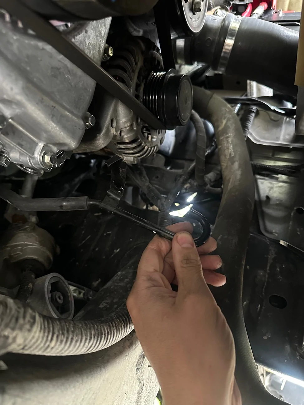

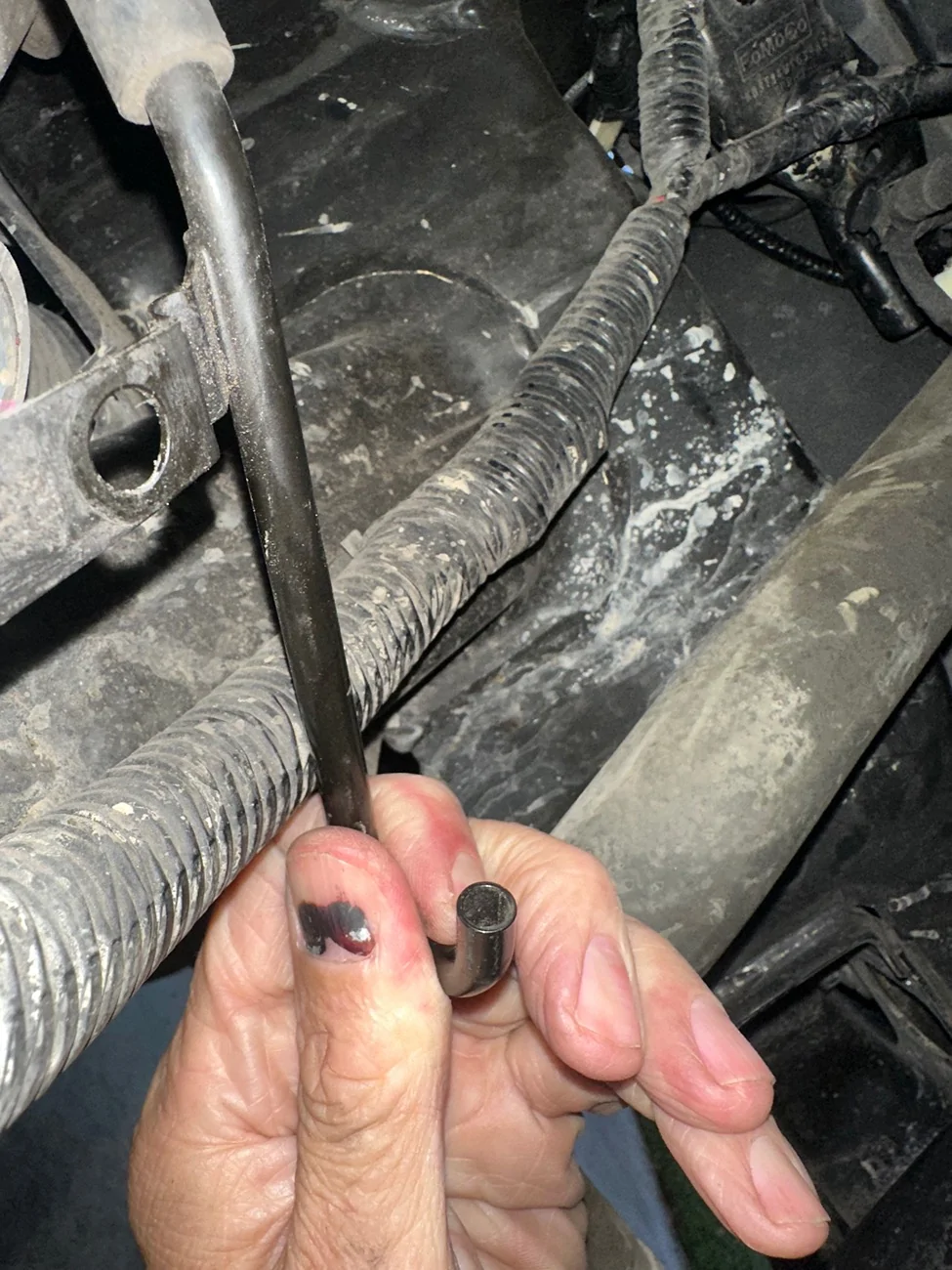

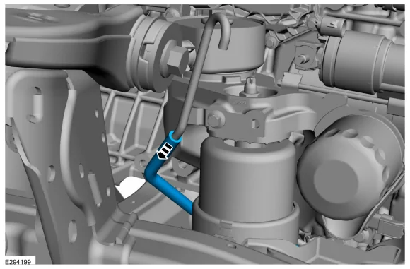

Does anyone know what this disconnected tube dangling off the bottom of my engine is?
silversurfer
Sep 19, 2020
145
Long Beach, CA
2019 Ford Ranger XLT FX4
Caruso ford in Long Beach installed a new motor in my truck incorrectly and it doesn’t run. Long insane story I will post here in the future… but in the meantime I’m trying to work my way through the existing issues to get my truck running again. They said my pcm was fried so I installed and reflashed a new one. Same codes. Some sort of electrical issue and I’m starting with replacing the exhaust back pressure sensor. When I was poking around I noticed this random disconnected tube dangling off the bottom on the engine… what is this thing??
It is the breather for the front differential. See below.

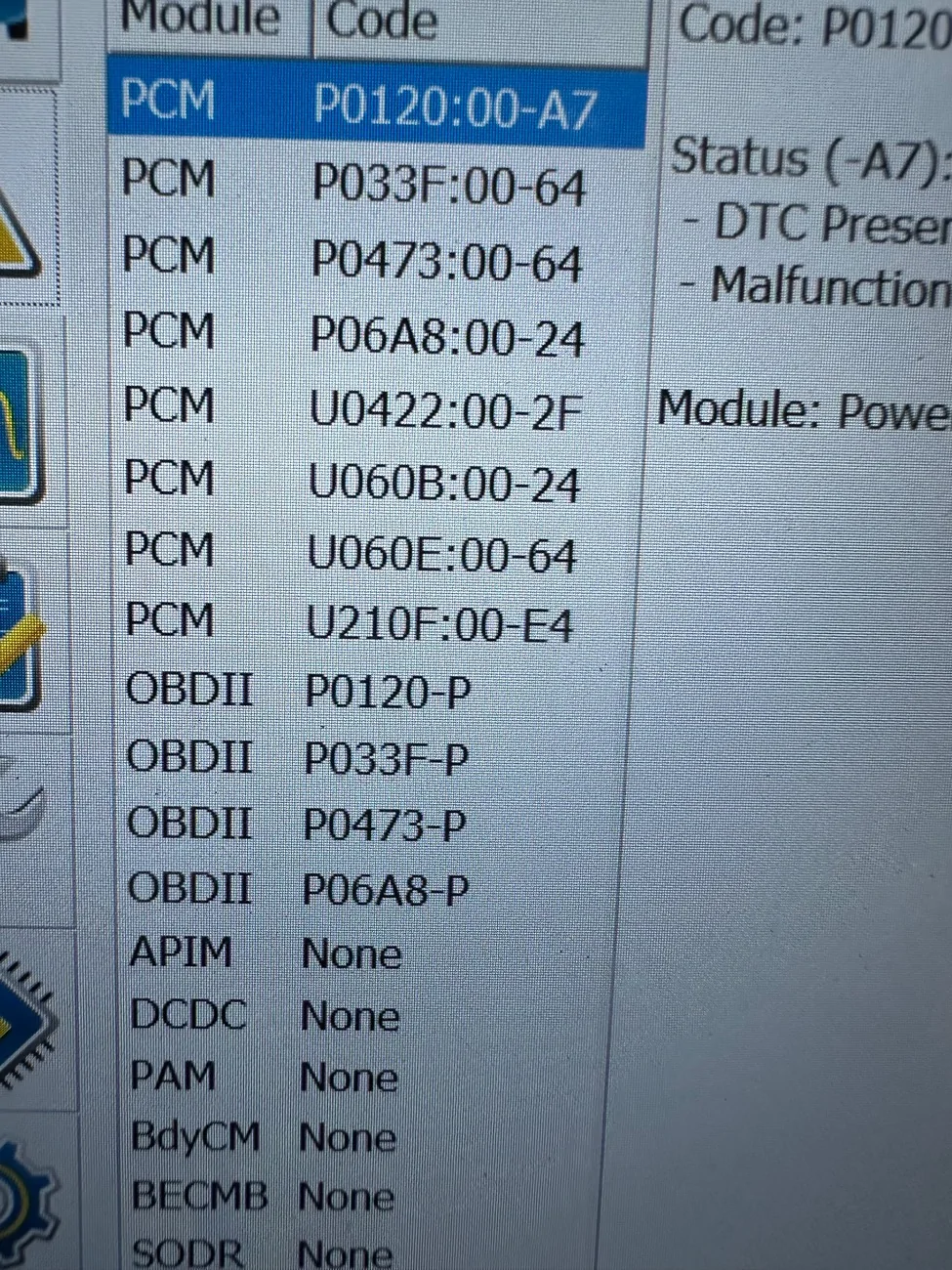

Post the codes you are getting and what specific issues you have with the engine

engine starts low idle misfires like crazy. Flashes a bunch of warnings.

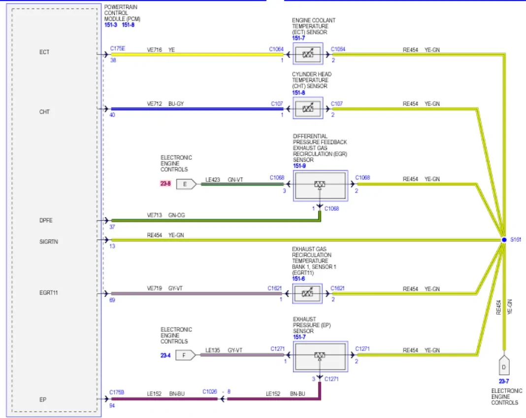

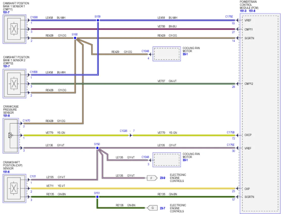

Your P06A8 code indicates a VREF short to ground. The VREF wiring is routed to many sensors and may be pinched somewhere. Here is a list of your fault code meanings from the shop manual. The VREF wiring is common to both the crankshaft position and exhaust pressure sensors, so it may be shorted to ground or faulty. Check that wiring to both sensors.
P0120 - Throttle / Pedal Position Sensor / Switch A Circuit
Description:
This DTC sets when there is a concern with the electronic throttle control (ETC) throttle position signal.
Possible Causes:
  • Damaged TP sensor
Diagnostic Aids:
This concern exhibits a symptom of limited power.
P033F - Crankshaft/Camshaft Loss Of Synchronization
Description:
This DTC sets when the input signal from the crankshaft position (CKP) sensor or the camshaft position (CMP) sensor is erratic.
Possible Causes:
  • Damaged CKP sensor
  • Damaged CMP sensor
  • Base engine concerns
  • Harness concerns
Diagnostic Aids:
Check the harness for routing, alterations, incorrect shielding, or electrical interference from other systems.
P0473 - Exhaust Pressure Sensor A Circuit High
Description:
This DTC sets when the exhaust pressure (EP) sensor signal is greater than the self test maximum.
Possible Causes:
  • SIGRTN circuit open
  • EP circuit open
  • EP circuit short to voltage
  • Damaged EP sensor
  • Incorrect harness connection
P06A8 - Sensor Reference Voltage C Circuit Range/Performance
Description:
This DTC sets when the VREF circuit is not within a calibrated voltage range.
Possible Causes:
  • VREF circuit short to voltage
  • VREF circuit short to ground
  • Damaged sensor
Diagnostic Aids:
Check for other DTCs. Diagnose all other DTCs first.

Thats a breather tube

With those codes I would be running the harness visually and by feel everywhere that engine R+R would require disconnecting or mving aside a harness. Don't forget the bellhousing area, that's a favorite place for a butcher to sandwich wires on installation.
airline tech
Aug 24, 2022
4,500
8,593
Midwest - KS
Aircraft Tech
From the initial history - and so many codes.
Yes, the (Exhaust Press Sensor) is a good place to start - Possibly coated with coolant and internally shorted from initial coolant leak.
A good check is pull up the Barometric PID and compare it to:
Exhaust Pressure and MAP Pressure - Reading @ KOEO - They should all (MATCH)
However, you have a PCM (Calibration) code P06A8 that may be throwing off the learned Barro, so use your Phone (Weather) App and find current Barro Pressure
If it lists it as (InHG) - Example: 29.92 In HG - Multiply by 0.49115 = 14.7 PSI, this will be the true Barro reading as the PID will most likely be in PSI
From there it's down to wiring checks (meter) to isolate it down - if that does not cure some of the codes.
You have a lot going on - and I think the main issue lies within the VREF for the Exhaust Press Sensor and its associated shared circuit.
