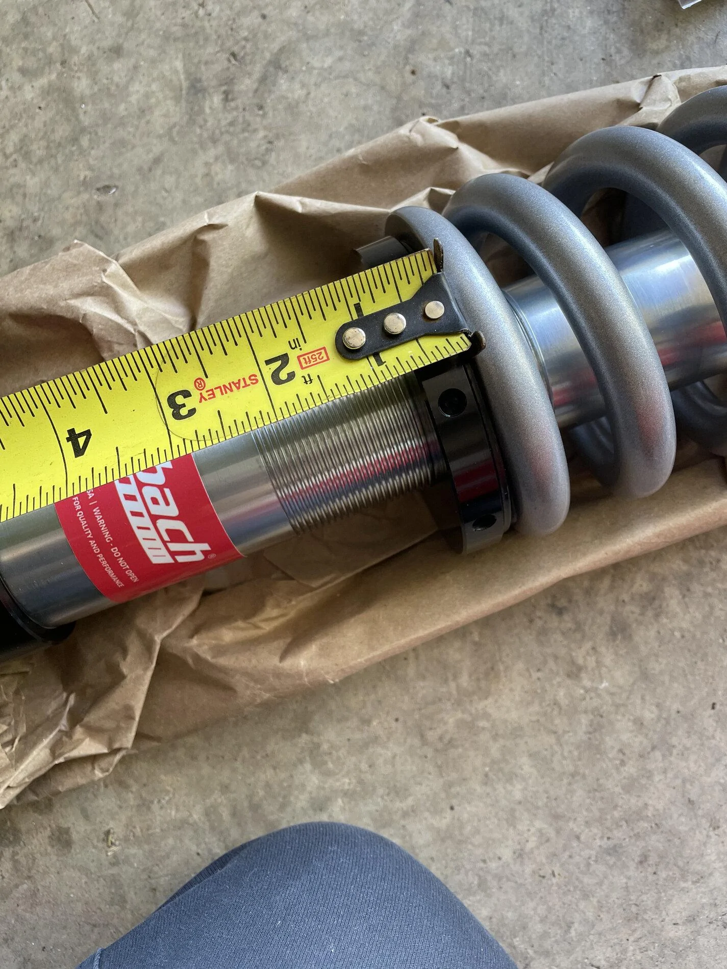

Not sure where exactly you measure from bit if it's from the furthest edge of the spring, it's at 2.25? Is this the correct measurement?

Any chance you can show a measurement from mounting surface to mounting surface ?
I am curious about the overall length compared to stock.
I believe these come factory set at 2 inches above stock height.
Adjustments are basically a 1:2 ratio. Compressing the spring another 1/2 inch will result
in 1 inch of lift.

I called Eibach. The way this is set up, it is at level..or 3” lift they say. I cranked it up a few turns and gained about 3& 1/4

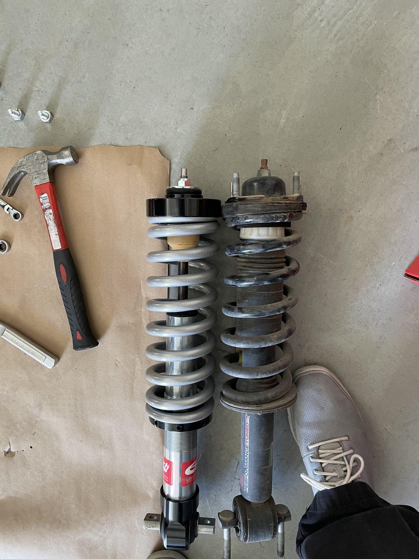

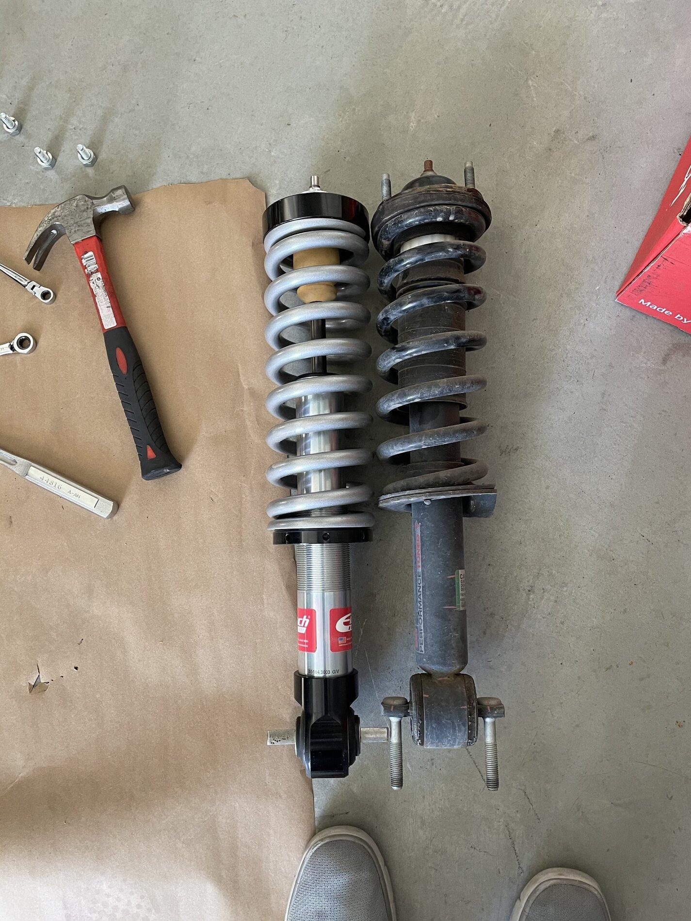

Metalshift, Here is a pic of mine before I installed them. Hope this helps

Thanks for the pics. It looks like they are about one inch longer and should result in 2 more inches of down travel.
