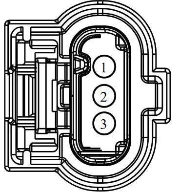

Ex Pressure Sensor - Connector (Ref)
Pin 1 = VREF
Pin 2 = Signal Return
Pin 3 - Signal to PCM

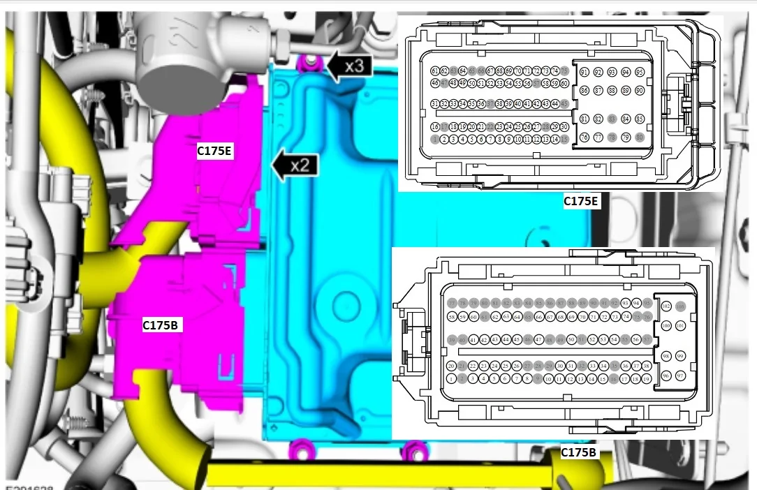

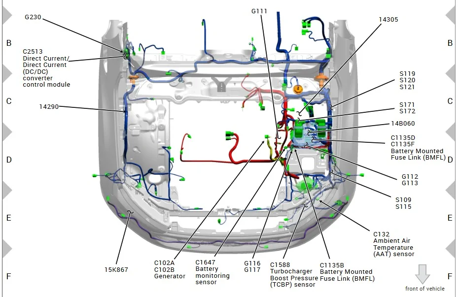

I think it may be good idea - (for confirmation) to move outside the box and check all the PCM Grounds
The PCM has (4) Ground Wires that feed into (G117) and G117 also has via (splice) the Brake Pedal Position Switch
Check this (Ground Point) G117
Check the contacts at pins 96-97-98 and 99 on C175B
If you can get the cover off - Key (ON) and back-probe each pin to G117 (Voltage Scale)
Red Lead to (Pin) - Black Lead to G117
and
Then check G117 to Battery Negative
You want (Near-Zero) readings
This is to ensure that the PCM is providing a good ground for the signal return circuits
also check - since you are here -
Check all 3 PCM Power Feeds
C175B - Pins 100-101-102
This will verify we have good power to the PCM itself @ all 3 pins
I truly suspect the issue lies in the Singal Return or Ground path as being the most likely.
This is just me - Brainstorming and thought about the PCM grounds, more so the G117 and the PCM connectors were disturbed during engine removal - the contacts can easily be pushed in or damaged
Hopefully - you can get it isolated

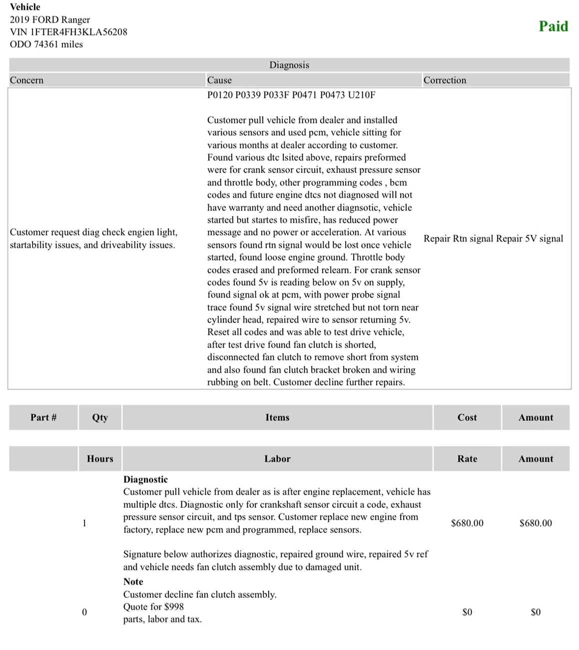

got it running smooth after I hired a mechanic. He solved in 1 hour what Caruso Ford could/would not in 3 months. I still have to replace the shorted fan clutch (got one coming from eBay for $250 instead of $750 from dealer). I’m gonna try to return/resell the $150 salvage pcm I had installed as my original pcm was fine (good thing I didn’t pay Caruso $3k to install new pcm like they wanted). I’m just waiting on the guy to come back and re-run the immo reset on my old pcm which I swapped back and I’m good to go.
*edit - I also need to buy a new battery since Caruso fried mine somehow. And I might buy another engine cover because Caruso threw mine away.

It's highly likely imo this damage was caused by the dealer during engine installation. I know for certain that they thrashed a lot of other stuff during installation like the 2 wire harnesses belonging to my lightbar which were ripped off of their connection points on the battery by them:
This definitely wasn't like this when I brought the truck in. First thing I did when I pulled over is disconnect the battery and reconnect. I inspected all of this stuff and it was all in tact.
The way I discovered this stuff was after engine installation the dealer contacted me that the acc module was missing... so I told them it's not missing, it's relocated a foot higher up from it's standard location. They still couldn't/wouldn't find it even after I sent them actual photos of it's location but they found the disconnected wire connector for it. I come into the dealer and see this connector dangling down underneath the vehicle and I plug it back in for them... that's when I look up top in the engine bay and see the lightbar harnesses thrashed.
It seems to me that if they caused all this damage (and the other engine wiring issues) it's plausible that they bumped the exposed fan as well... I've never seen alerts for the fan in the past.
Anyways, thanks again for all of this diagnostic info @airline tech @RangerBill @diesel924 and others. I'm not a mechanic and it all seemed like such a mess I just decided to hire someone. I am going to pursue small claims route soon here... I just keep finding new stuff that they screwed up or left incomplete... I went to put the skid plate back on last night (they gave me truck with it off) and there is no hardware for it... I'm still trying to figure out how to attach that diff breather to the new motor in the correct spot... need proper bolt for that too.
But truck is running smooth now and only throwing the one code of the disconnected fan. Should be fine to drive around in the meantime without that connected right? It seems that the fan defaults to high speed in this case?

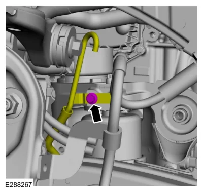

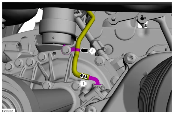

These may provide a better visual (guidance) for the Breather Tube
Lower Bracket (Clamp)
Upper Bracket - note routing
and this is viewed from the driver's side wheel well - same access as the oil filter

I was able to access and attach easily through the side in the wheel well. Thanks for the images!
