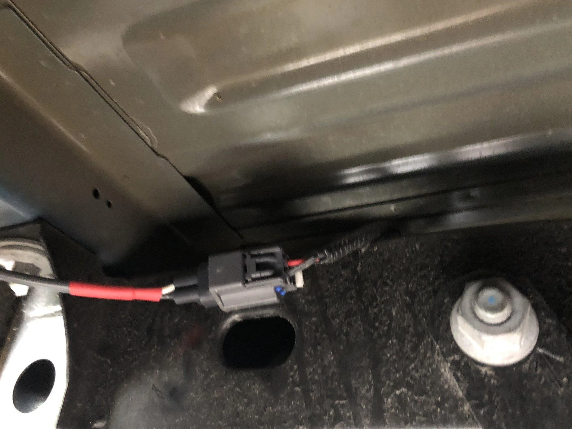

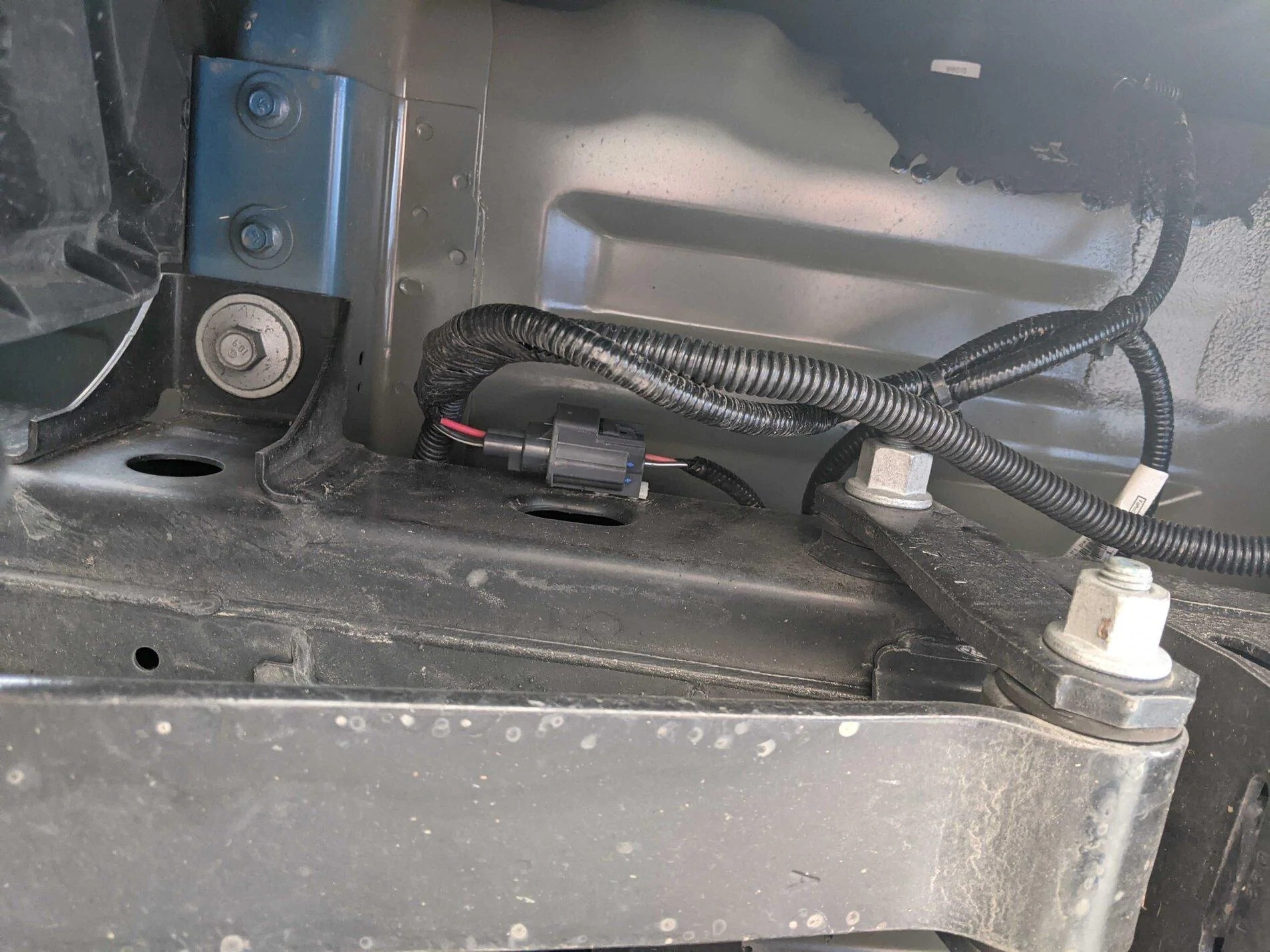

Just a quick question, I got the harness and the plug from Ford. I can't find the plug under the vehicle, I have a November 2019 2.0 Turbo D/C XLT. Who can tell me exactly where to find the connector? My car is right hand drive.

On our trucks the connector is attached to the frame behind the rear wheel on the drivers side.

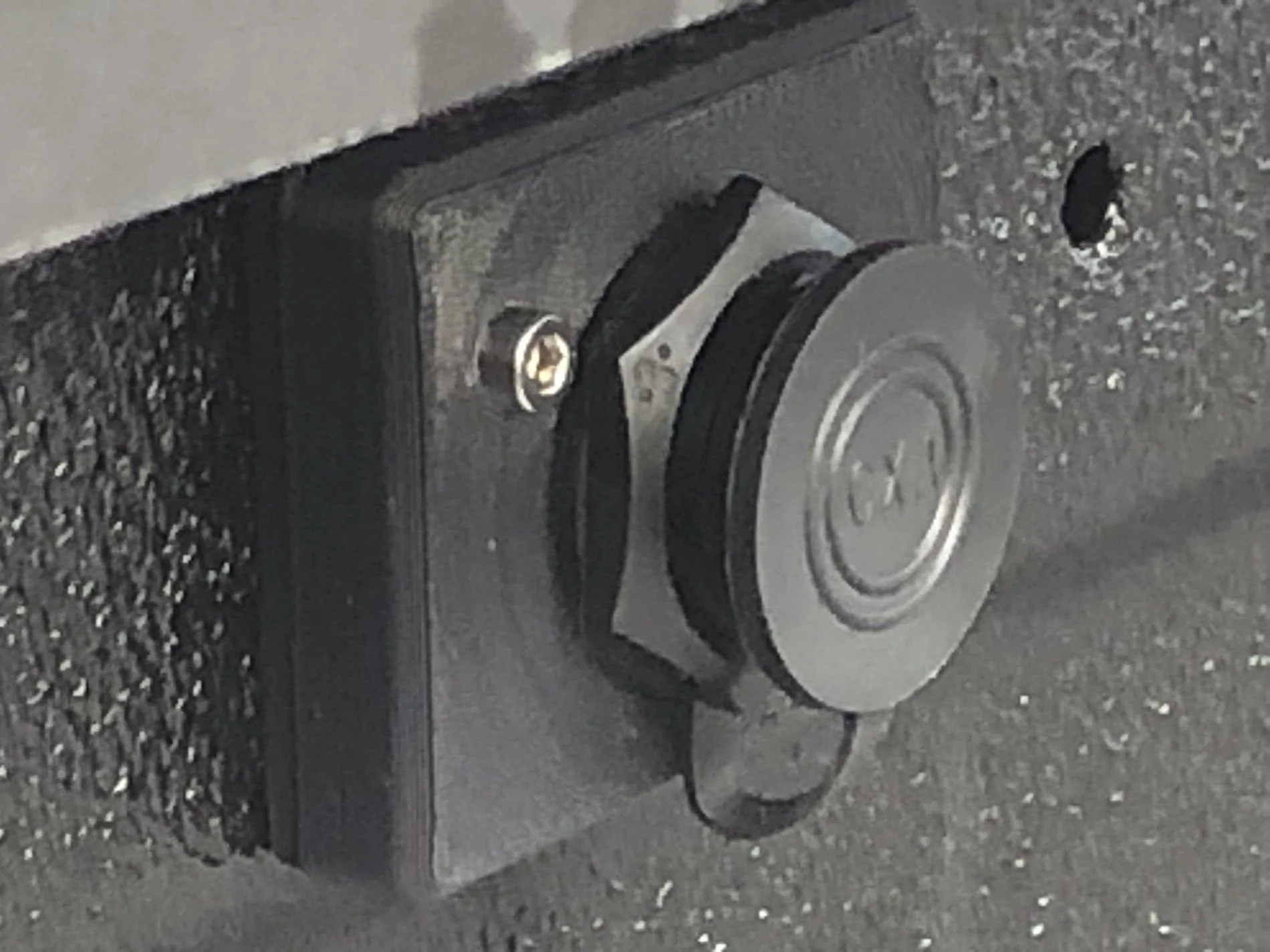

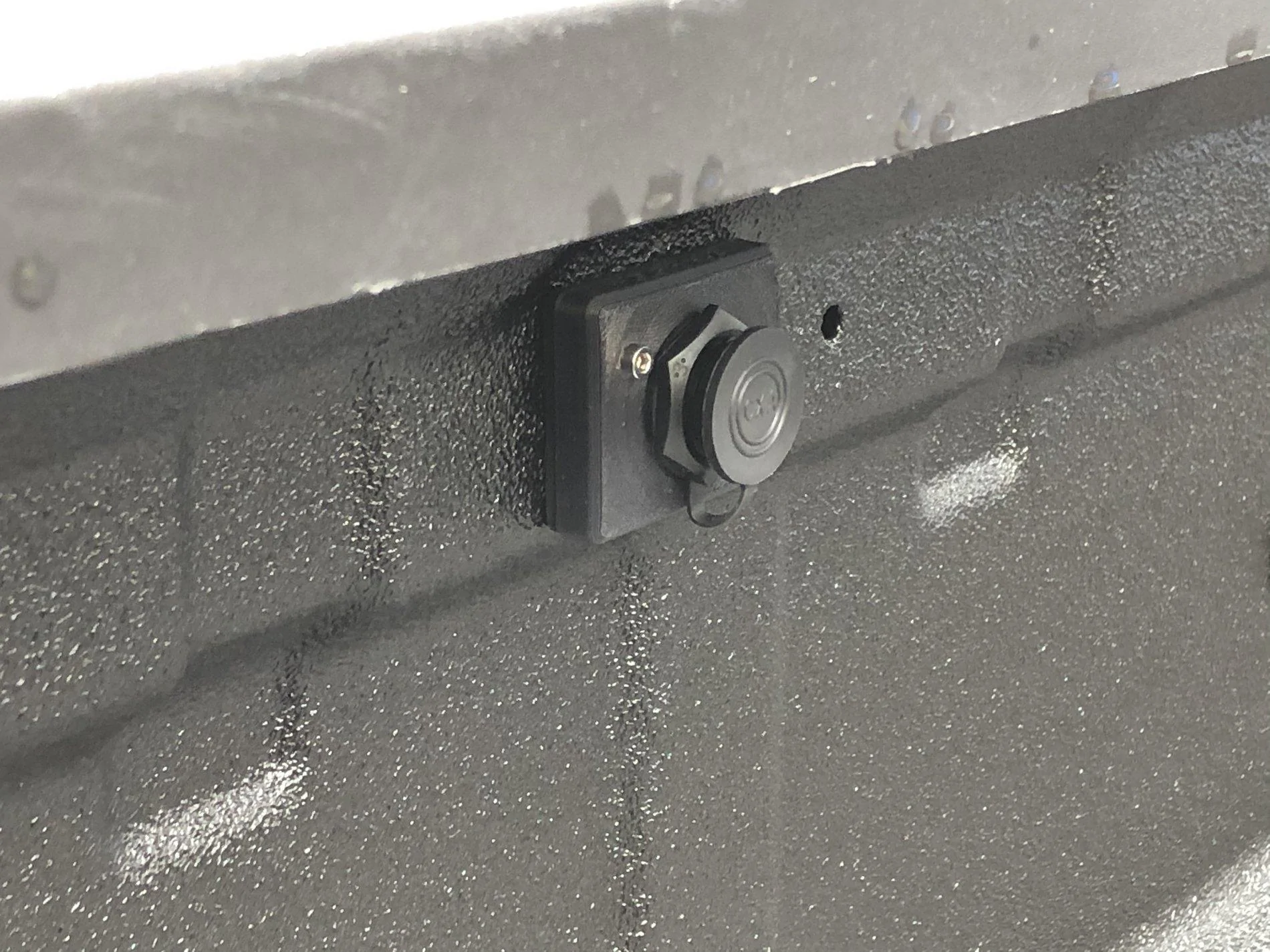

I was also able to install the Wolfhaus 12v Outlet in my Ranger’s bed. It is expensive. The quality of the outlet, wiring and a 10 minute install time makes up for it.
it is extremely easy to install. I have had some health issues that limit my endurance, flexibility and strength. However, don’t feel sorry for me, it is an opening to spend more time with my daughters and son working together. We get more time together and I get to feel like in some small way, I am teaching them about tools and how things work! Below are some pics of the outlet in the bed. I also included a pic of the install process with my daughters! Great time!

You should have the pick up box lead just above the left rear wheel on the outside of the frame. However this power point is on a timer that turns off after 2 hours, so for continuous power you will have to tap the battery of the Ranger....I caution you as if you drain the battery, you will have a no start condition and you are likely going to be stranded. That said, what is your power draw of your leds?. Do not understand "some cooking" in an annex...you mean illumination? Again what is the draw? How many days are you going to be out? You can run the engine every day to recharge the vehicle battery but at idle the charging is very slow.
Let us know what your specs are and we may be able to assess this a bit better.

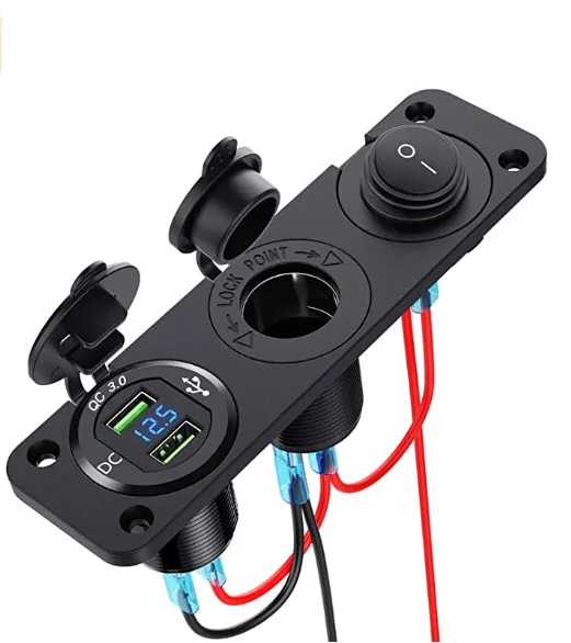

Not sure what the current draw is going to be as I haven't purchased the lights yet, Probably 5v 2.1A. I could live with 2 hours. Most trips will weekenders and no problems running the car for a few hours if needed
I may be doing some cooking inside the tent annex in inclement weather and just need some lighting there.
My bed rack has 4 x 20W LED lights in it
I want to install something like this (but waterproof):
