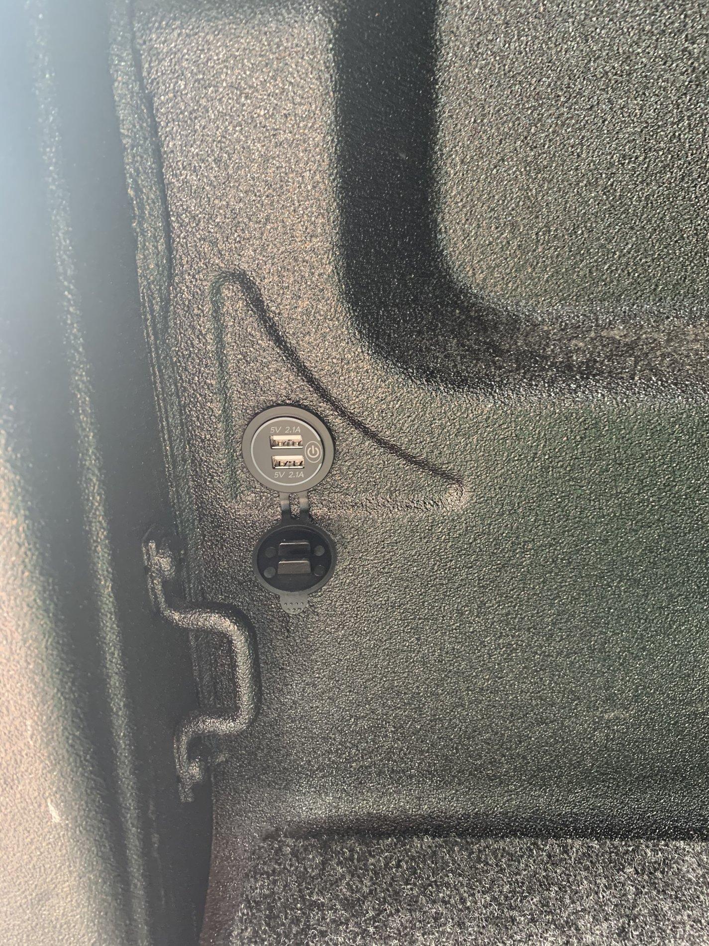

I used the Wolfhaus plug and a cheap USB port ordered from the big river site, works great!
That's a nice idea, but personally, I wouldn't bother installing anything less than 3.0A USB ports these days. I had 2.1A ports in my camper that I had to replace, because my LG phone wouldn't charge right on them (it'd flicker all night, and make the little chirp it does when it wakes up).
After doing a river float with some friends yesterday, I really could have used a power point in the bed for an inflator, so I'm planning to get the Wolfhaus kit. If I need USB ports, I've got a 3.0A cigarette lighter/USB adapter I can throw on.

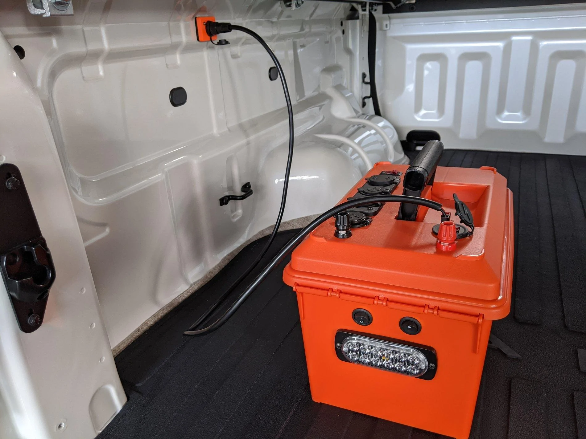

I went with the powerbox method. I can use the Wolfhaus 12volt connection so I can save the battery power in the powerbox.

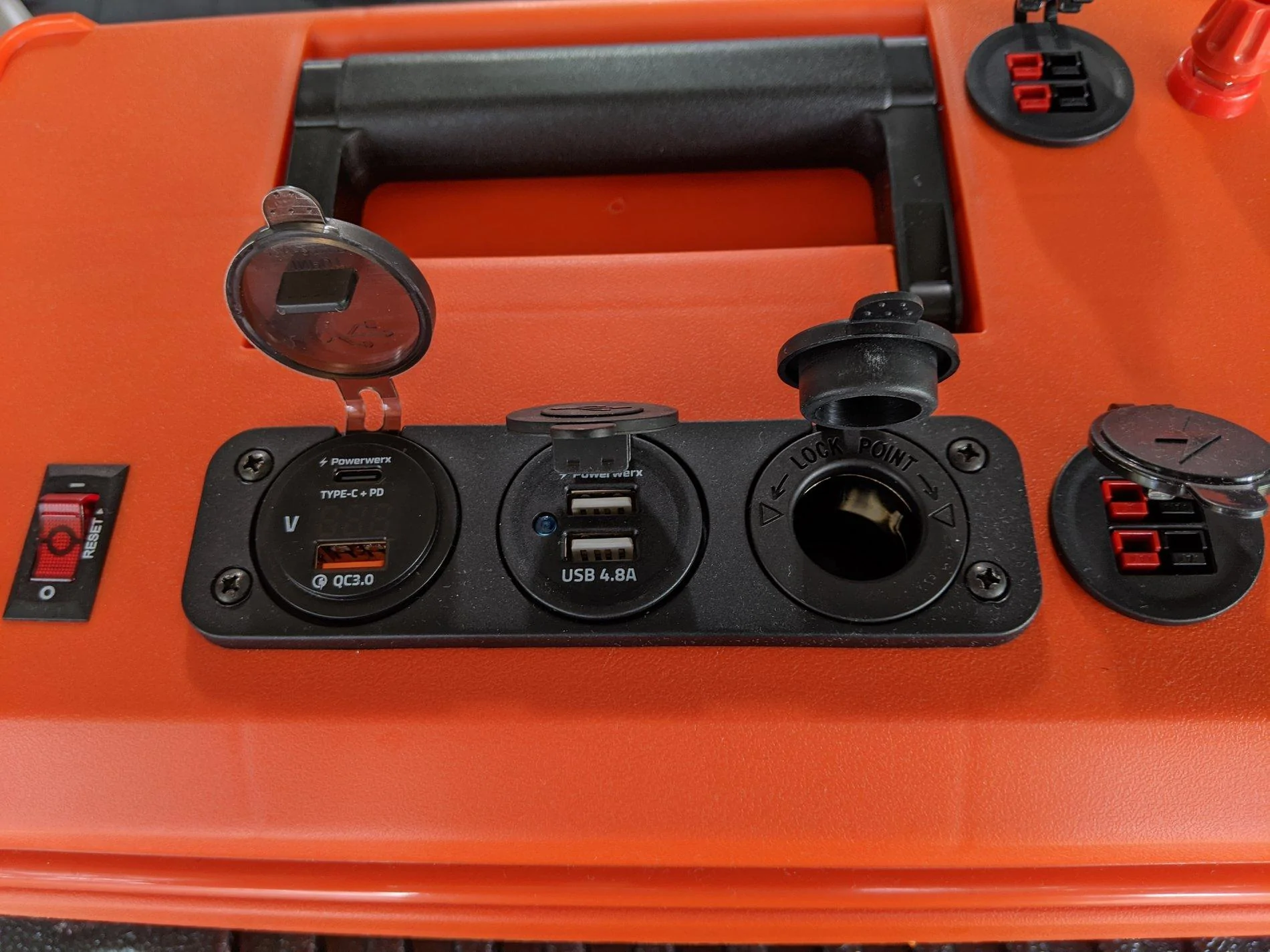

It has ALL the USB connections, (QC3.0 USB and USB-C + PD) 12 volt socket, Anderson powerpole connectors, a heavy duty M6 binding post, (that accepts 1/4" ring terminals, banana plugs or bare wire) and an LED light with 15 different strobe functions for emergencies.

That thing is really cool. I've never seen anything quite like that before. Do you have a post somewhere describing the build? Does it have a battery inside?
If not, I might consider trying to do something similar in a thinner case that I could slide behind the backseat for storage.

Yes, there's 2 batteries inside running parallel. The Powerbox is designed to run off of Lithium Iron Phosphate batteries. But they are VERY very expensive. ( one is nearly $700) So I did some modifications so it can use lead acid batteries. All I did was remove the large power adapter and placed the smaller Anderson powerpoles. All I want to do is charge up my phone and use the light for emergencies.
Head to this site. ----> https://powerwerx.com/ You'll be like a kid in a toy store!! :p
Here's a direct link to the powerbox.
https://powerwerx.com/megabox-portable-power-box-bioenno-batteries
If you want to build your own, There's a few on Amazon I recommend.
https://www.amazon.com/gp/product/B003DJUXES/ref=ppx_yo_dt_b_asin_title_o00_s00?ie=UTF8&psc=1
That one above has a lid to hide the panel mount USB ports. And it has a tray inside.
This one below is smaller. It comes in many colors.
https://www.amazon.com/gp/product/B07BWTMC6J/ref=ppx_yo_dt_b_asin_title_o02_s00?ie=UTF8&th=1

Oh, cool, it's a pre-made thing. It looked total DIY. Yeah, this sort of thing is a little bit more advanced on the electronic side than I'm comfortable with. I'd definitely prefer if the whole thing could fit right behind the back seat of the SuperCrew. I may just keep my eyes peeled for a jump starter that has 12v and USB ports. There's enough of those on the market and I know a lot of them are really thin. I wonder if any of the ones with compressors would fit behind the seat.

There is plenty of DIY videos on Youtube. Problem is, some of those are very complex. And some don't even list the parts they used.
I don't have the time to build one. I found the one at Powerwerx and decided to buy it since it has everything I need. I could even run a small 110volt inverter from the 12 volt socket. That's why I have 2 batteries running parallel.

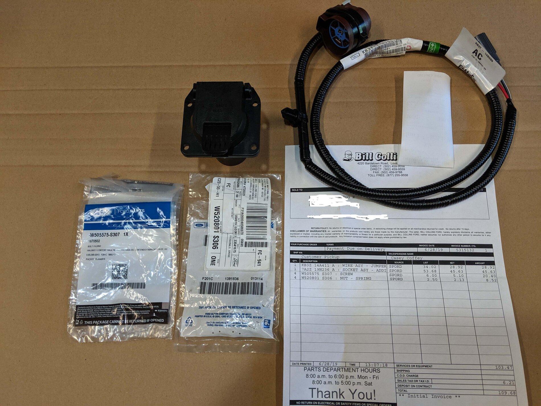

Can anyone confirm what connector you need to make connection at the open point under driver side rear? I see a few people went diy on the entire setup pretty much.

Here are the parts if you want to get the factory option,

It's a ford OEM connector that I can only order in bulk from a single parts supplier. I do however sell just a pigtail that is the connector pre-crimped to a length of wire for DIY solutions. PM for info.
