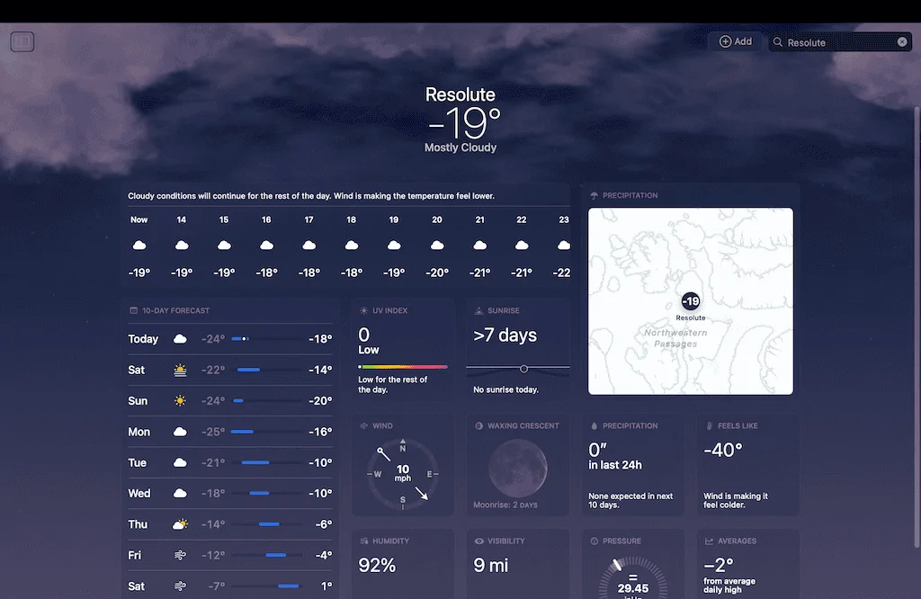

Current conditions at Resolute, Nunavut, Canada, F displayed. -29ºC. I believe it is the most remote place in North America. Not much there other than a really cold thermometer and uh, defense stuff.
Thanks up there, folks.
