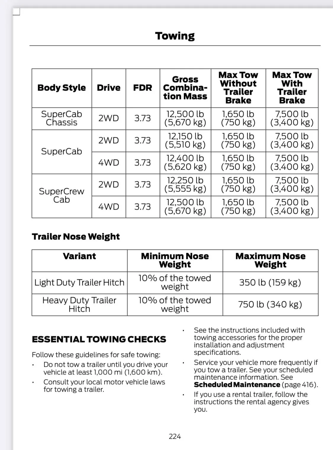

Payload is almost identical for either, towing is the same for either. 6 foot bed is better than a 5 foot bed...

Towing will not change between the SuperCrew and the SuperCab. 7500 pounds either way.
The SuperCab has ~100 lbs more payload capacity than the SuperCrew.
