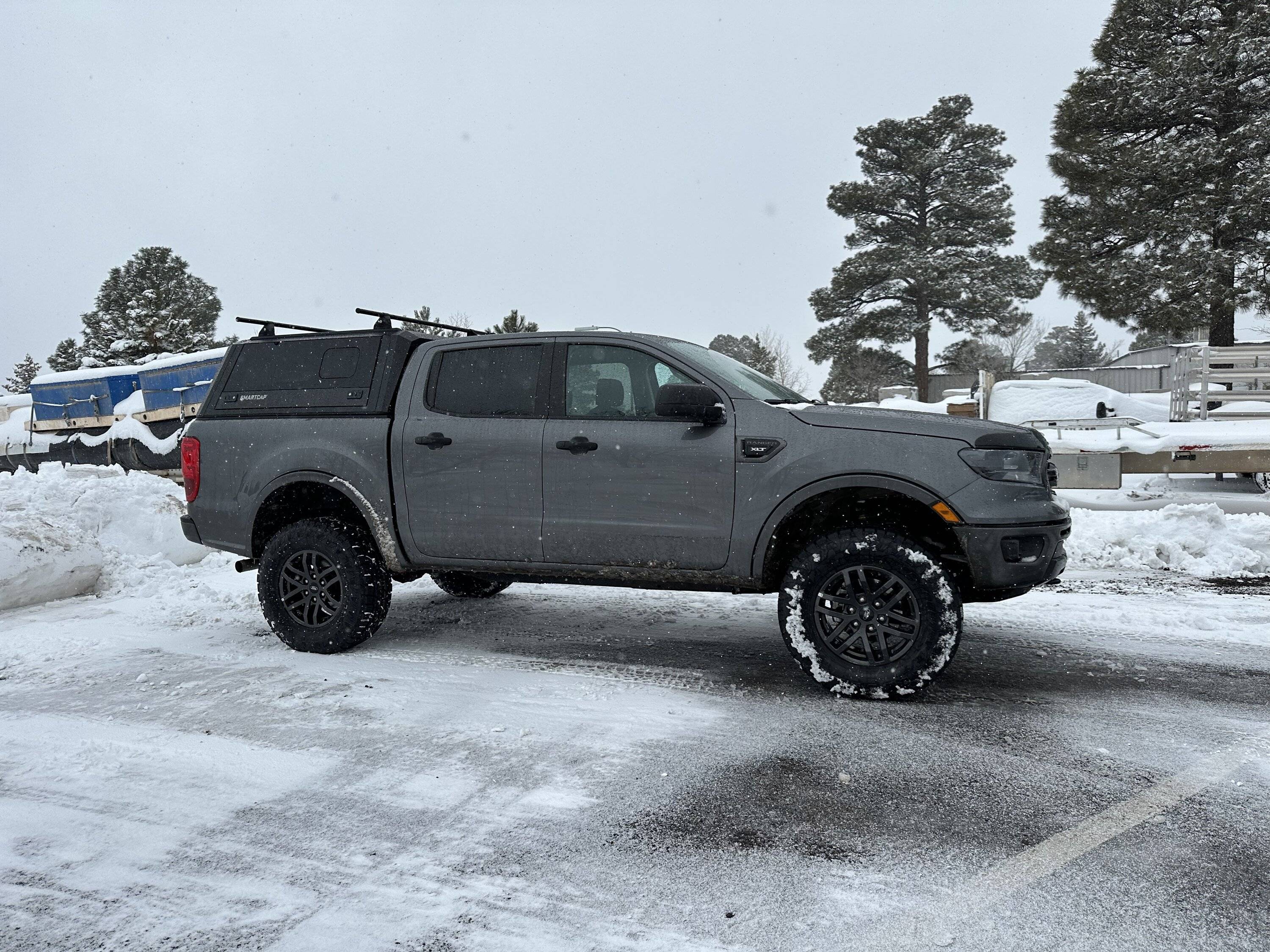

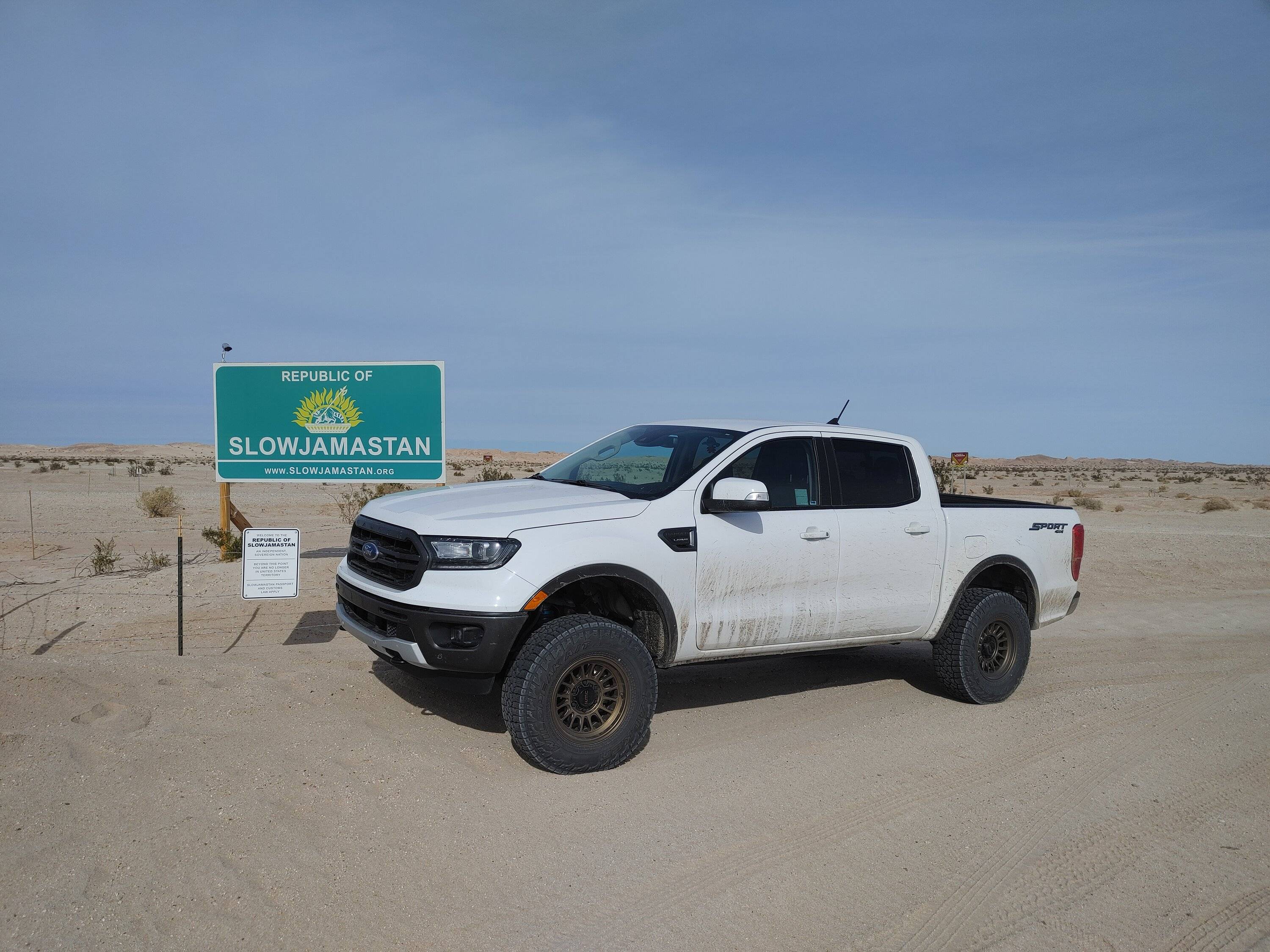

Can't speak for the Deavers at all but if you don't mind the idea of some lift then perhaps the Old Man EMU Leafs? The basic leafs will lift the rear 1.6 inches. With about 780 LBS it will come down about 2 inches. Depending on the tongue weight of the trailer(if towing the CanAm) you should.be fine with that and the truck will do well Off-road. The King Shocks I believe will have enough play for the extra lift and you won't have to change bump stops.
Here are pictures of the entire lift kit towing and unloaded.
