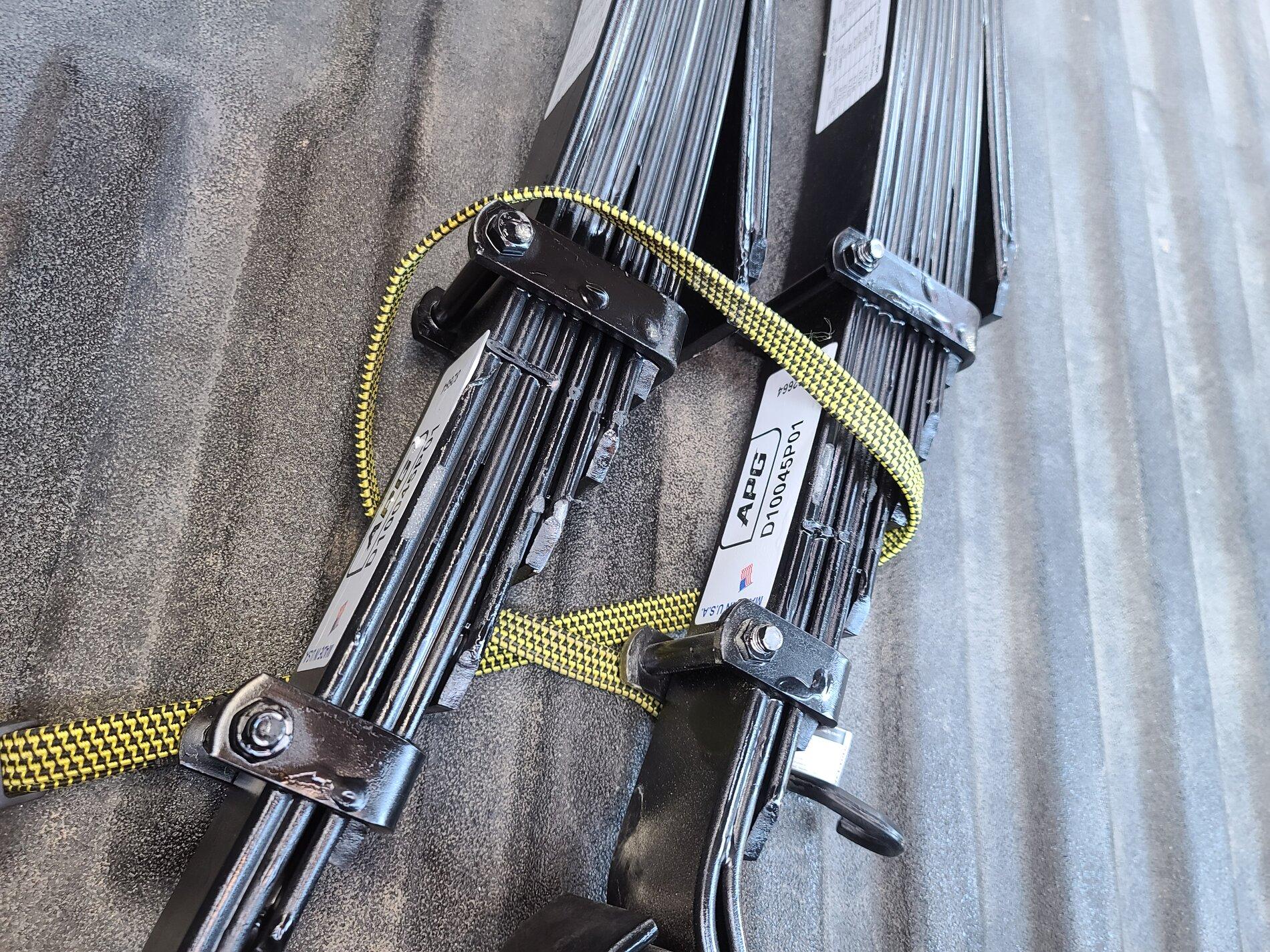

I should have these installed early next week along wtih a few other suspension goodies! Can't wait, and APG/Matt are awesome to work with!

Hi Phil,
I have ridden in a truck with the prototype Deavers and kings rear adjustable shocks. Ride quality is amazing on road and even better off. Really looking forward to getting this installed. Also, I have the heavy duty ones intended for rack/tent/camper/extra bed weight, so the leaf packs for the standard apg/Deaver might be thinner!

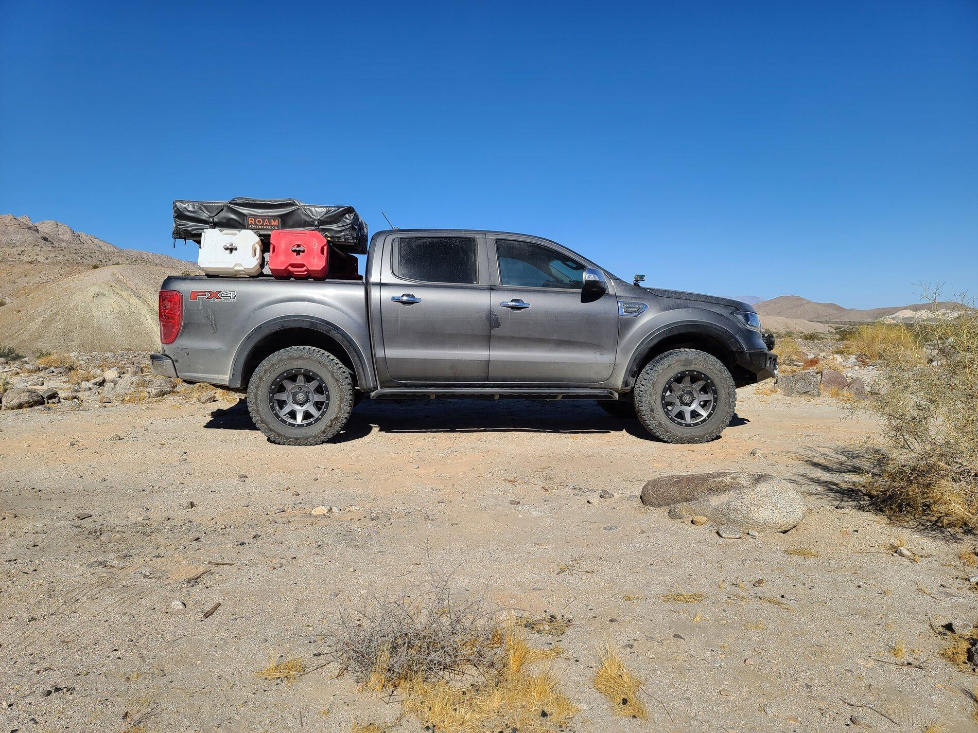

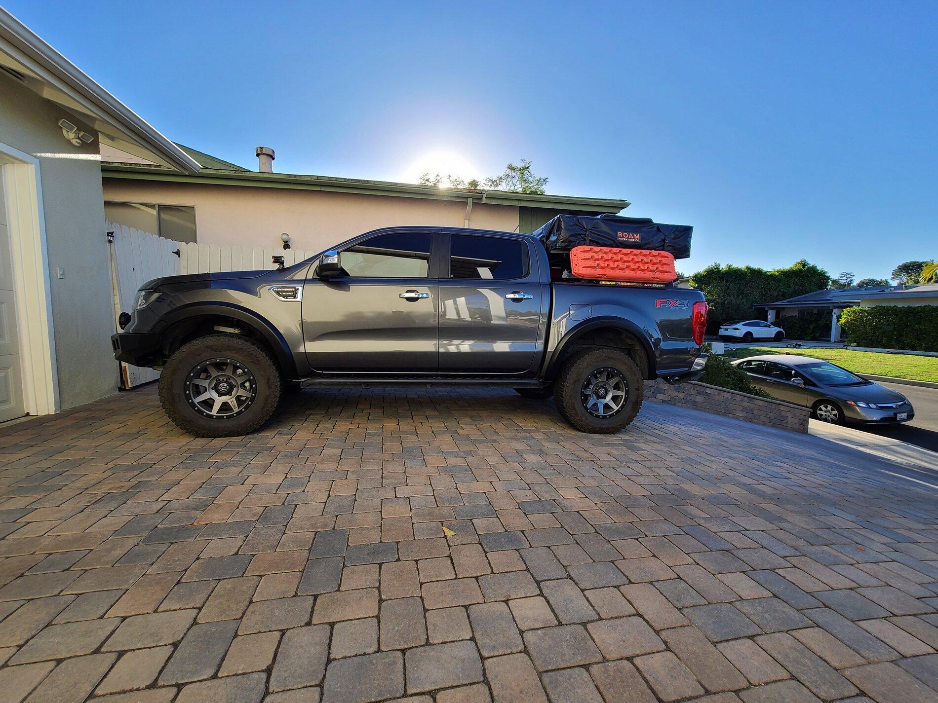

Here's a mostly unloaded Deaver pic versus a fairly loaded factory leaf pic
