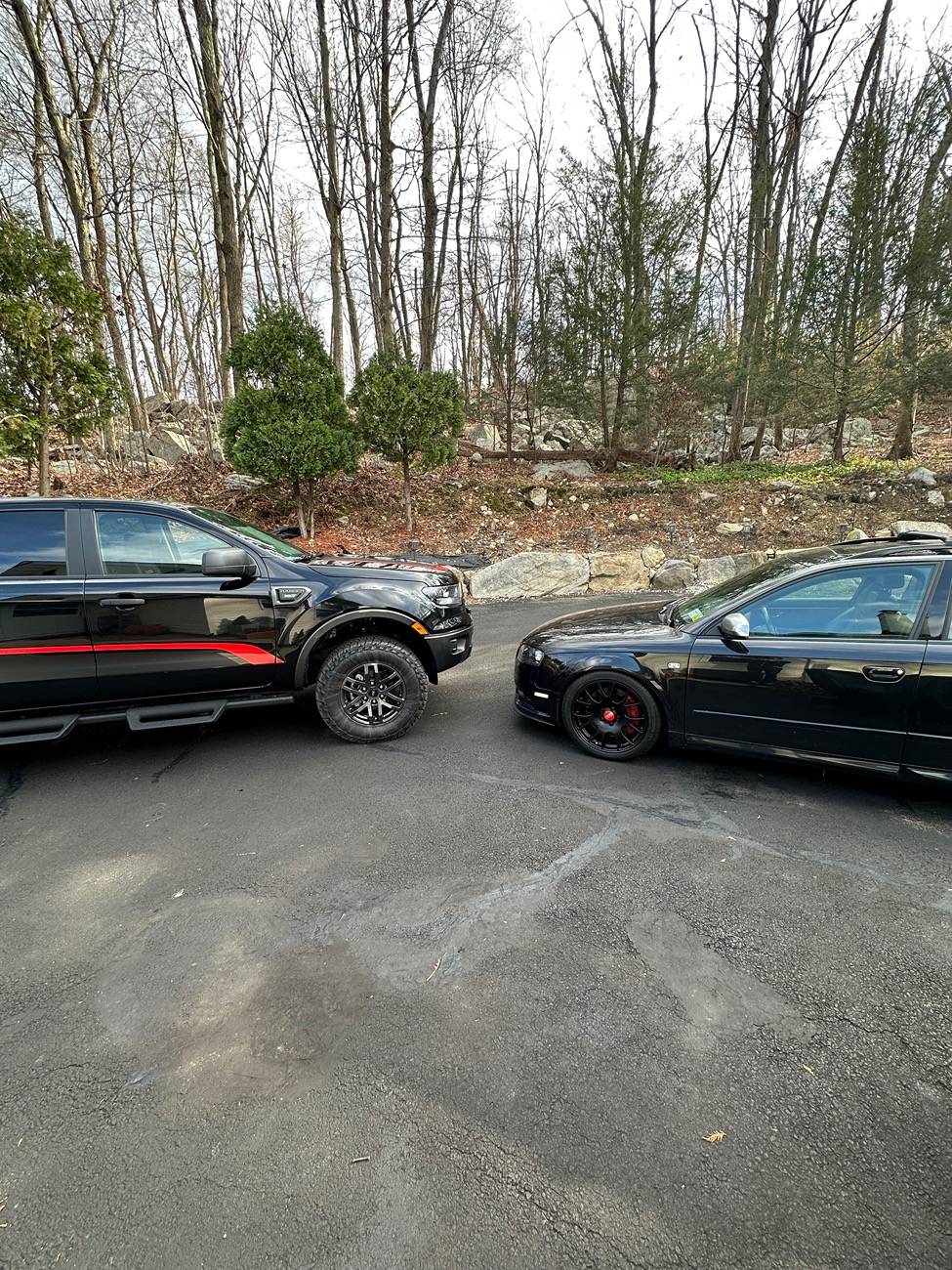

Been driving the Ranger like no one’s business and it’s been great to me.
Just noticed some small signs of rust on the frame around the inside of the wheel wells. Specifically on the rear wheel well on the frame where the circle weld is.
Is this bad?
Should i do anything?
Comparing this to my Audi and those things leak oil every once in a while effectively rust proofing the underside. Lol.
picture because why not.
