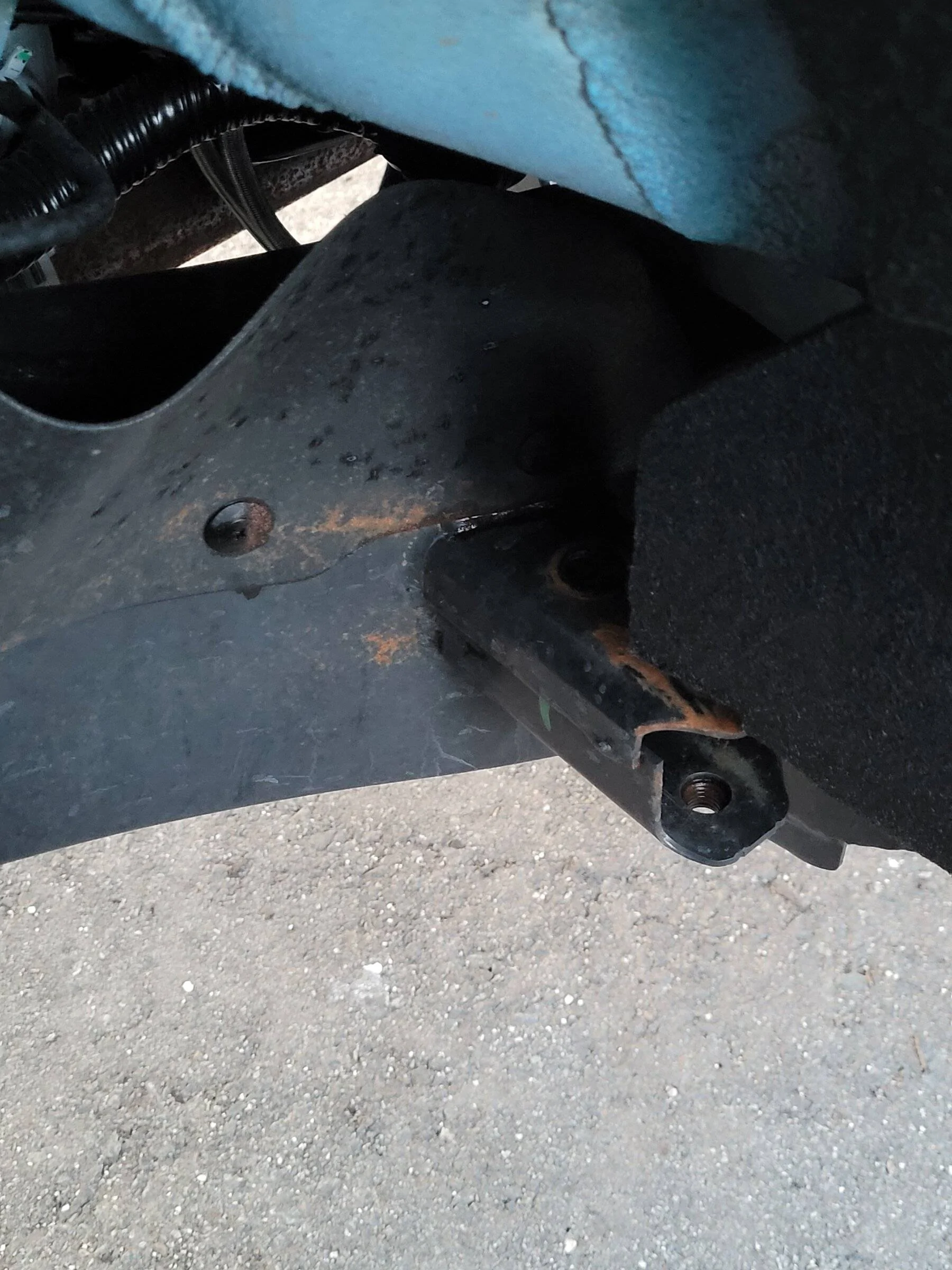

So after cutting out my crash bars I've noticed some surface rust in a few spots. I guess in my haste of trying to get the job done and get out of the shop, I (stupidly) neglected to clean dust the cutting wheel created from the area which turned in to some caked on surface rust. Can anyone recommend a product to help remove it? TIA.

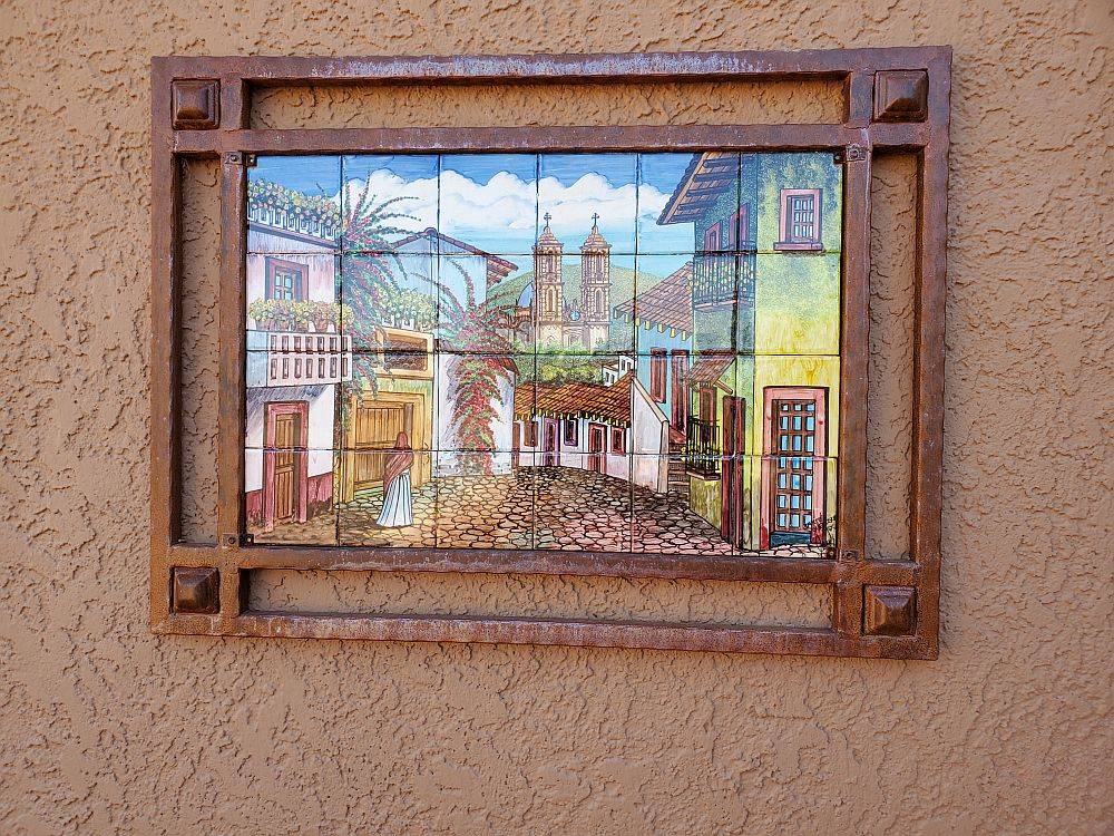

Gosh....
And here I am trying to rust steel....
Here is a steel frame I made for the Mexican Tile "painting" that Margie got in Nogales Mexico for our front outside courtyard....
