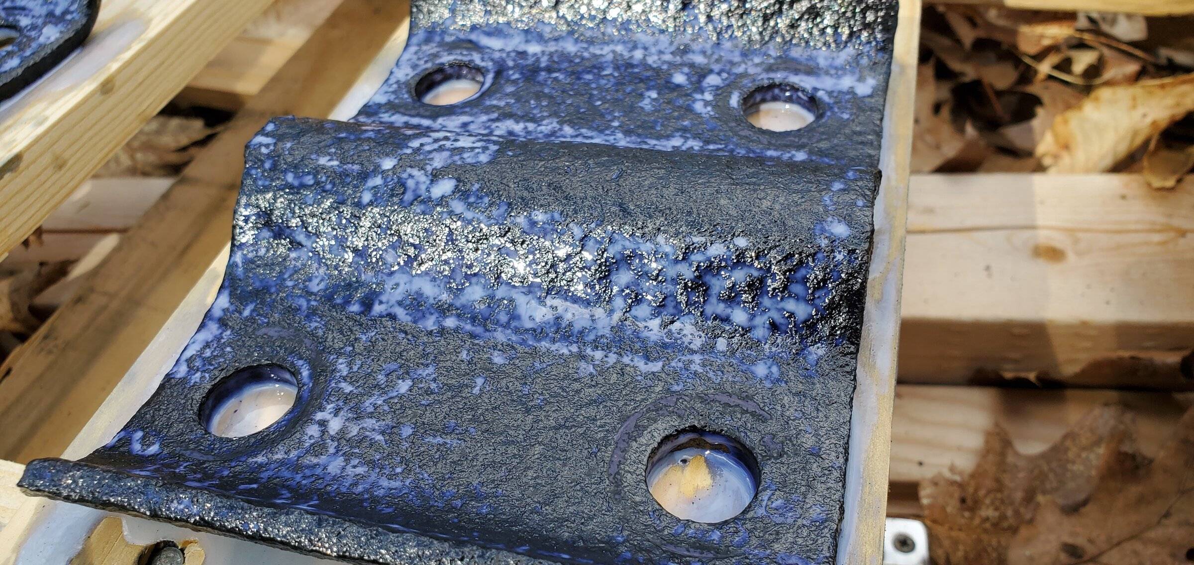

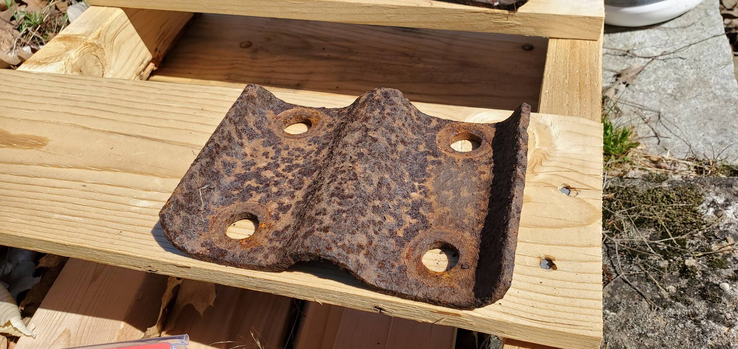

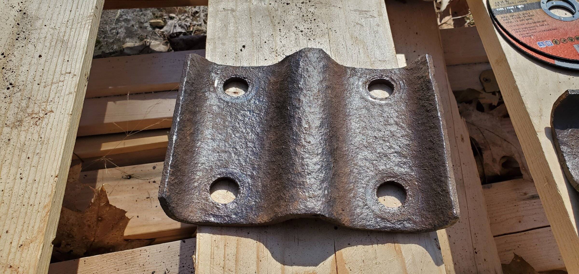

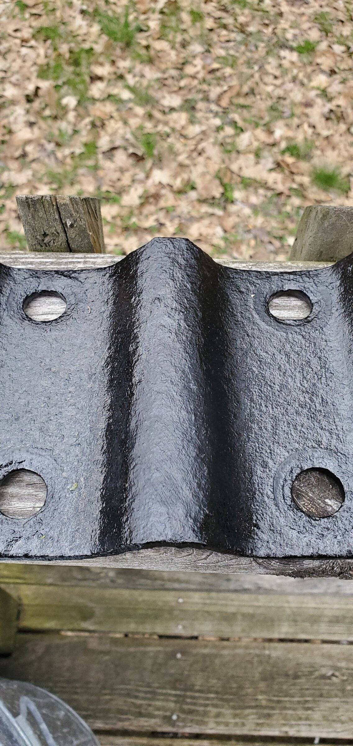

I recently found corroseal and decided to test it on some ubolt plates for a project of mine.
Super simple prep, Infinitely easier than por15..
Wire wheel off any loose rust, wipe with alcohol, brush on corroseal. Within 30 minutes the corroseal dries and leaves you with a super hard black coating.
The last picture was actually taken AFTER me taking a wire wheel to the cured corroseal. The wire wheel did absolutely nothing to the finish. It's tough. I was beyond impressed..
