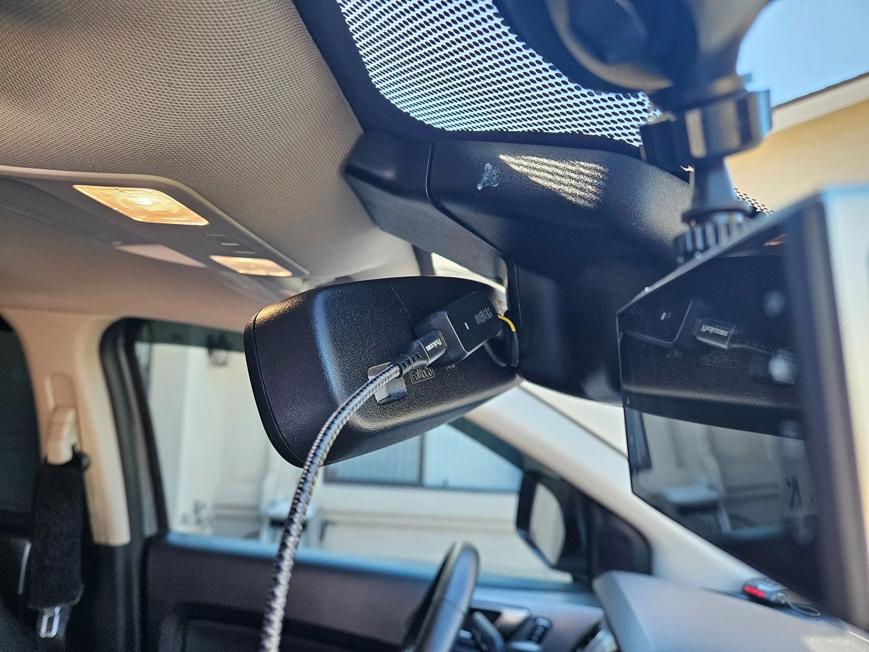

Easy install and works great. Unlike using a 12v power port, it does turn off with the key immediately. Oh, and don't block the sensor like I did. :)

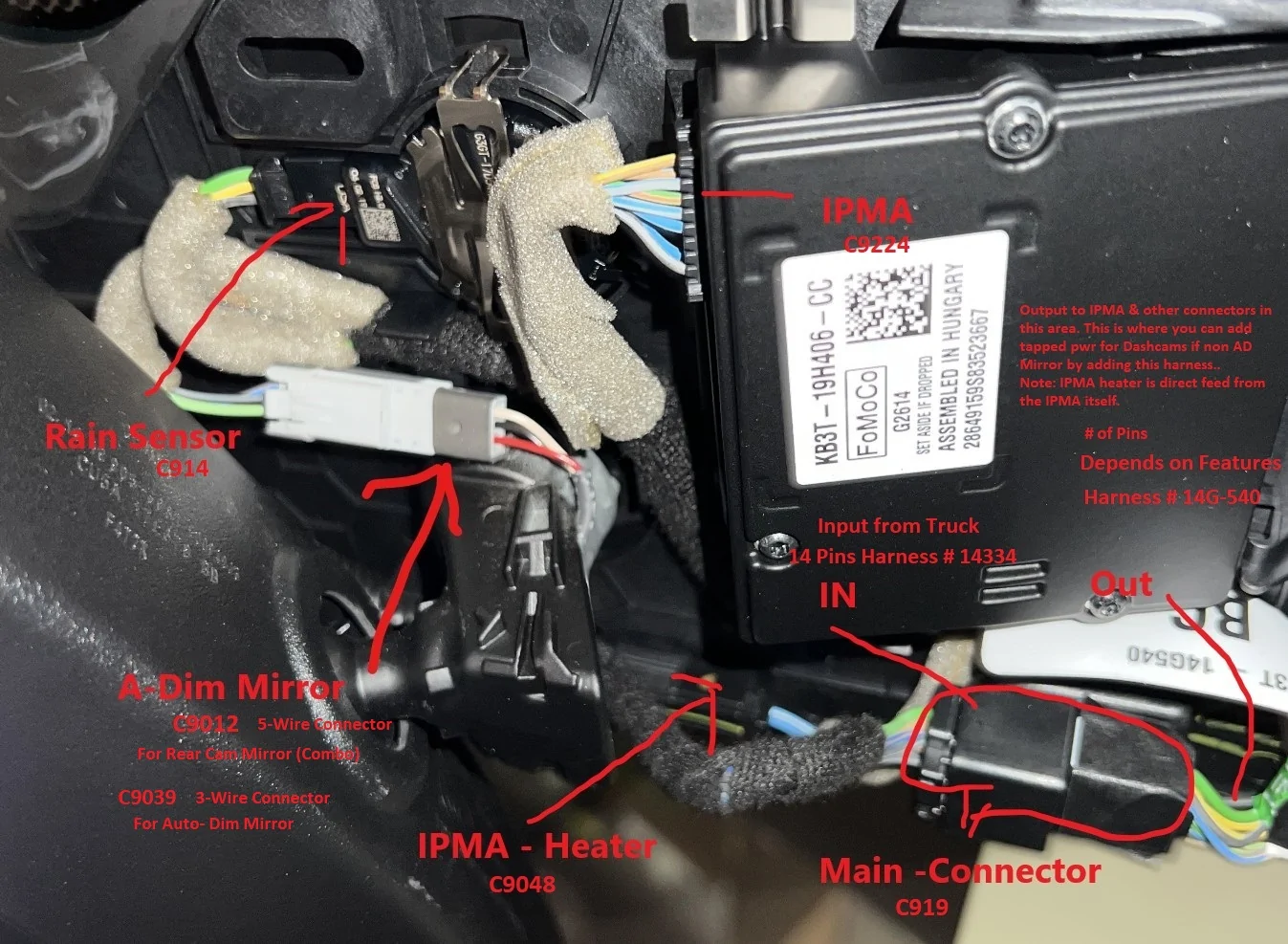

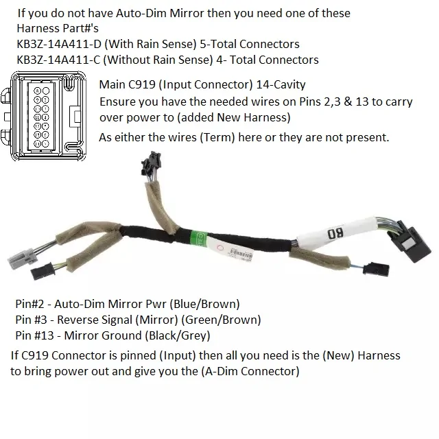

Does your mirror - have Auto-Dim (It will have a small dark circle) embedded into the mirror and it will not have the old school lever at the bottom (where it flips the mirror) upwards (blinding lights) position - this is the auto dim power feed and power is shared with the (Power Fold) button on the mirror adjustment buttons - depending on trim that switch pack has a (fold button) above the adjust buttons
9,603
45,991
In addition to what airline tech has said, if your mirror has auto dimming, it will be quite thick like the picture @dozxab posted above. If it is manual like mine, it will be quite slim.

I went the mirror route and got this:
https://www.amazon.com/dp/B0D1MXG4TX
For added fun, the pin out was wrong...so the pins had to be pushed out and flip flopped.
Instead of using both USB power things, i used a Y cable... i also broke the case and heat-shrinked them so they take up less space. One powers a radar detector and dash cam.
