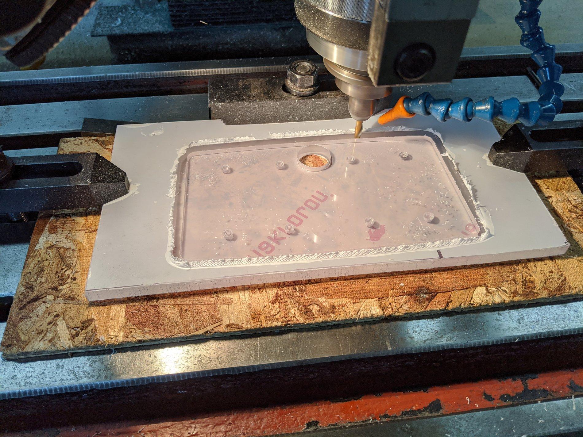

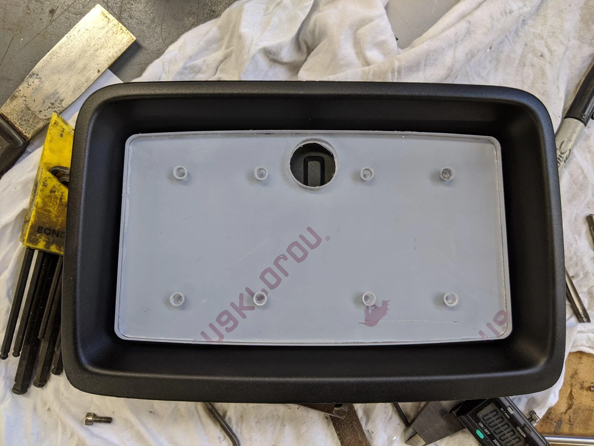

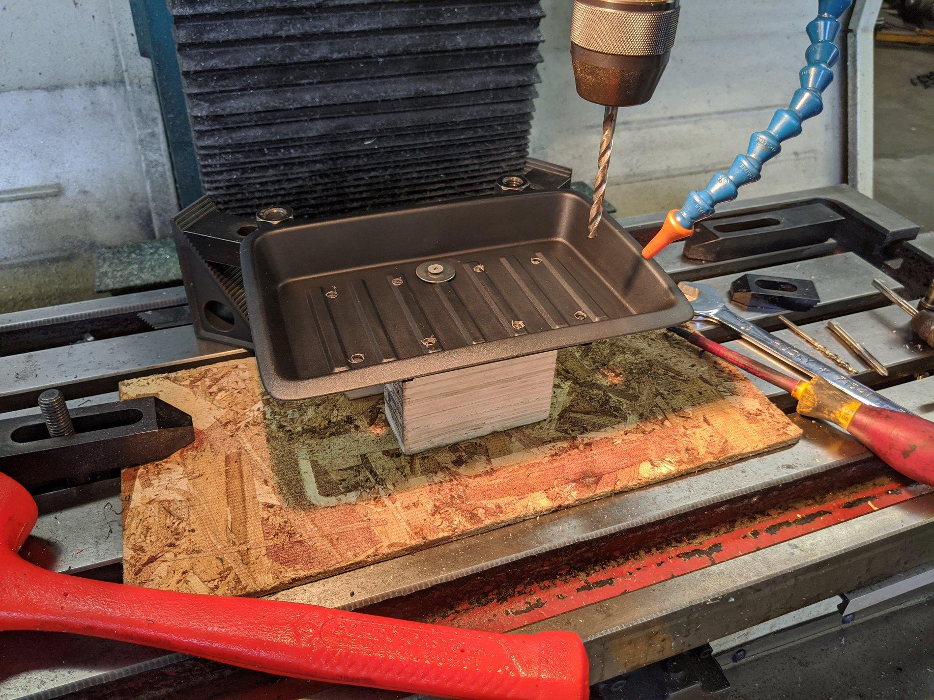

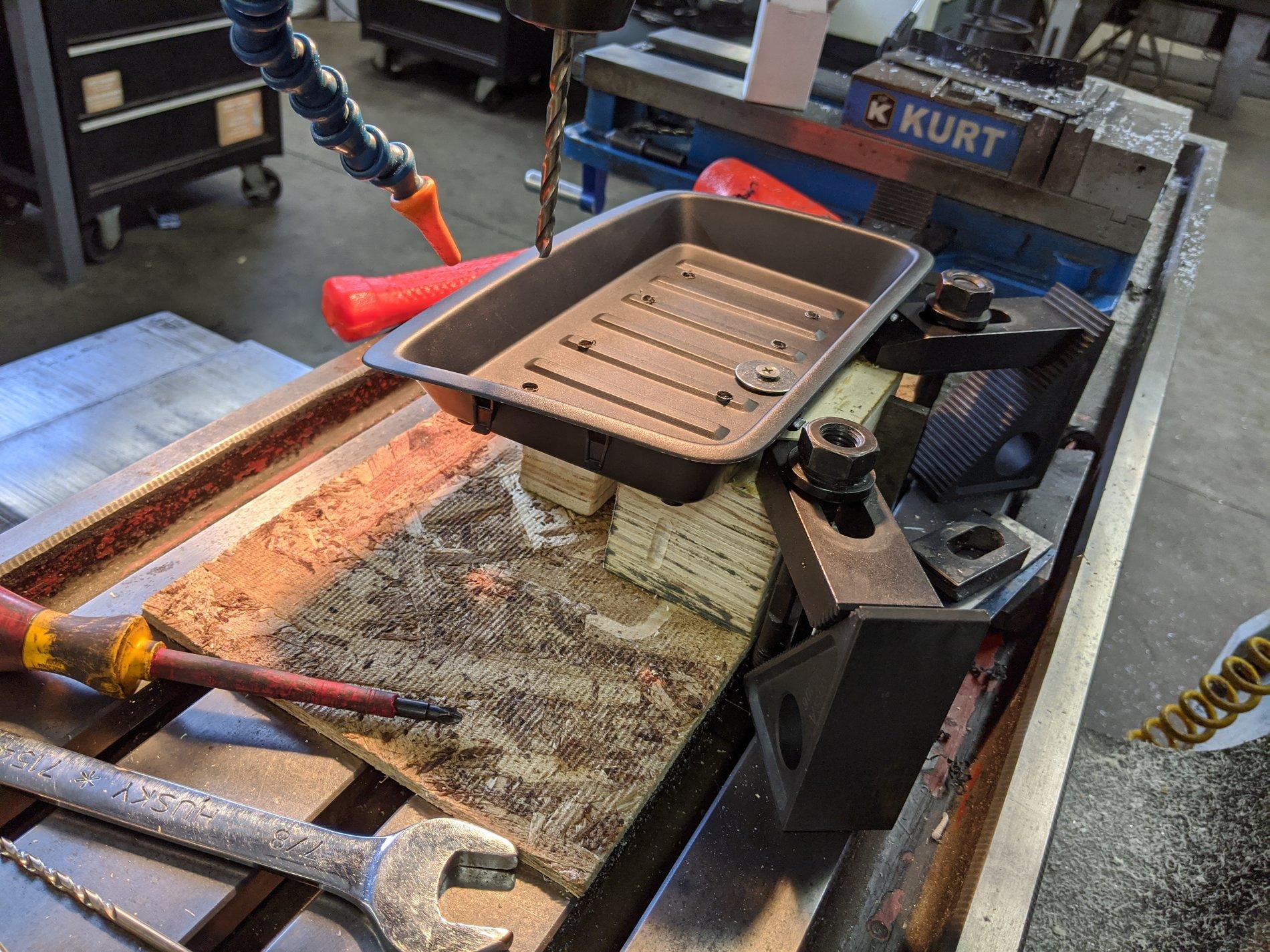

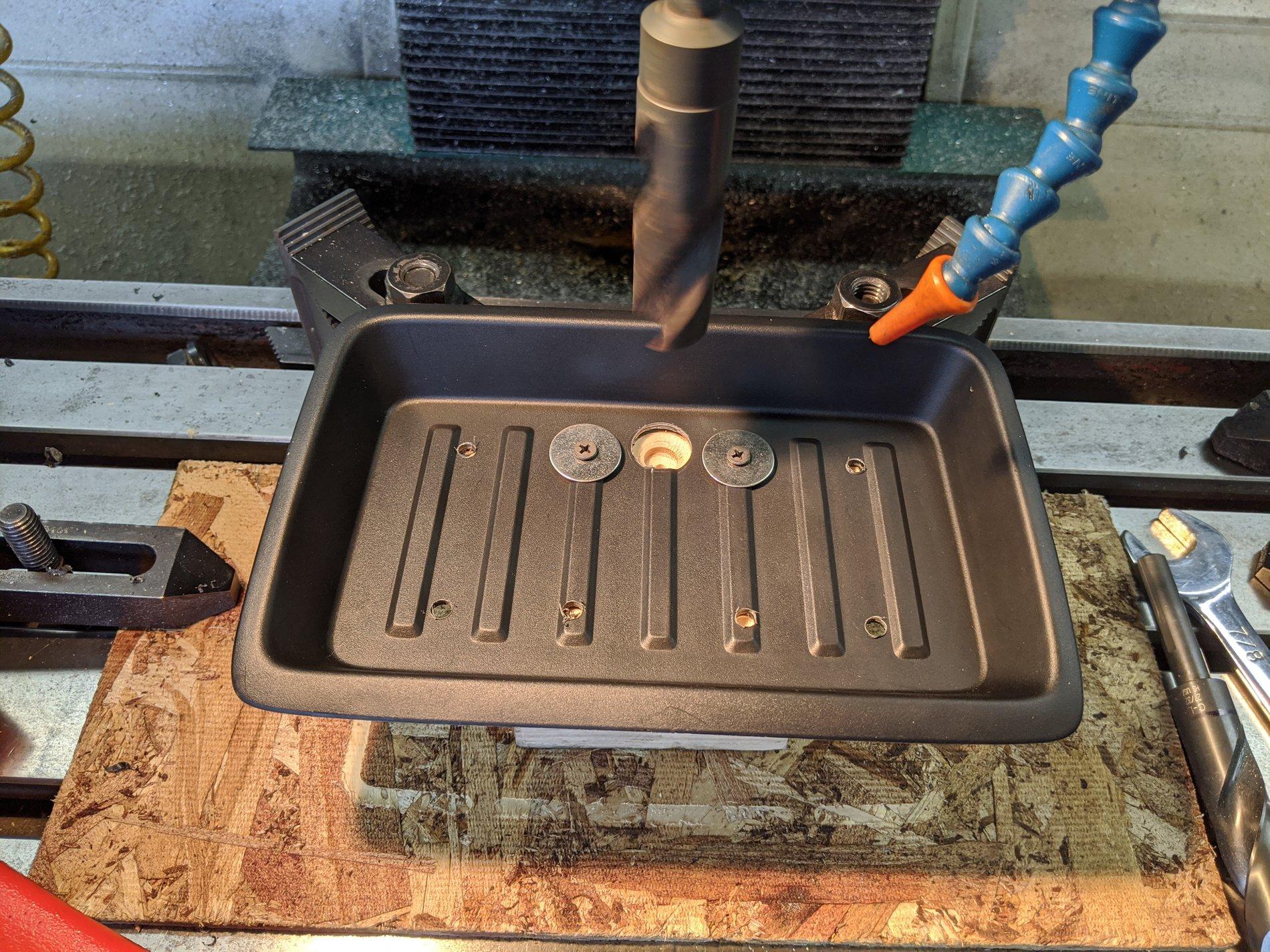

So I've seen some of you guys have added Ram Ball mounts or drilled holes into your dash tray to make mounts for devices and I liked a lot of the ideas you guys had. I didn't see that anyone that had done a suction cup mounting solution so I figured I'd make my own and document along the way.
My goal is to have the entire tray ale to hold suction cups or other types of mounts, in any spot throughout the tray. Because of the little riser strips in the tray from the factory, suction cups just wont conform around them and stick and the tray itself isn't really thick enough to hold any kind of weight as securely as I want it to. I didn't want to use magnets as my truck will be used primarily as a drag/autocross truck as well as it being my daily driver, so I just don't think magnets will hold up to launches and cornering without something flying off and breaking. I currently have an SCT BDX Rev-X tuner that I use for pass-thru datalogging, as well as an 8in Dell Venue Pro 8 tablet running Windows 10 as my datalogging device.
For the past month or so, I've been using my laptop or tablet to log runs and tune, but its inconvenient as hell to have the tablet or laptop sitting on my passenger seat sliding around. Inevitably, they are going to slide off the seat and destroy the device, crack the screen, or break one or more of the ports and to me, this just isn't something I'm ok with. So, I've set out to over engineer the hell out of a dash mounting system that with meet all of my wants for how to securely hold my devices so that they are both safe from damage and within my peripheral vision, that way I don't have to keep looking over at my passenger seat to see whats going on with my truck.

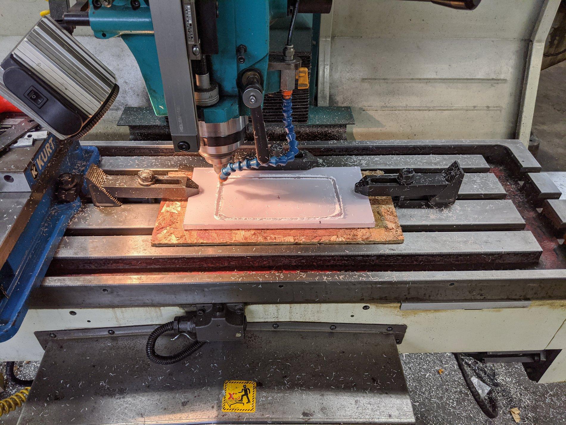

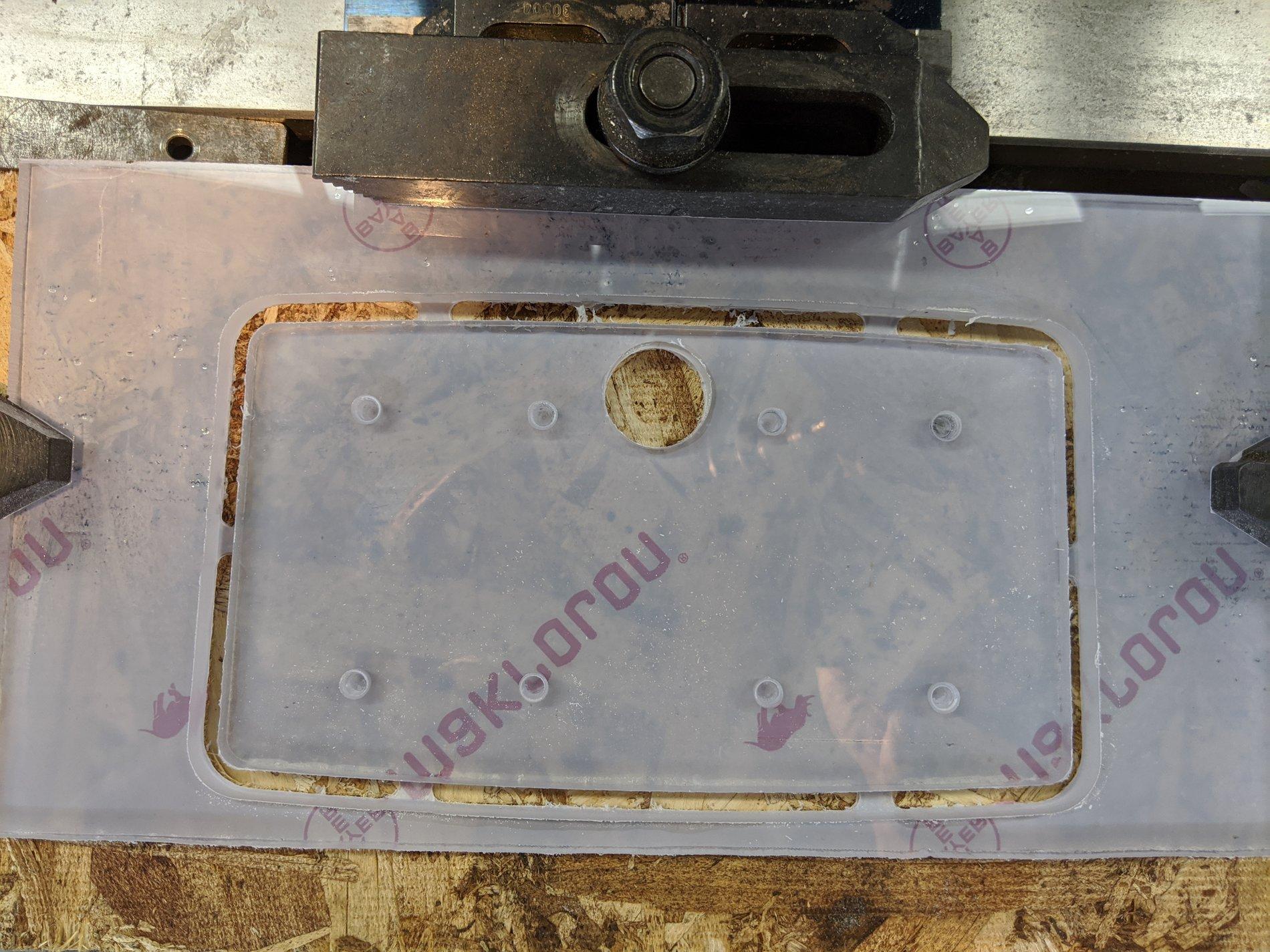

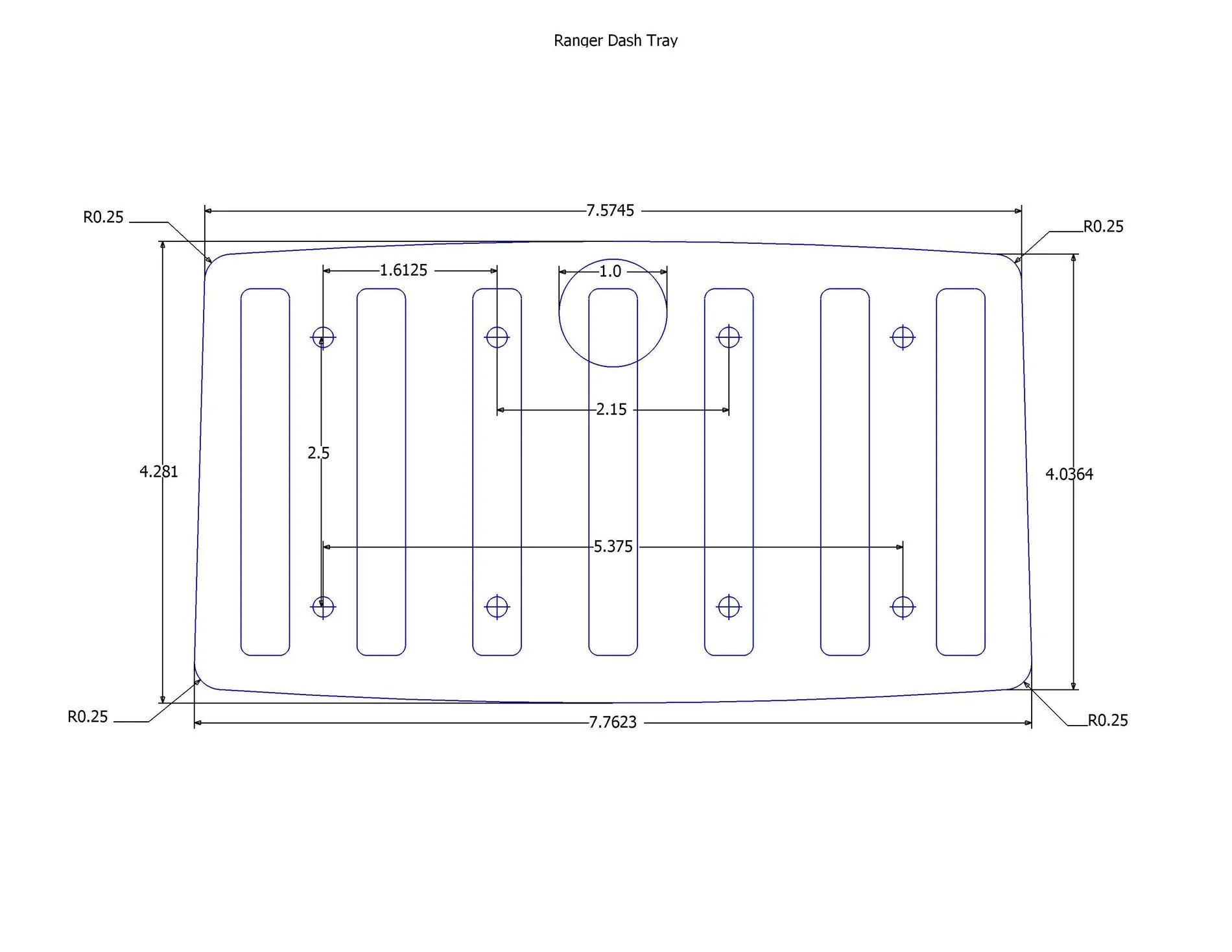

Sorry for the long winded intro but I figured it necessary to explain exactly what I'm setting out to create. So I've drawn the bottom of the tray in CAD and taken all of the dimensions for you guys if you are interested. I currently have the PolyCarbonate on my CNC Mill cutting out the profile so I'll update as I go along. Let me know what you guys think!

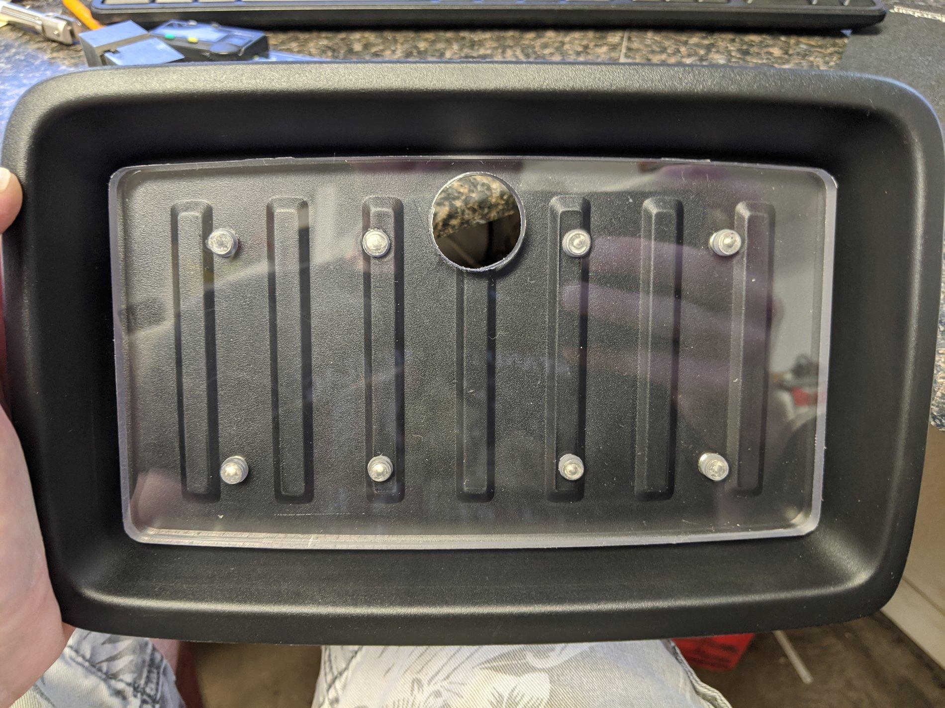

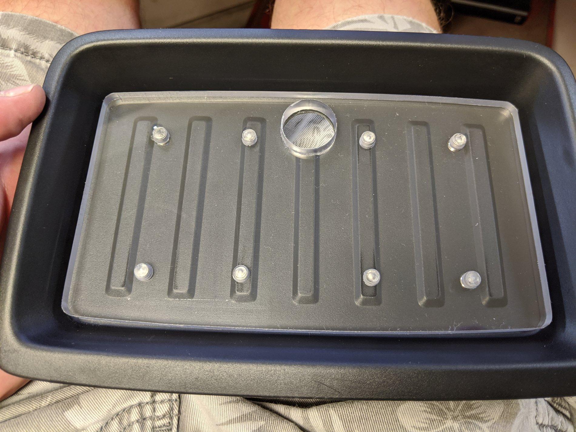

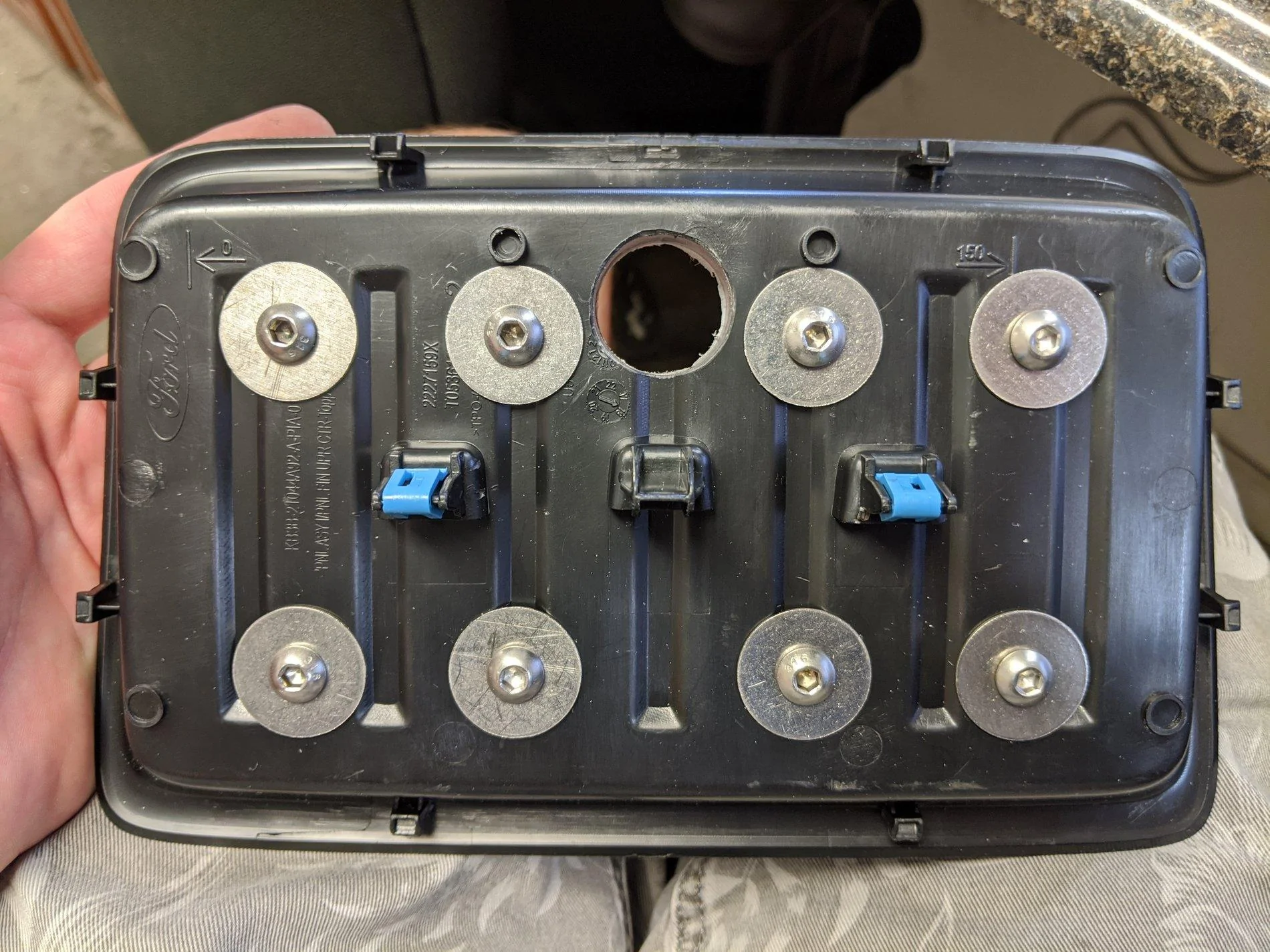

All done! Now I just have to fish the OBD II Cable from up under the dash and reinstall the tray. I'm very pleased with how it turned out! I'll post some more pictures of it when I reinstall it after work today.

By the way, what a massive pain in the ASS it is getting the wire from the dash tray down to the driver's side footwell!!
