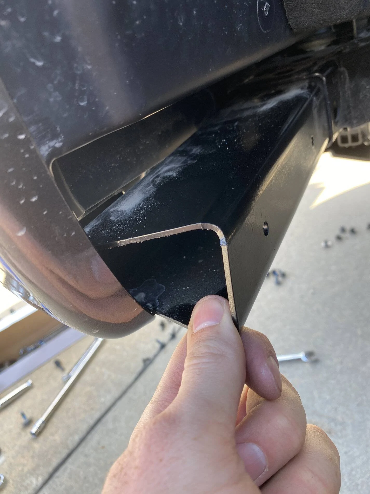

Crash bars. No reason to cut.

Good Morning Derrick....was wondering if you could provide a photo or two of this mod you performed. I have the exact same issue and it sounds fairly simple. FYI.......nice Ranger! Mine has only 600 miles on it. Thanks in advance!
Are you asking about the crash bars or the valance that had to be removed? I have photos of the bars I swapped out but didnt take any of the valance. Well I did, but I cant find them lol
As I mentioned though it will take some pulling, but if you do it straight and not at an angle, you wont break anything. I replaced all my clips with better clips anyways. They slide on very easy but do not come back off. I ordered them from amazon. Well worth it.

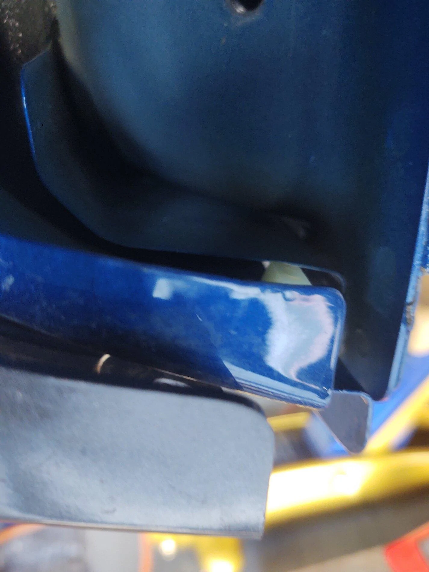

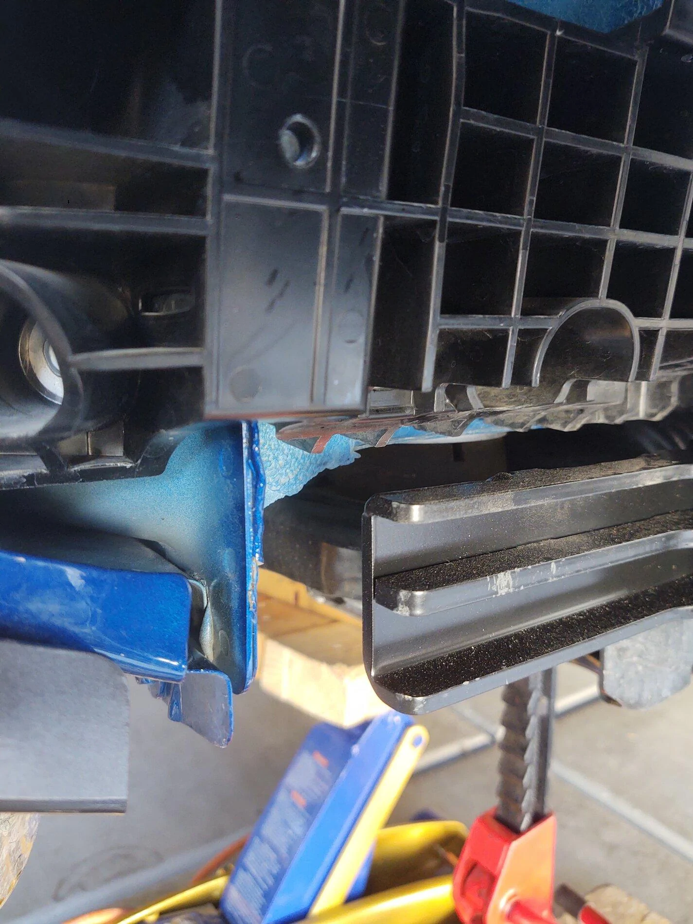

Idk if anyone even tried to pull the front rears out before cutting them?
But I did. You only need about 2 mm to get them out.
There's absolutely no reason to have to cut them!
A small tap of the hammer and you got enough clearance. Threw a rag over it, tap, tap. Slid right out. If you need to you can take a pair of pliers and bend that little flange back if you want. I didn't cuz its actually flush with the body now.
Just check before you start hacking s**t up! Now I also have the the factory bars sitting in my garage if I ever need them.
That's what I said...all four bars can be removed without cutting...

Yea I guess I don’t understand how you guys did any of that. I’ve been out here for an hour and can’t get the front trim off (clips won’t budge) or move the bars forward or any direction for that matter. The end of bar Keeps getting caught
Loosen the front bumper bolts enough to rock one side out enough to slide bar out...rock the other way for the other side...
