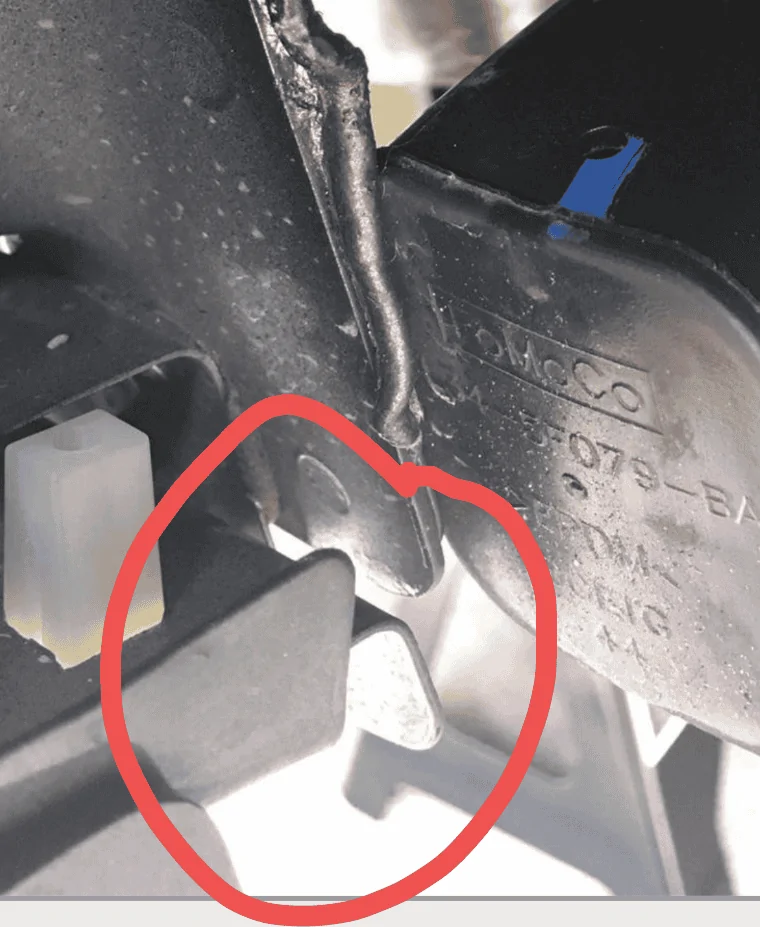

Idk if anyone even tried to pull the front rears out before cutting them?
But I did. You only need about 2 mm to get them out.
There's absolutely no reason to have to cut them!
A small tap of the hammer and you got enough clearance. Threw a rag over it, tap, tap. Slid right out. If you need to you can take a pair of pliers and bend that little flange back if you want. I didn't cuz its actually flush with the body now.
Just check before you start hacking s**t up! Now I also have the the factory bars sitting in my garage if I ever need them.
Are these pics for the rear bars? Is that what you mean my bending the flange back? Thanks.

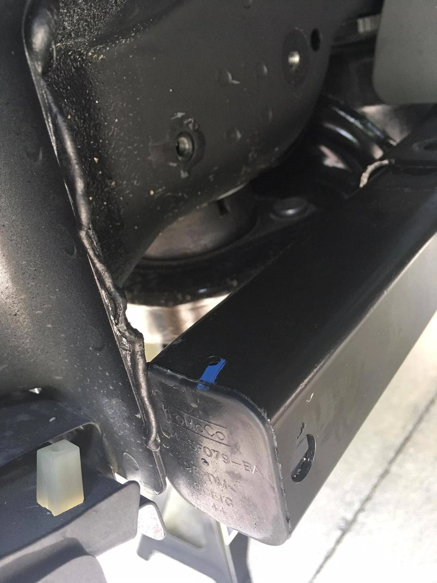

Start at post #5 of my build thread...
https://www.ranger5g.com/forum/threads/project-msfitoy-v3-0.2804/
The last image shows the rear bar and the fender flange that's preventing it from sliding out...later on, I discovered that by loosening the lower fender bolt attachment, I was able to pull the fender out just enough to slide out the bar...
Hmm...looks like your corner panel is in the way more than mine.
Yeah my corner panel wasn't in the way like that maybe
cuz of my lift? All I had was the little flange.

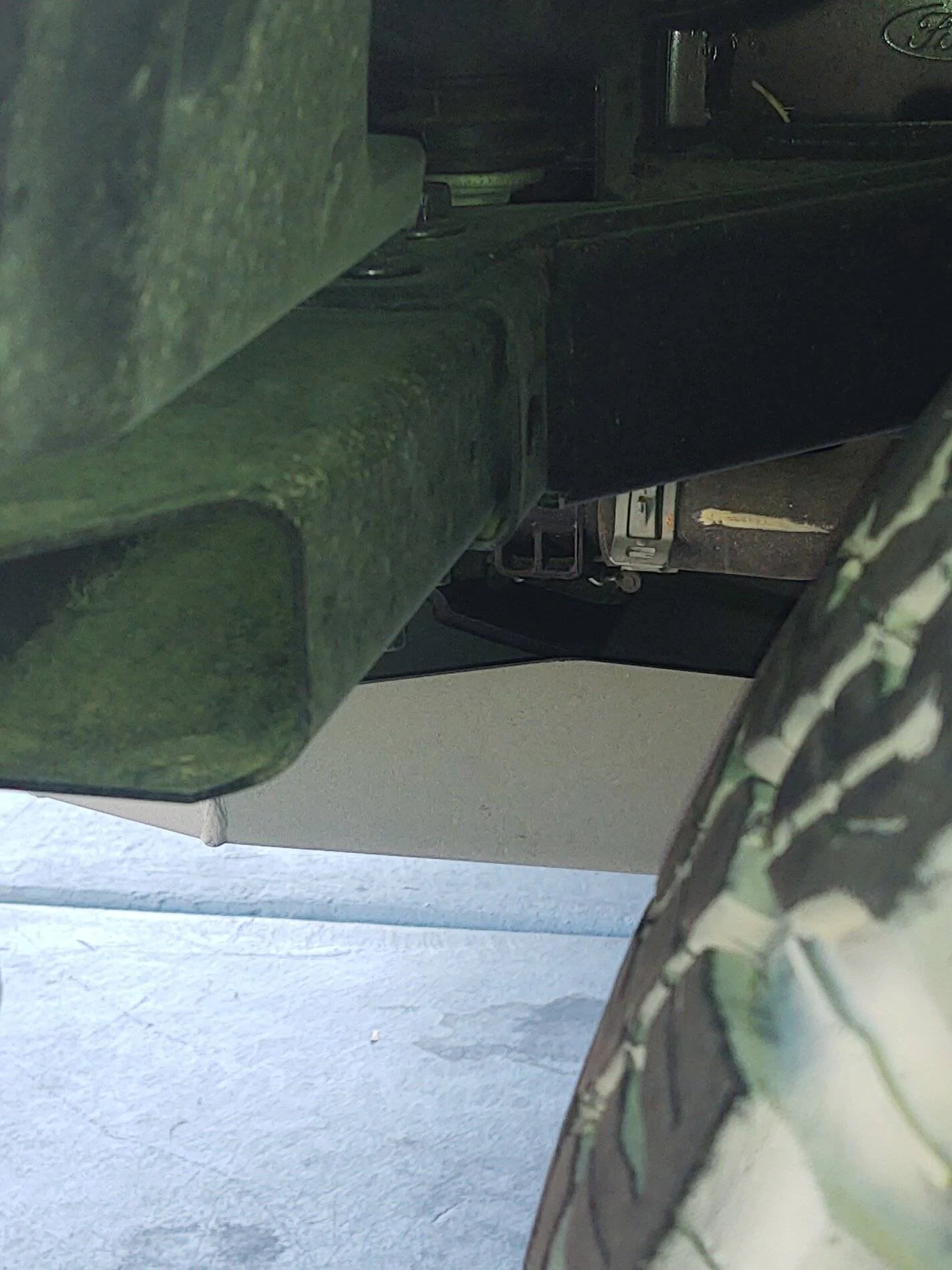

Here's
Not sure what you're doing with the fronts? But here's my clearance with just loosening them and pushing them forward with 285/70's

Sorry my pic was misleading...I had already unbolted the bar and slid it out to where it contacts the panel to see how little I needed to clear...
Were you able to clear it, or did you have to loosen the corner panel?
9,234
28,614
NWO Robot Polisher
I removed the lower quarter panel bolt and used a screw driver to pry it out and back just enough for the bar to slide out...

There are 6 bolts securing the front bumper, 3 per side. The only tricky part really is removing the plastic fascia / insert in the middle of bumper to access them. Make sure you have a helper when handling the bumper as it makes things a lot easier. Take your time and it's not too bad. And fyi the rears can slide out too with care and patience. I had to remove the bolts holding the body panels together and gently pry them to get the final 1/8 or 1/16" of clearance I needed.
