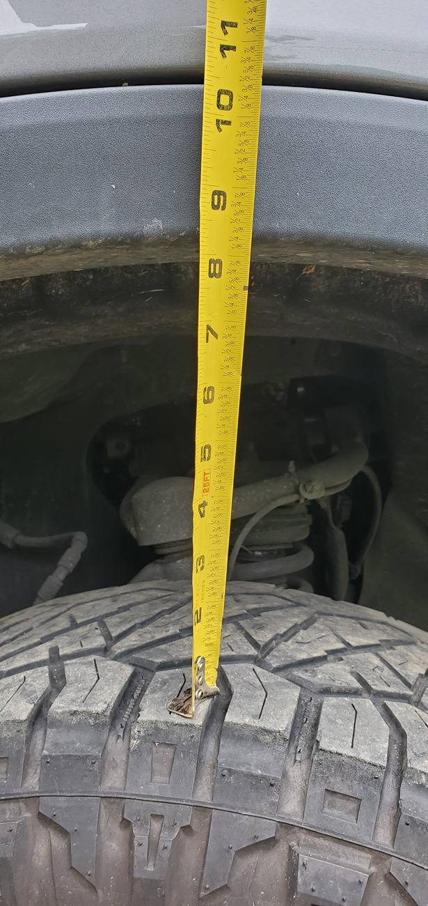

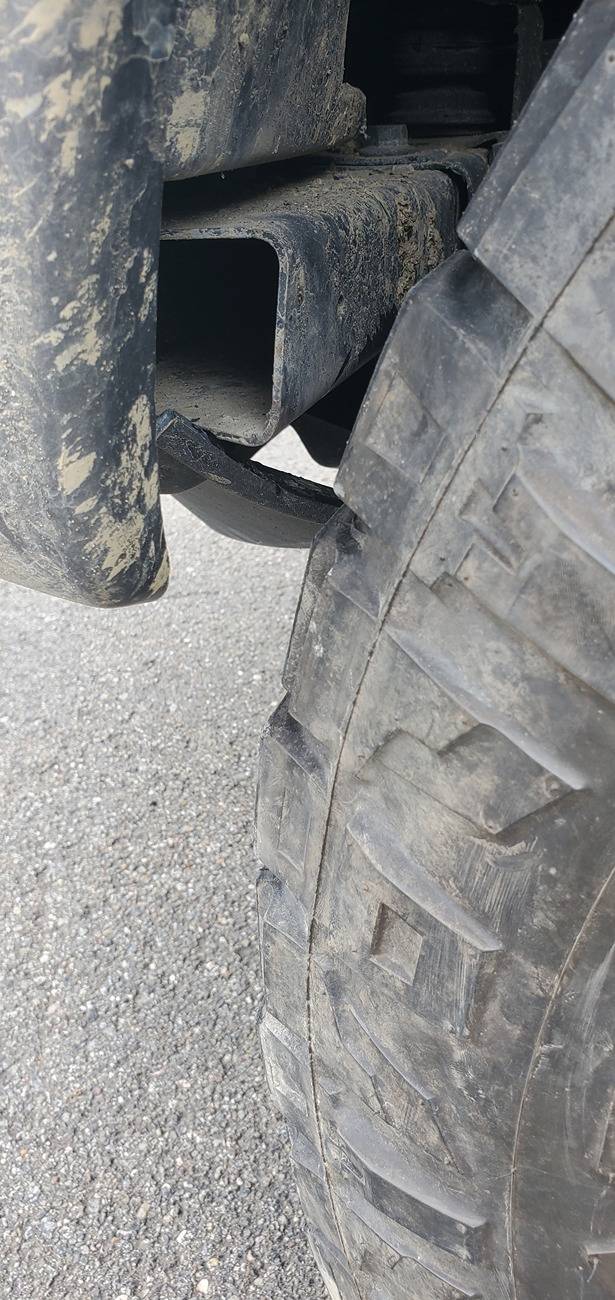

Looking at the ReadyLIFT Anti-Intrusion Beams since I got some 285/70/R17 wheels and tires to put on when off roading. New tires and gas are too expensive to keep on full time. I've got the Fox 2.0 lift/level, still preset to the 2" lift. ReadyLIFT says with their 3" lift in the description.
Anyone know I'll still have rubbing with the high clearance bars? I'd prefer not to have to also take off and reinstall the OEM bars whenever I put on my rangers dancing shoes.

I have the Fox 2.0 level kit, preset to 2", Ready Lift anti- intrusion bars with 285/70/R17 tires on +25 offset wheels. My tires rub the thick felt "sound proofing" only when wheels are cocked fully.

Dang it! That's my exact setup and I was hoping for no rubbing. Now I'm back to considering 275 70 r17 again.

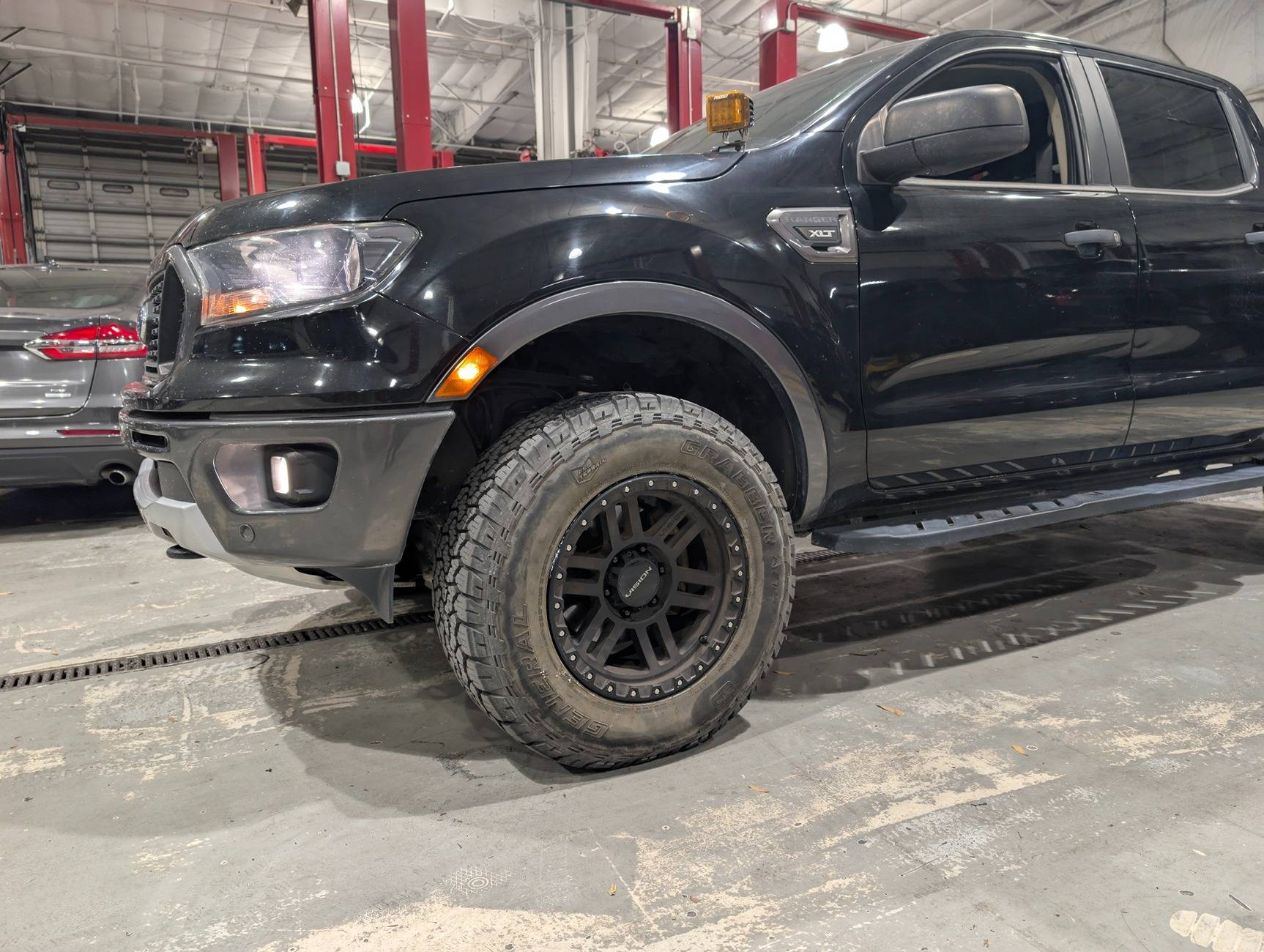

Just looking for opinions on which way to go. I am running a BDS 2inch level on 265/70r17 tires and I just installed Vision 17x9 +12 wheels which came to me free. So now I get a little bit of a rub on a full lock in reverse. I tried to adjust the front bars out but just not quite enough to clear and since I do off road it I would like it to clear. I have no problems ordering a set of aftermarket bars, the BDS set is can get by the weekend it looks like just looking for some input on is it worth it really. $15 for a diablo sawzall blade vs $90 for the bar kit, and I could use a fresh blade.
