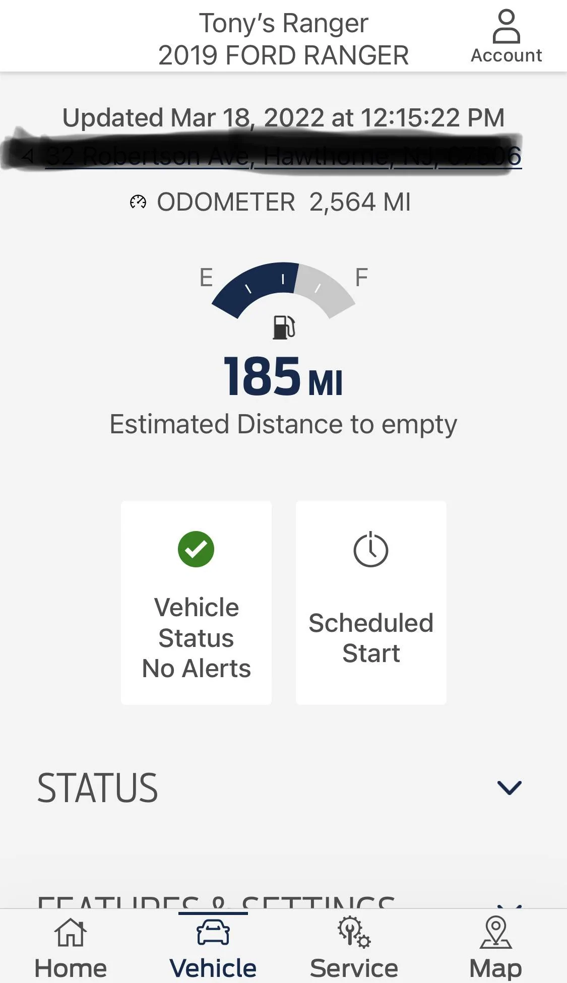

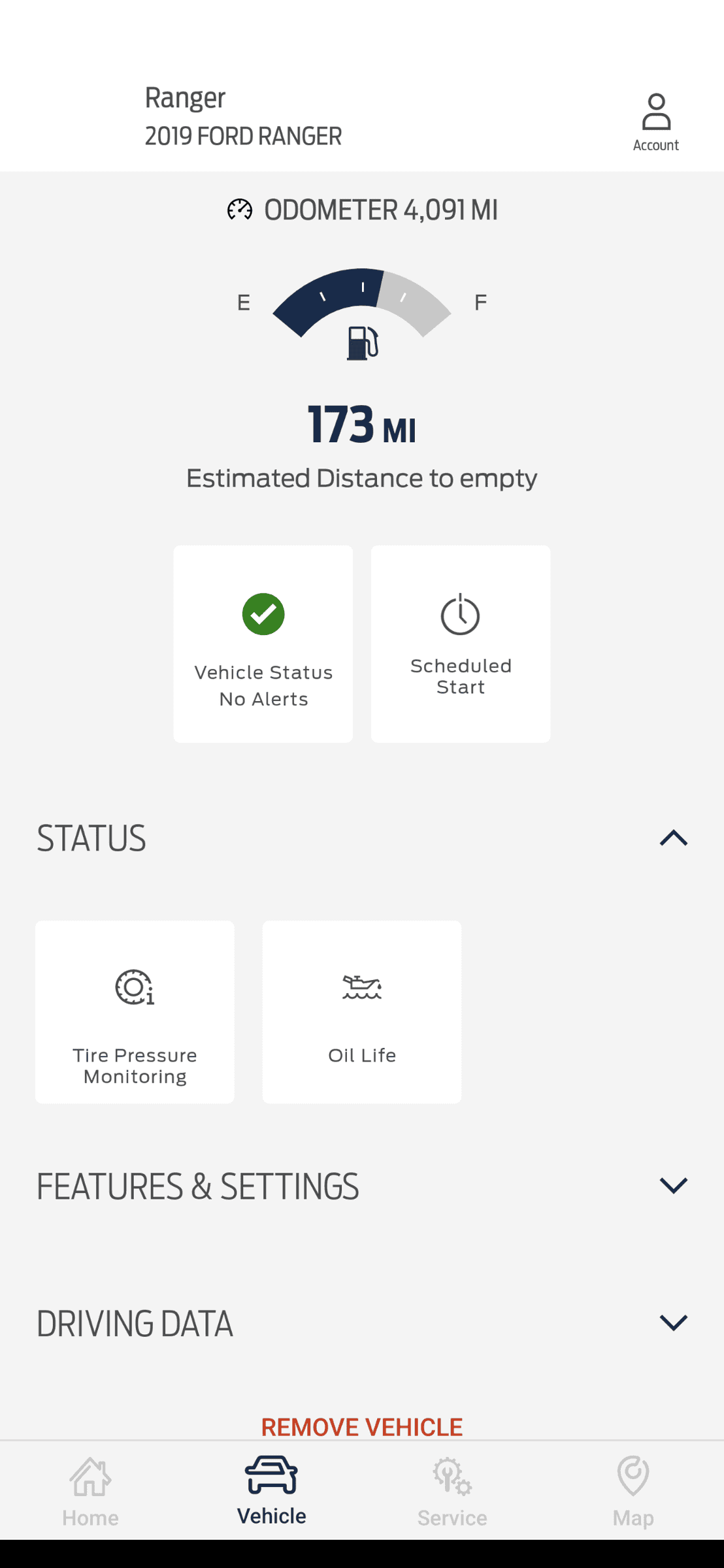

I took delivery of my Ranger March 8, 2019. Here's my current mileage according to the Ford app
4000 miles in 3 years? May I ask why did you invest in a new truck to have it sit around?
