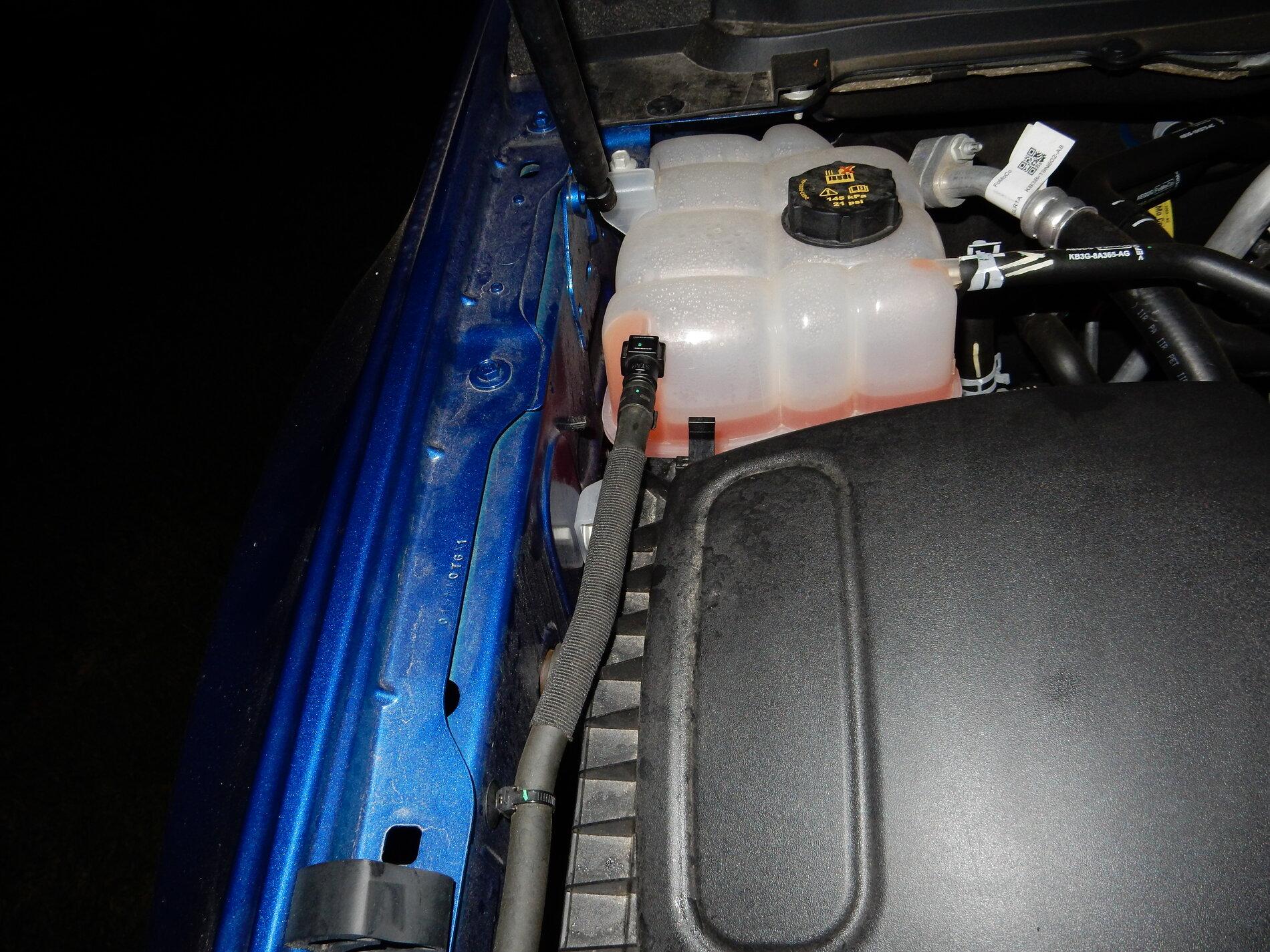

The trouble is getting to replace the engine air filter - the return line on the engine coolant reservoir
(on the left) blocks most of, if any, of the air filter cannister hinge movement and you could easily break this return line/hose off. Looks like the simple three clips removal is not enough?
Anyone else have this same problem?

pull the return line off when the system is cold and unscrew the cap to relive the pressure. it has a quick disconnect just for this purpose. just push square button on return line coupler and pull.

I leave the coolant hose conected. After disconnecting the iat sensor I can get the air filter out easily. Just have to remember to reconnect it of the engine light comes on.

I've found it easier to unscrew the hose clamp closest to the lid at the accordion elbow and then pull the lid off without disconnecting the return line. makes it easier to manage if its loose

I did this in order:
(Removing only three clips will not cut it)
1. Loosen the cap on the engine coolant reservoir to de-pressure
the "cold" reservoir.
2. Pulled the engine coolant reservoir line off by de-pressing
the square tab, on top of the hose connector.
3. Unclipped and pulled the IAT sensor wire away and loosened the stainless
steel hose clamp on the right side of the filter housing.
4. Unclipped the three clips on the air filter housing.
5. Removed the filter housing top cover.
(Reverse this order after replacing the $18 engine air filter)
Ref. Frenchy/JaysOnTheEDGE - thanks.

I put a K&N in mine a few months back and only removed the clips. You guys are making it way harder than it needs to be lol.
Was the coolant hose in the way? (Mine was jammed against the coolant return - see pic above)
My removal procedure only takes 2 minutes to perform and prevents any possible hose/connection failure. Very little effort was performed and after all it's only have to been done every 30K.
Did you remove the top cover completely?
As part of servicing the Ranger yesterday (basically an oil change as the oil life was at 29% and the mileage is only 1800 miles since December 2019), I removed the air filter to inspect it. I was able to move the coolant hose slightly which made room to open the top cover enough to remove the filter. Easy peasy.
