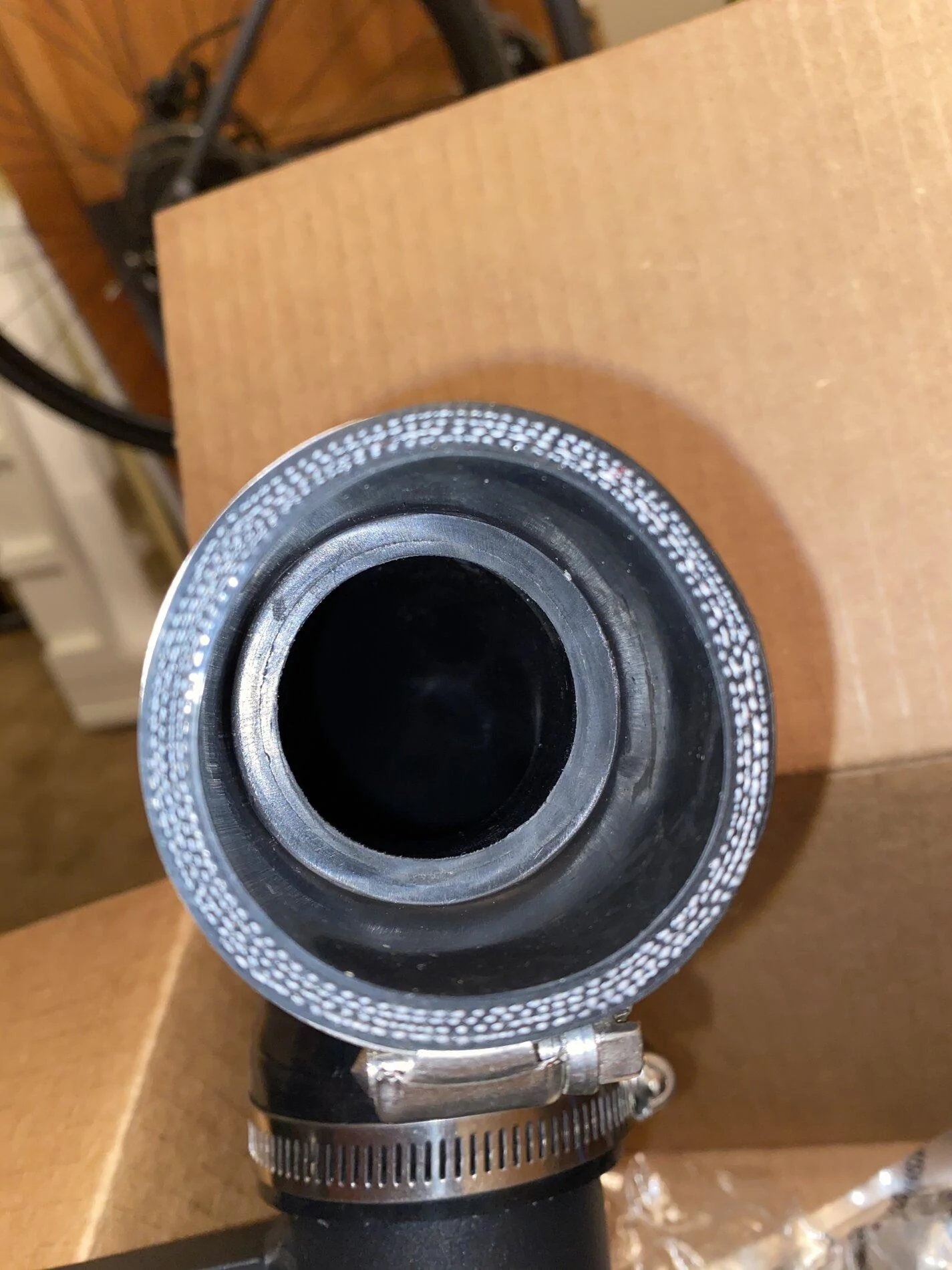

I’m wondering if the step inside the coupler that attaches to the turbo outlet would benefit from chamfering that edge... Or is that I.D. the same as that of the turbo outlet in which case the flow should be smooth?
Hmmmm
It might end up being pushed flush? Thats interesting.

Yup, that was done on purpose! The flare is so that the turbo outlet sits flush with the coupler for a more even surface throughout the piping system, which reduces turbulence and helps the system flow better.
