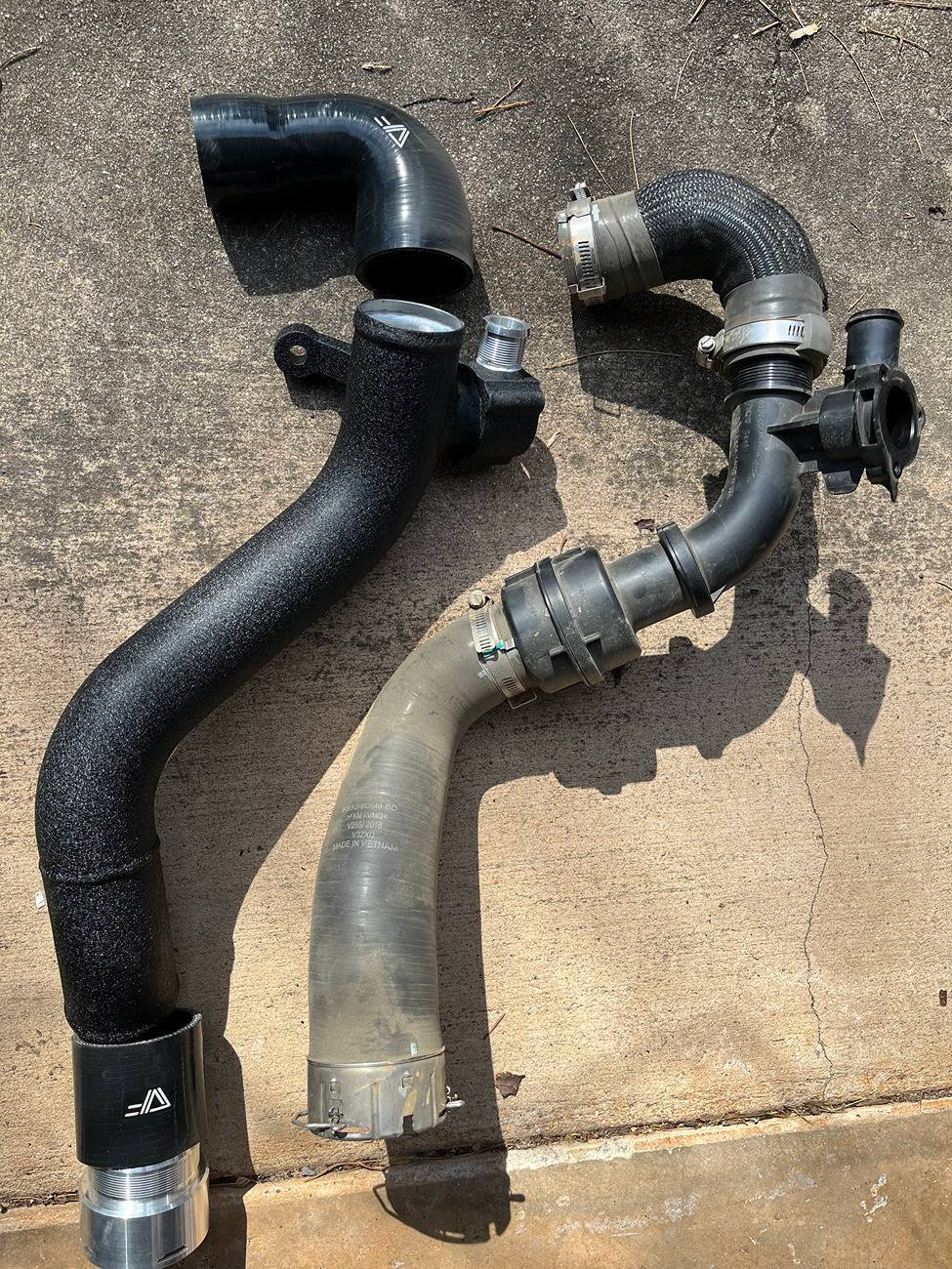

It’s like the answer3 said there two different versions the one pictured above I’m assuming is a dual port cause that’s how my dual port is positioned

Word? Can you elaborate? Two different models or two different versions of the same model?
Yes there is the Turbosmart BoV kompact EM VR13 plumb back part number 0223-1296 and the turbosmart bov kompact dual port vr13 part number 0223-1096. They both fit differently.

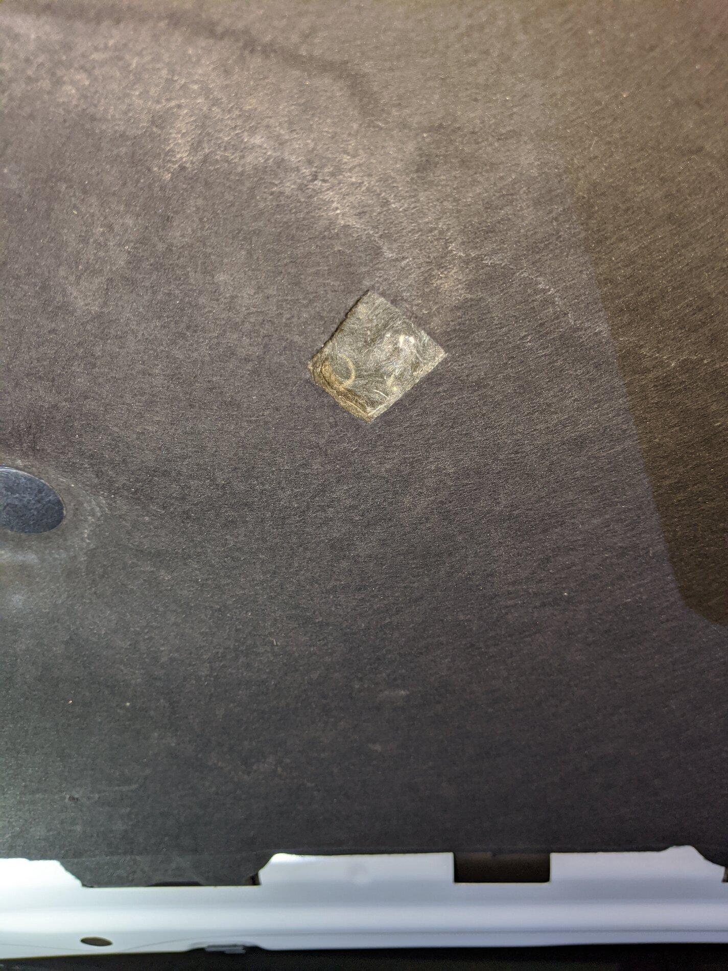

Any updates on the BOV clearance under the hood?
I just got my set from AFE last week and installed this past weekend. I also the GFB DV+. AFE has not made any changes to their design and the DV+ still touches the hood liner
I decided to use an Xacto knife and cut a small hole. I let it make an indentation for a few days to mark the location. Hood liner seems to be two layers so the one peeled away nicely

So if anyone is confused about which direction your bov goes. There are different setups.
The stock one is setup at a 5 o’clock position.
The bov turbo smart is at a 8 o’clock position. It’s just the way they made the threading

If aFe was smart they would tilt the diverter mount for clearance like Mishimoto did with theirs.

So an update to this thread.
I installed the CVF intercooler pipes instead of the AFE.
They fit great and there is no interference with the hood.
As far as performance goes, there is negligible difference that I felt. Maybe a bit better throttle response. Maybe a bit more whooshy turbo noise. But both of those could just be my subconscious trying to cost justify them ?
When comparing stock to CVF you would think there would be a big improvement, seeing how restricted the factory setup is.
Right now I'm not tuned (stock) so maybe there would be a bigger difference if I was tuned.
In a nutshell, they look much nicer but don't get them if you're expecting a performance boost.
