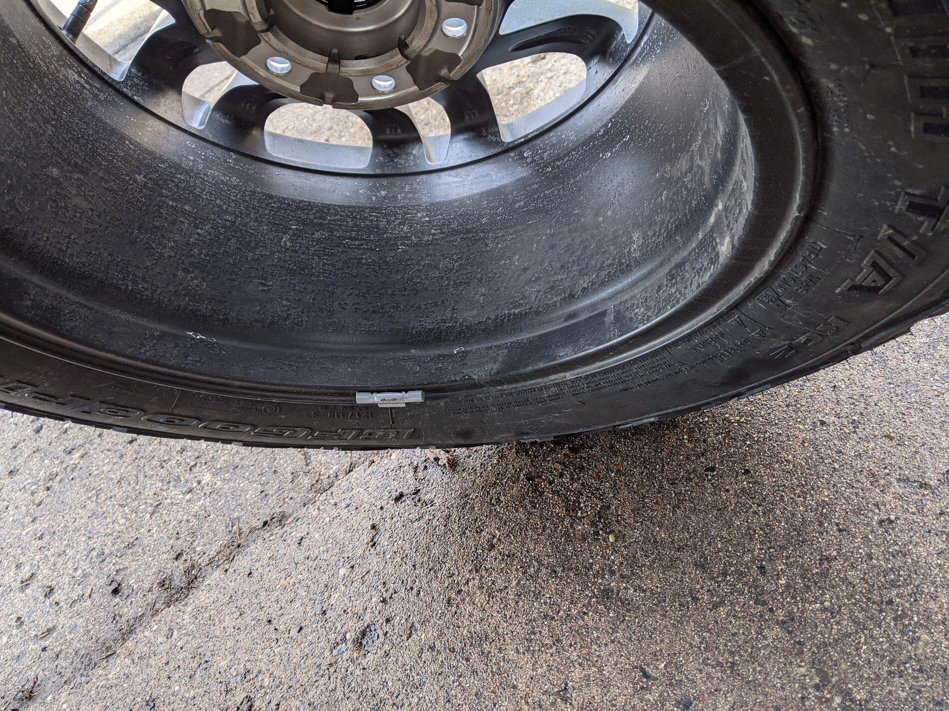

I had a similar clunk today after putting on my summer wheels set which is the Ranger Raptor rims. Turns out it was the inside pinch weights rubbing on the knuckle. Can't believe the tolerances were that close. I'm interested to see if the offset of this rim is different than the stickers.

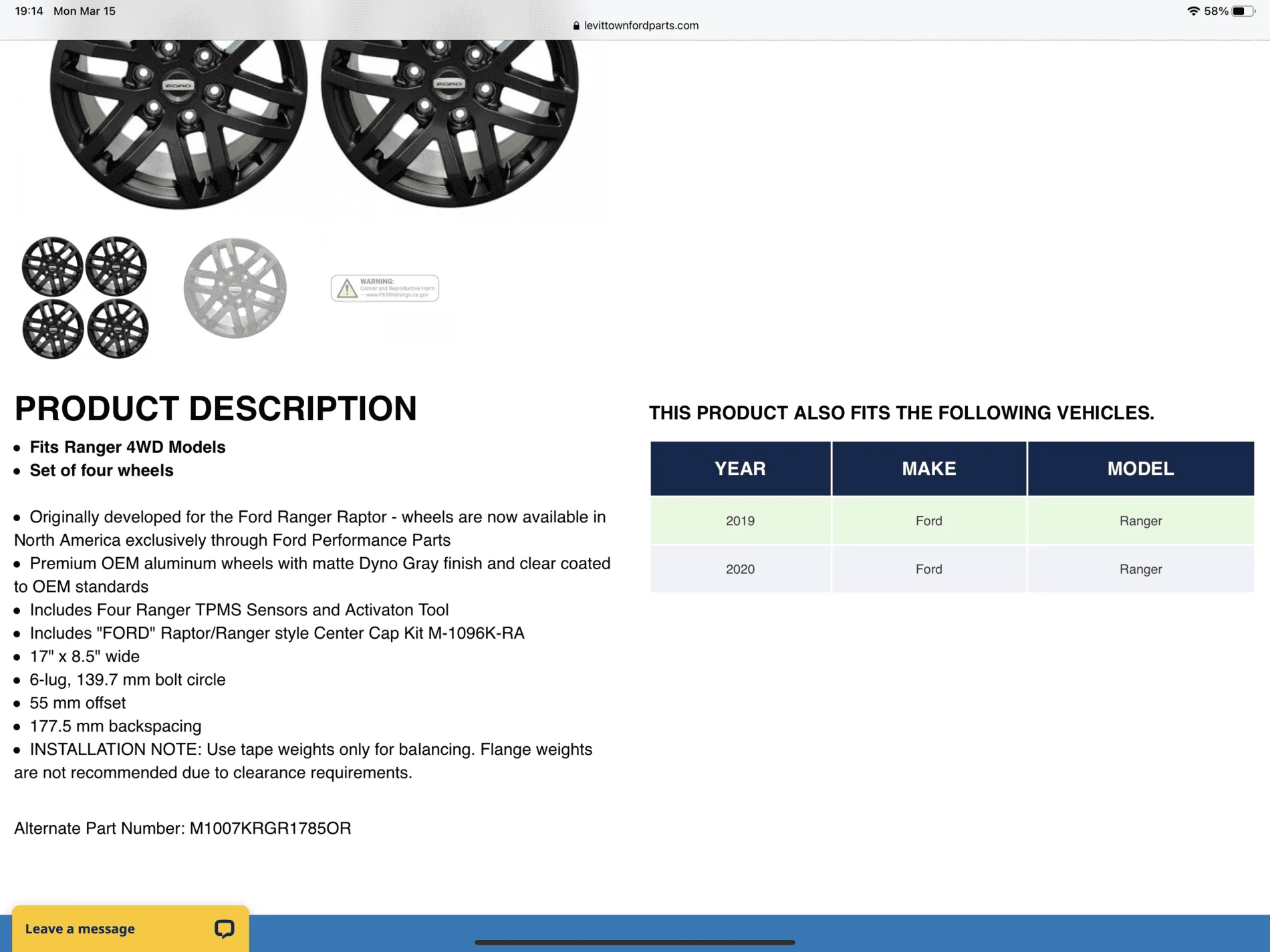

Somewhere I read a warning that said to only use tape type weights for wheel balancing because of clearance issues. I looked at my wheel and tire placard but I didn't see the warning, so I'm not sure where I saw that. Maybe it is written on the inside of the rim? My factory wheels have the tape weights.

That’s correct, tape weights only. See pic.
