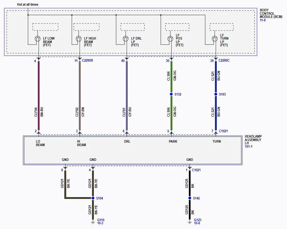

I agree, possibly something hosed up in the Body Control Module. I took a quick look at the schematic and each headlight / DRL has a separate unique wire that runs back to the BCM. There is no splice or tee in the circuit for the DRL's. (Left side shown below, right side is similar)
So with that said I would check the output on connector 2280C, pin 40 at the BCM, if it is dead / dies after a minute at that point then I would be looking hard at the BCM. Otherwise look at the wiring.
Hopefully it is still under warranty and a young, wirery tech at the dealership can have the pleasure of crawling around under there.
