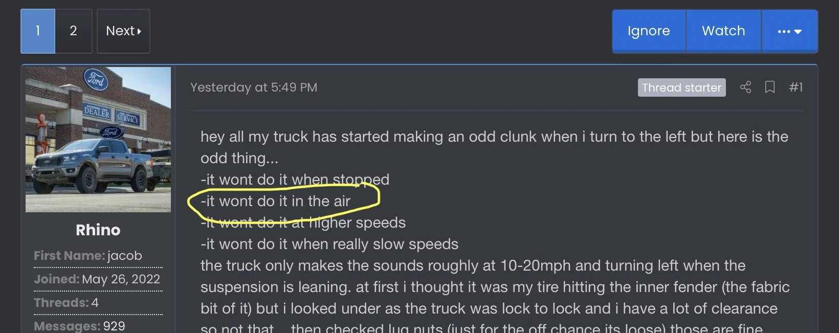

hey all my truck has started making an odd clunk when i turn to the left but here is the odd thing...
-it wont do it when stopped
-it wont do it in the air
-it wont do it at higher speeds
-it wont do it when really slow speeds
the truck only makes the sounds roughly at 10-20mph and turning left when the suspension is leaning. at first i thought it was my tire hitting the inner fender (the fabric bit of it) but i looked under as the truck was lock to lock and i have a lot of clearance so not that... then checked lug nuts (just for the off chance its loose) those are fine also... next thing to check is ball joint and other suspension parts with a pry bar and see if anything moves or what not..
information about the truck:
2022 fx4 leveled with eibach pro 2.0s that me and my buddy installed (not new to installing suspension btw) with 275/70/17 cooper st maxx the truck has roughly 10500 miles on it and its been leveled since 4000ish miles (ya i didnt wait to long). the noise didnt exist until recently when things got colder ive looked around on the truck at a few things but have yet to find anything that sticks out easily so tonight ill be pulling it into the garage and taking a look but wondering if anyone else has had an issue like this randomly show up on their trucks?
noise location:
only can hear and feel from the driver side (why i thought it was the tire hitting) it seems to be more of under the seat ish but at the same time i cant fully tell ill be honest it just seems to be either in the front or roughly below my seat
if anyone has had an issue like this or advice on what to look at let me know thanks.
