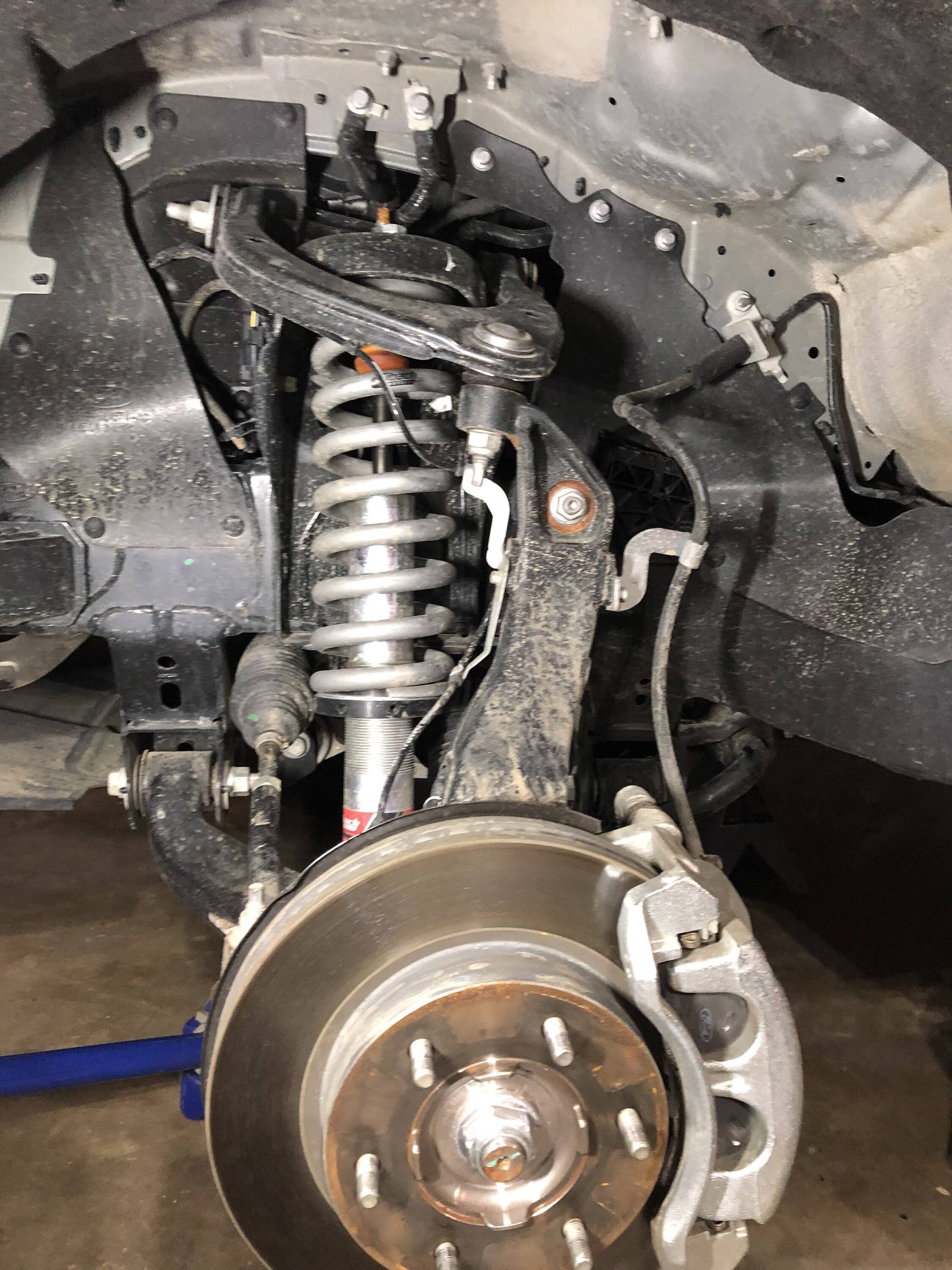

My 22 pops at full lock to the left found this video. I went to my truck and I could see were it the spindle hits the control arm.
